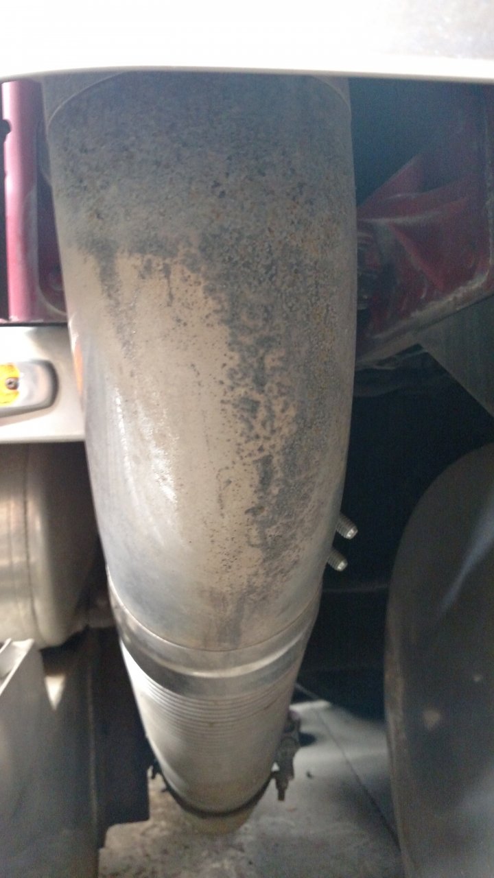

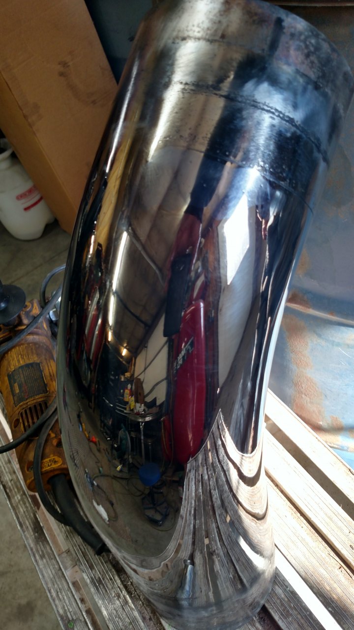

I was working on this last night because it was rusty and pitted from the stack leaking down on it. I used a green bar but it left a haze in some places. Ended up using a blue bar to get rid of it.

This is the other side and similar to what it looked like when I started.

I do the same thing with the buffing wheel and rouge bars. I start with the yellow wheel and green bar, followed by white wheel and white bar. If it still has the rust pits and streaks I use this stuff. Works really good.

If the other one looked like that I'd say you did a great job cleaning it up. Those elbows get all the road grime on there and then baked on. I'm always fighting that and the exhaust streaks and rust that form.1951 ford, Slowpoke KW, jamespmack and 6 others Thank this. -

I used my zip gun with a scotchbright pad where it was pitted then sanded and polished. It cleaned up alot better then I thought it would.1951 ford, blairandgretchen, Slowpoke KW and 6 others Thank this.

I forgot to say if it's rough to the touch I'll use the scotchbright pad and do a little sanding to start with before polishing.
Looks looks your doing it right to me.1951 ford, blairandgretchen, Slowpoke KW and 6 others Thank this.
