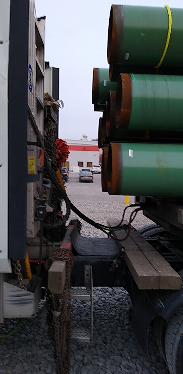

    Ok something like this?
    I'm going to email to my guy so he gets a bit of understanding and perhaps even could suggest to a driver who asks....not likely but I can try lol

    Everytime i ran 60 ft rebar on 53 we used to load 4ft on front and 3 off back and it would scale out just fine. Cant imagine that pipe is much different. How much area do u have for front overhang ?

    That's was at Wilder. It's about 3ft from the trailer to the face of most of my crap.

    U should be good just dont turn to crazy or it might make a bad day out of u !!
