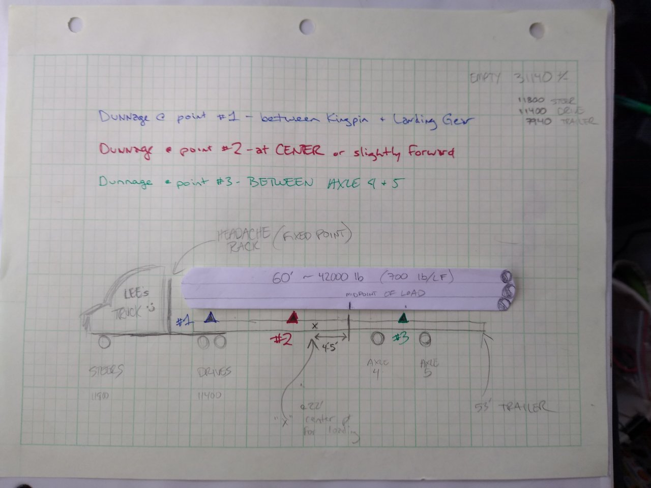

    yup, that’s what I’d go with. Have them place it down, run in and release your brakes and check your drive weight. It might seem like you’re overloading the front but you got so much rear overhang that it’s a starting point anyway.
    You can use more dunnage if you need too but I was always taught to never put dunnage behind the rear mud flap. That weight tends to fall directly on that rear spread axle and that’s how you run into issues.

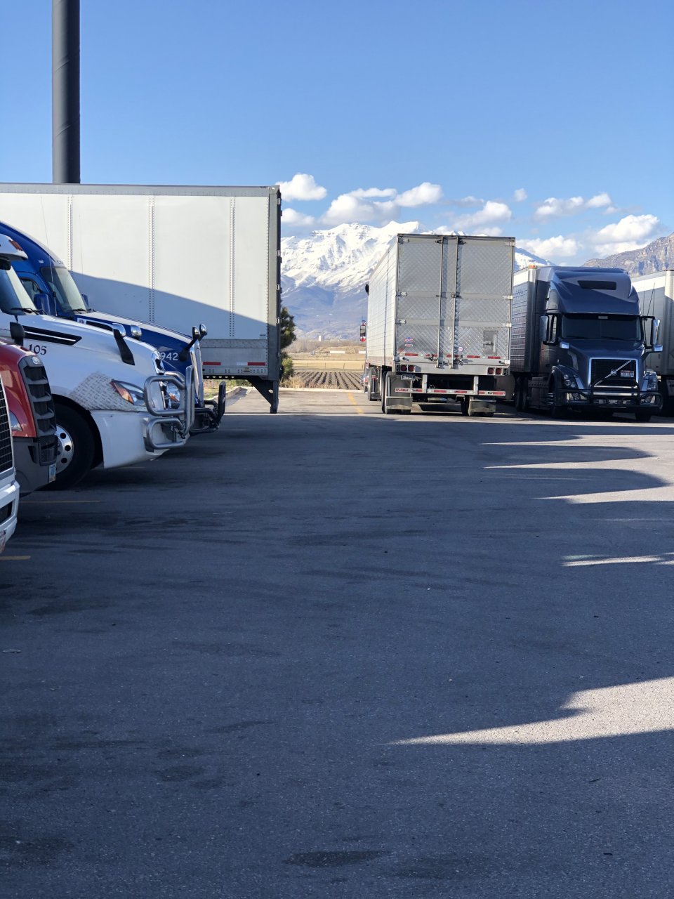

    Made a quick run yesterday from LA up to Vegas this morning. Picked up in Boulder delivering here to Provo tomorrow morning. Then I guess Salt Lake to Casper ( how ever that works out)?
    woke up this morning to pretty good rain shower in Baker through Vegas. Currently 55 and beautiful here in Provo.
    Leaving Los Angles F1E37578-67A9-4FE7-9C1B-C022A1324E67.jpeg Load from Vegas to Provo 8C005039-D5CF-4073-848B-63F33FF84348.jpeg
    And there is 0 parking here at 5 pm, not even the creative spots.
