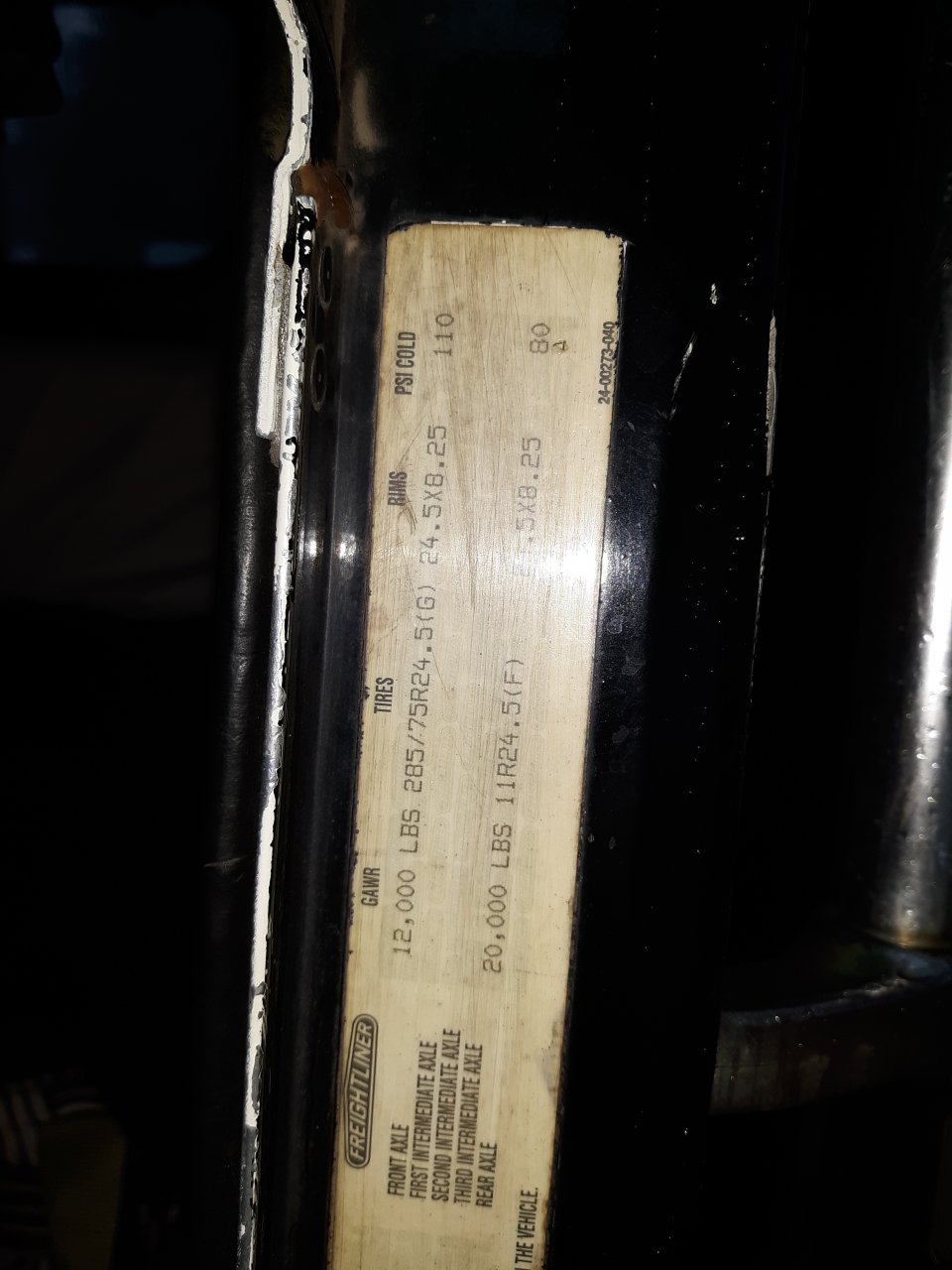

I understand going from tall 22.5-tall 24.5 would effectively change the rear ratio. I can't come out off the line hard as is, I figure taller rubber will only make it worse.. I know what you're saying, it will lose some power, but I'm pretty sure it will still net me a few mph on the top end..?
Would like to be able to cruise around ~74-75mph though..
How much weight gain are we talking here.? Have steel inner wheels now, would be looking for 4 aluminum if I did change size..
For what its worth, the door tag shows it was equipped with lo-pro 24.5 steer & tall 24.5 drive. Don't know how accurate that is, or if it was just a size suggestion..? My end goal was to get them Freightliner directional wheels in 24.5 all around.. Could just stay lo-pro all around, then the overall diameter wouldn't really change, but neither would top end..

You can swap the diff your self with a little help. Easy. Weight wise you would have to calculate that. I could do that later. Best fuel milage will be with lap 22.5 and cheaper tires. Now I more tr than understand that everyone's situation is different. I personally see the only advantage of big rubber in ground clearance if needed. I haul much heavier than you on lap 22.5's on my trailers. That's why the truck will get changed next set. Someplace to finish my steers out. Long game it saves me money.Tug Toy, 1951 ford, Swine hauler and 6 others Thank this. -

Currently with 17.5 rubber on the wagon, I can't get the benefit of one size fits all tires. Make good sense when you can though..
Another problem would be my 5th wheel is already higher than it should be. Tall 24's will only exacerbate it. I trusted the frame shop to spec the 5th wheel pedestal height, but they measured frame height off, now I have 50" 5th wheel instead of the 46-47" I wanted..
