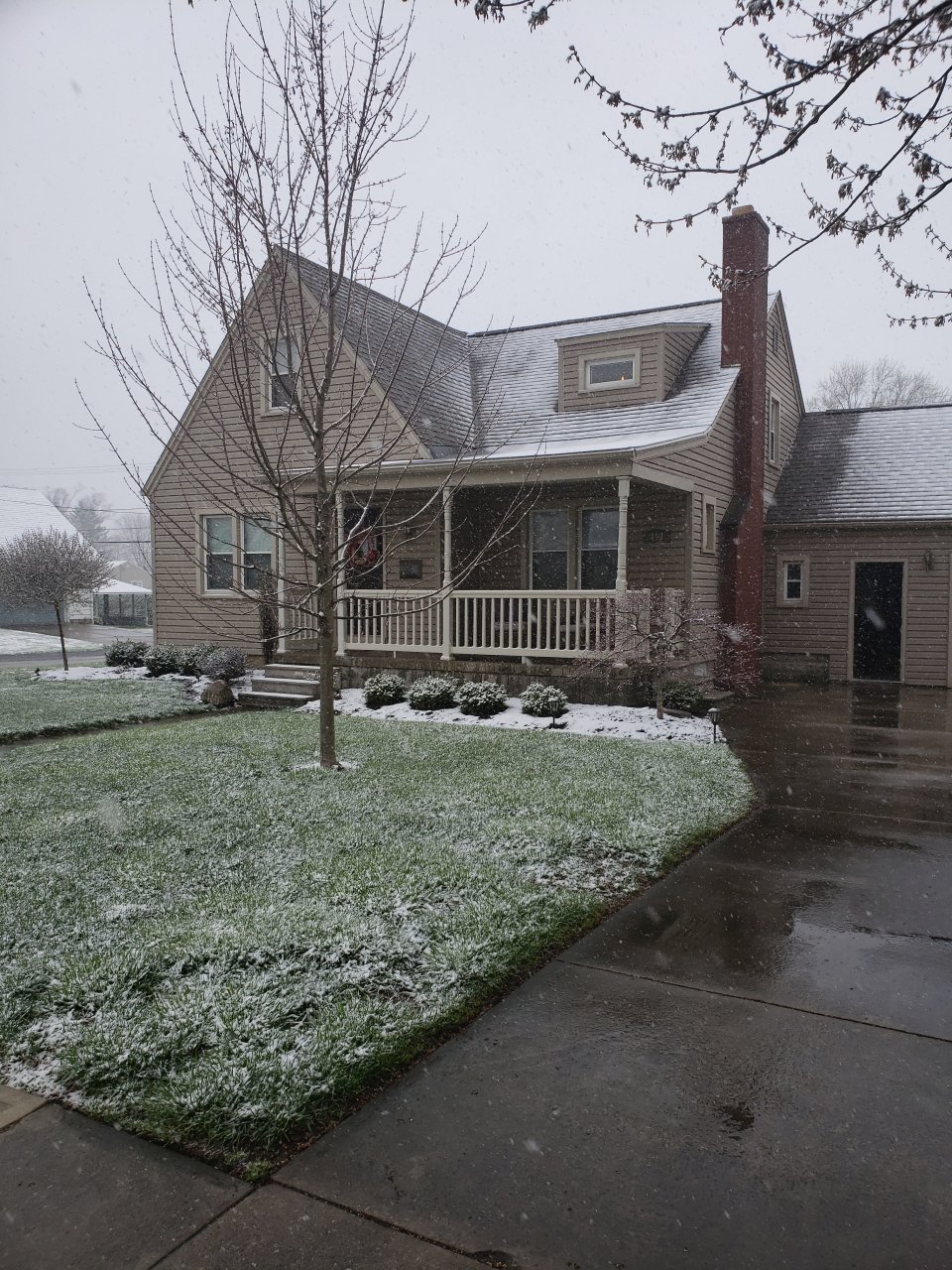

    Woke up this morning and had the same thought. WTF is this?
    My wife says, welcome to spring in Ohio.
