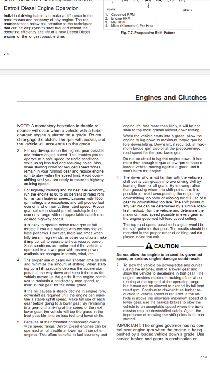

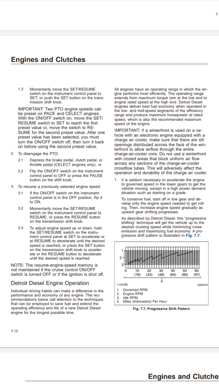

  1. jamespmack
    I run alot of 2 lane over 80k. I run direct, 7lo at 55 in the Buckeye. My oil changes never go past 10k. Uses about 1gal of standard mineral oil between changes ever since over haul. Cover wagon and hopper. My ifta 1st quarter was 6.5. The 2019 4th quarter was 6.37. My yearly on paper is normally around 6.25. The I do my best to limit idle time. Which is fine with the wagon. However creeping to load the hopper and in line to dump its about pointless to shut it down. I have seen 8.5mpg light load with sidekit on.
    I personally dont feel rpm hurts engines as much as applying load to a lower rpm. To me that's were the liner and head gasket , and rod bearings problem come from. If I drop it into 12th .86 od and try to run 55 I think I'm at 1400 and my mpg decreases. On the interstate I stay in 12th loaded, and use 13th for empty and going really fast. I understand some manufacturers will not agree with me. They push this low rpm for economy. But I dont sell engines either.
    This is just my opinion. Not trying to say I'm right.

    That is why to me you operate above rated torque and pull it down to peak torque. Then downshift. Pulling a grade. But accelerating on flat ground you dont need max rpm to up shift. Every engine and gear train combo has its happy range. I drive them all reguardless of brand the same way. Just adjust your values.
    I know Cat have some brutal low rpm torque like no other. But you dont have to pull it down there. Also why guys curse detroit and cummins while trying to pull them down like a cat.
    This is my opinion of pre 03 engines. Think I dont have to type my opinion on 04 and up engines.
