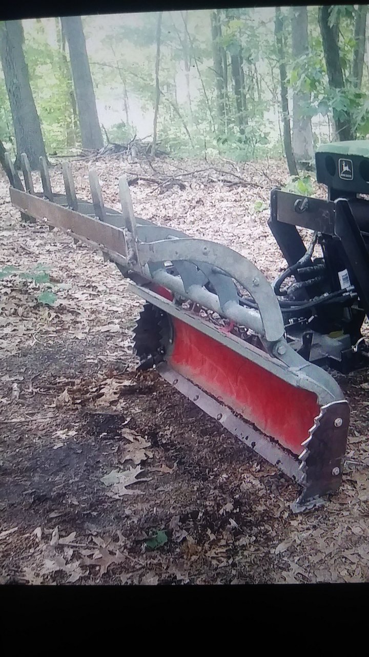

    That blade is more for breaking up gravel to regrade potholes, and for root raking out the briars and sapplings where you want to reclaim the perimeters where early succession forest is stealing lawn or pasture. Say wiring off a goat pen through the woods. You dont want to lose topsoil

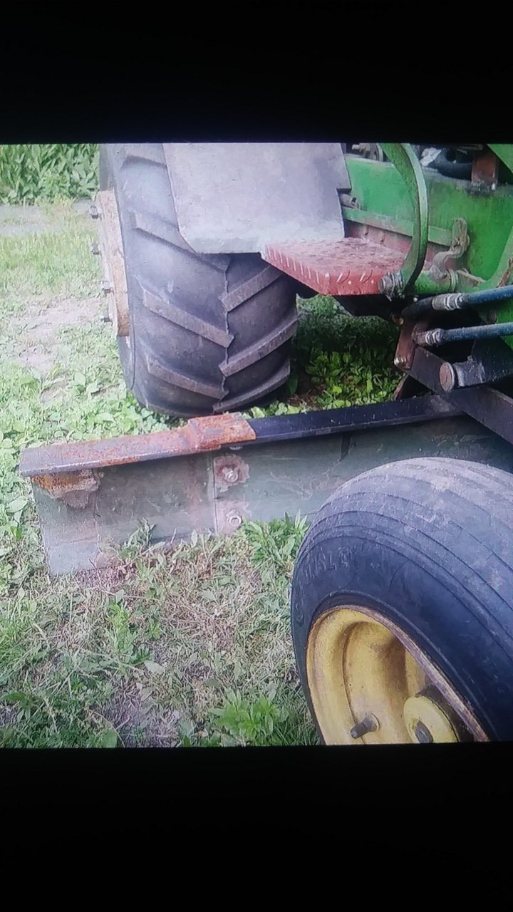

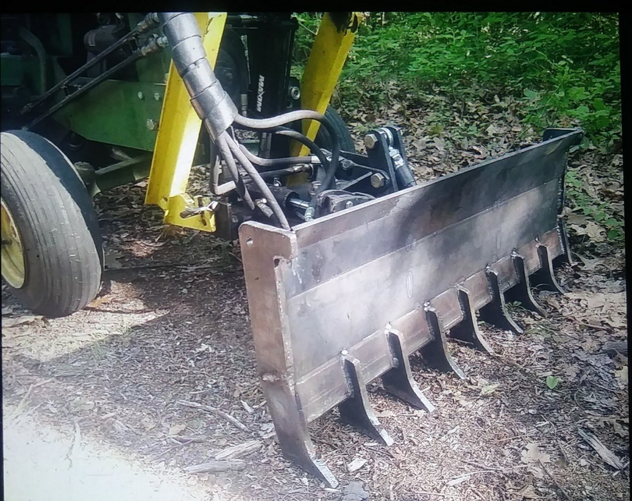

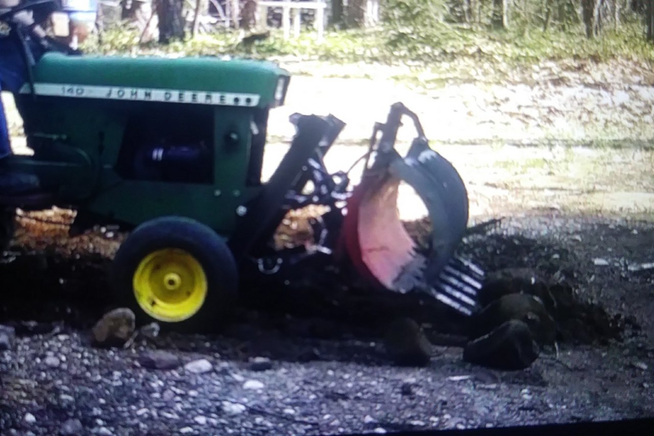

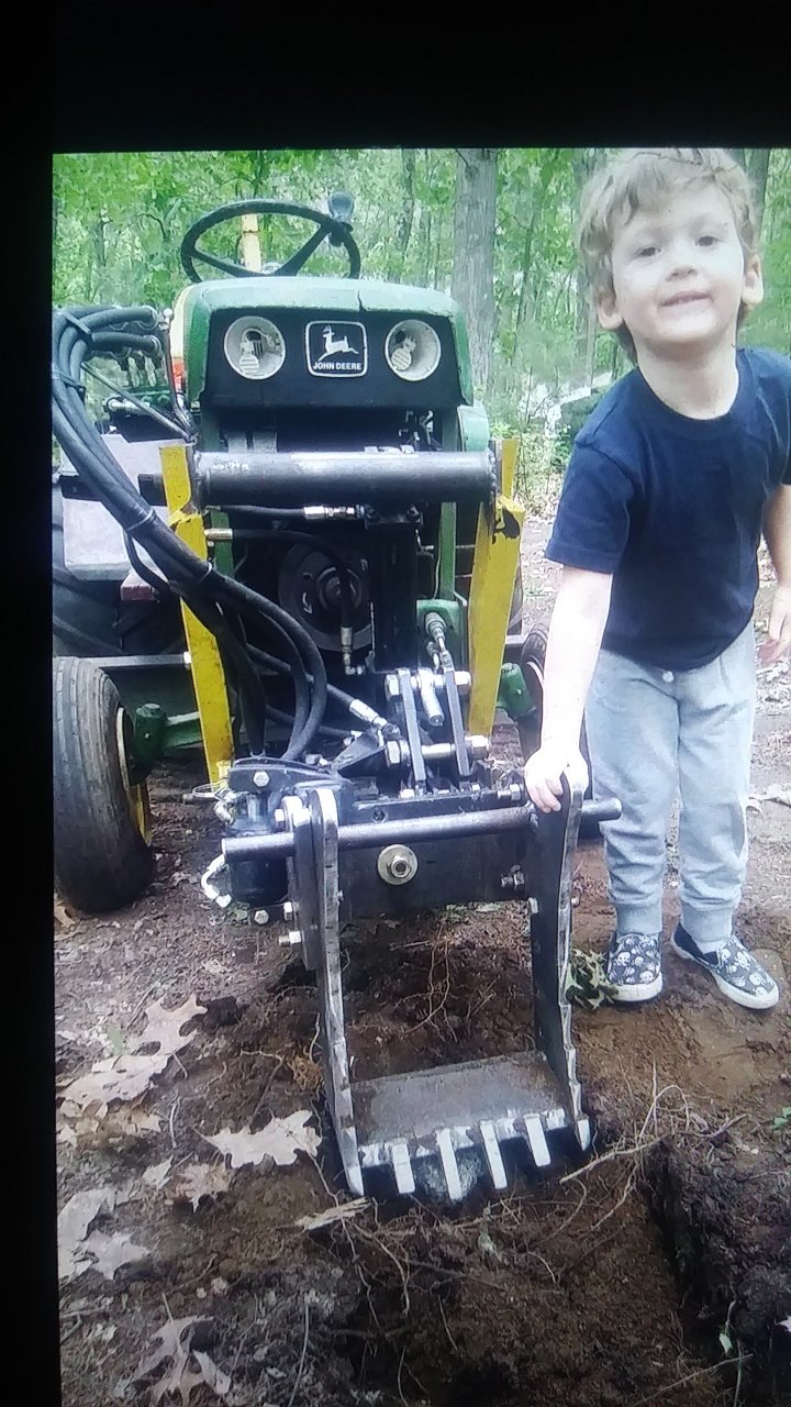

    Heres a grubber blade. I have a bolt in back wall so it can scoop out a trench or just grub a brush clump and leave the dirt behind. All the buckets are universal to the mount with a sorta quick hitch.
    Flail mower
    York Rake
    Roughing and cleanup blade. The grapple has rock tines.

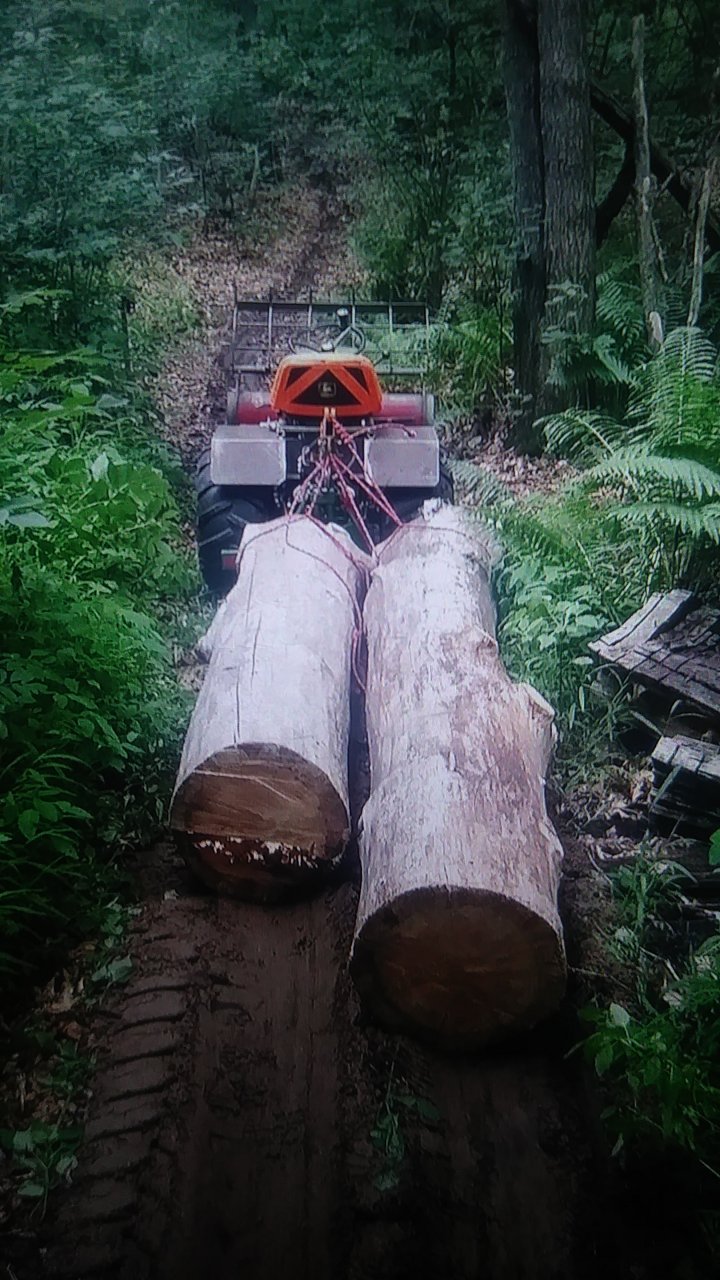

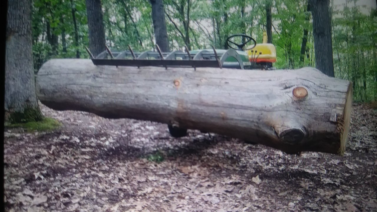

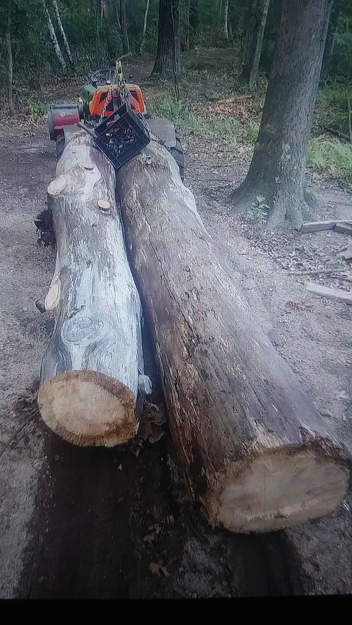

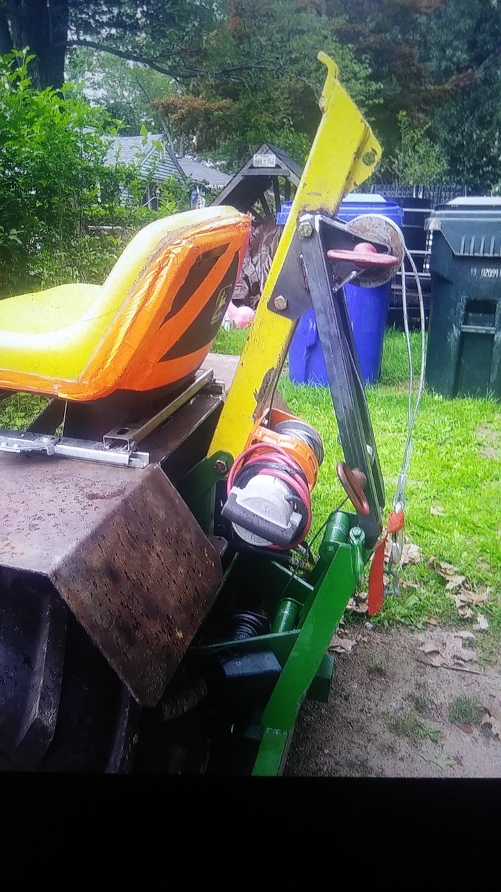

    I started skidding blowdown home for firewood using ropes and that developed into a back end project. Id already done a 3pt hitch and some other stuff then came up with 2 winches and a high pulley to get the butts in the air and load the drives. it can skid these on decent ground or slight climbs if the grapple is full of hardwood. One at a time itll do easy.

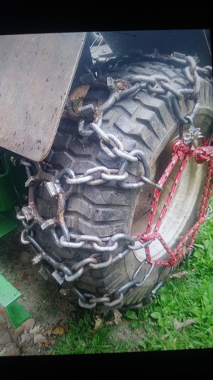

    Then i just had to build ring chains. They were a disappointment in dry ground in massachusetts but ridiculous in snow. Havent tried them in TN clay but i think theyd work well.

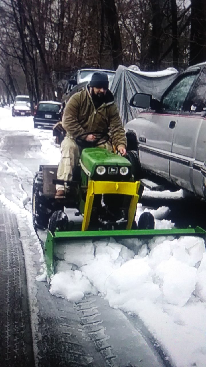

    Did wings to make a box blade since it could always push waaay more than a little blade could hold. My buddy playing.

    Theyre just a clone of skidder chains. Made simple jigs for the pieces and heated round stock to form them then just sewed em up miller style. An ironworker helps alot. Tedious job, wasnt worth it other than bragging rights maybe.
