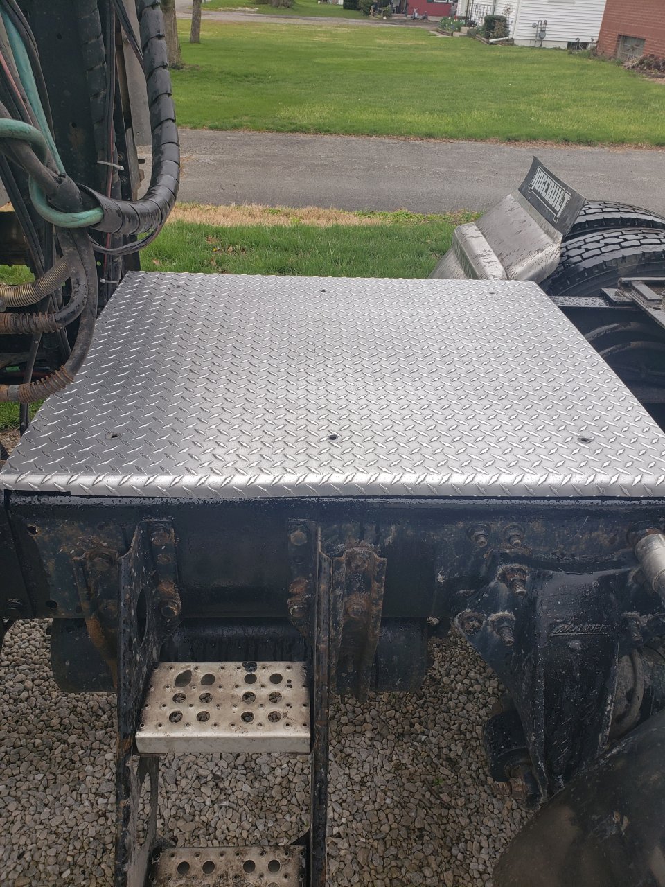

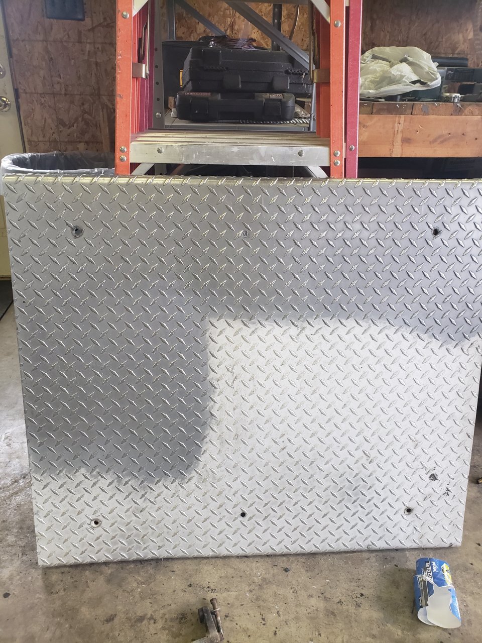

    Now this is no @Tug Toy @Hurricane69 @Isafarmboy or @SAR polish job. But for 0000 steel wool and some cheap polish I dont recall buying it's ok. Not a big thing but saved this from Pop's stuff. I think it was on a new 84 Pete he bough salvaged. As far as I recall it has been on every truck he had since. I can not imagine the times I used it as a work bench, lunch table or had to polish it. I could buy a new one. But we are gonna put it on ruff and all.

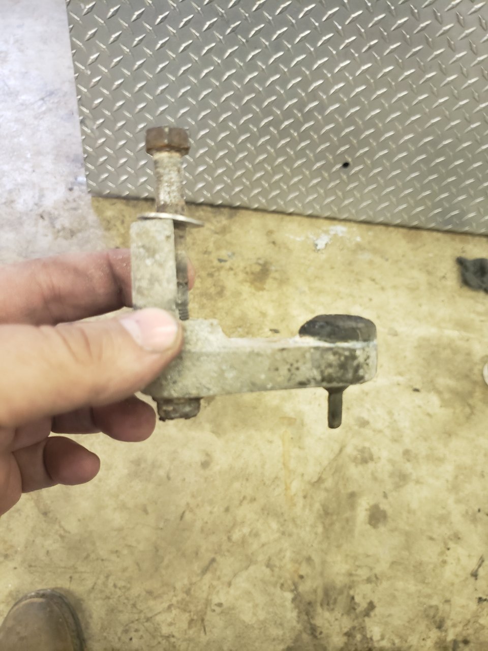

    Anyone know where you can get these mounts besides Pete? They want 43 bucks a piece.

    What about a piece of flatbar at each corner? Sandwich the top flange between the deck plate and the flatbar.

    Or just 1 long piece of flatbar running from rail to rail at all 3 sets of holes so they can't spin out?

    That's pretty much exactly how mine is on. It hasn't budged in 5 years.
