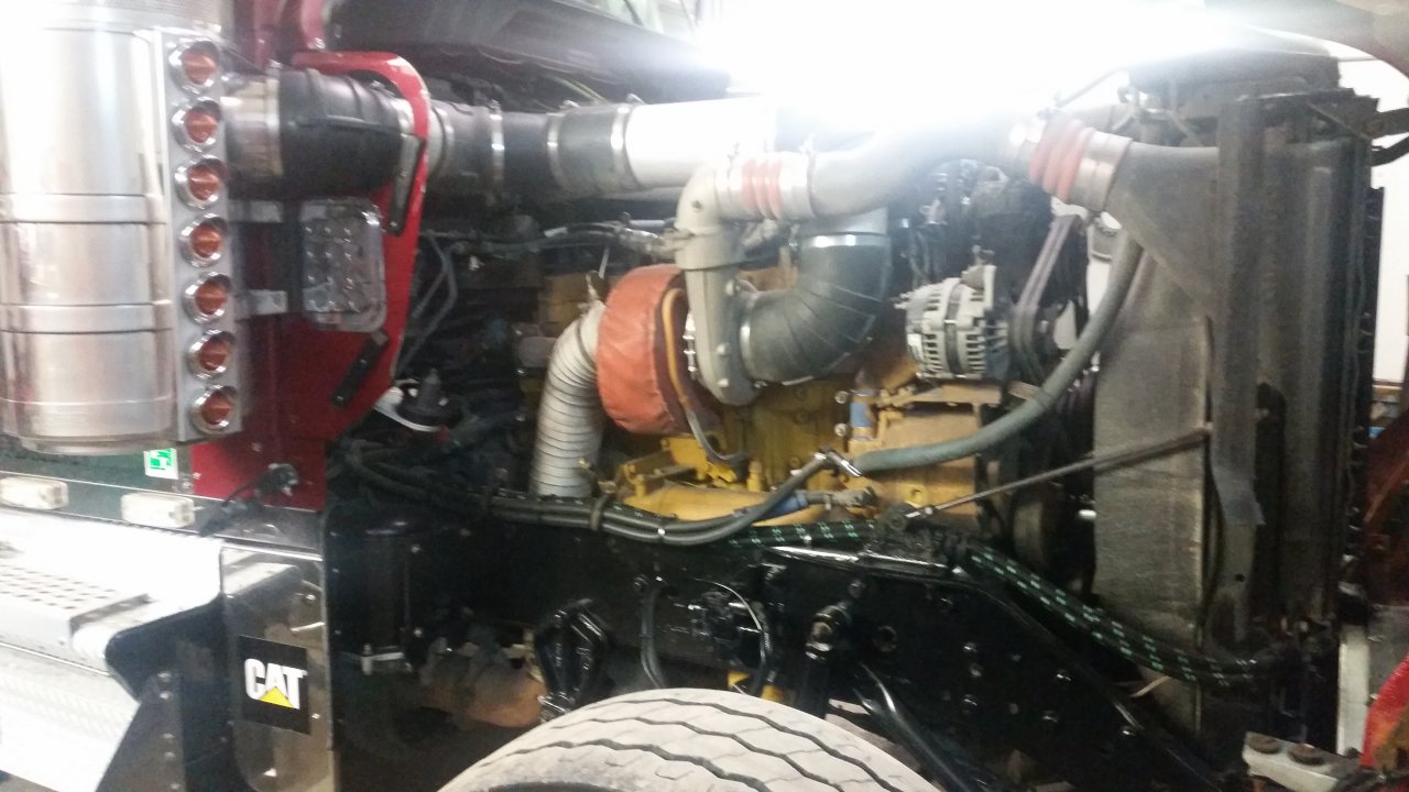

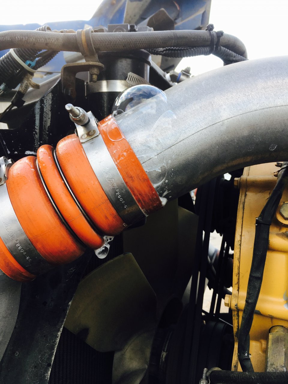

So I took our T-600 today to grab the last load of bowling equipment. On the way down and back I heard a whooshing sound every time I accelerated. Drove me nuts.
Get home and grab the dawn dish soap and found bad cac boots. 3 had holes in them and one needed the clamp tightened. I don't usually drive this truck often but glad I caught this. I had 3 new ones in the shop so I installed them. It should run better now.![]()

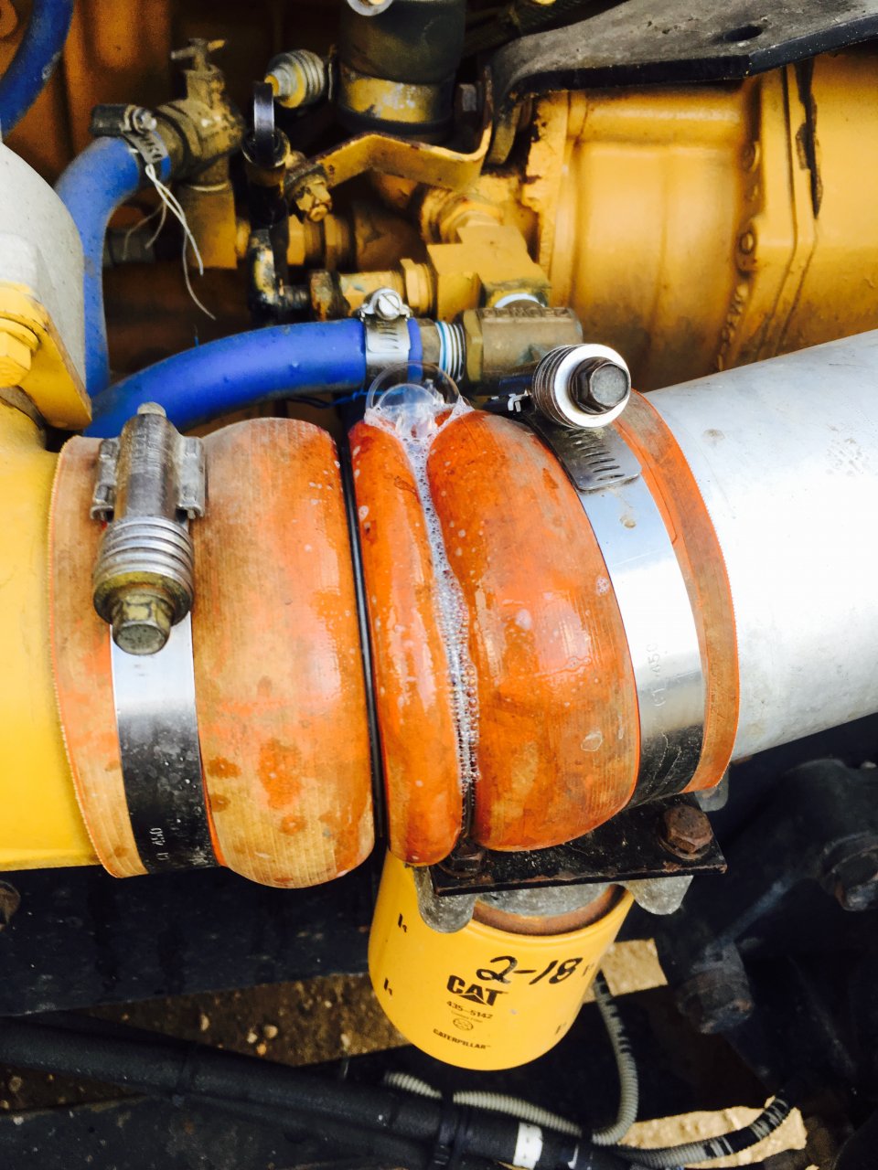

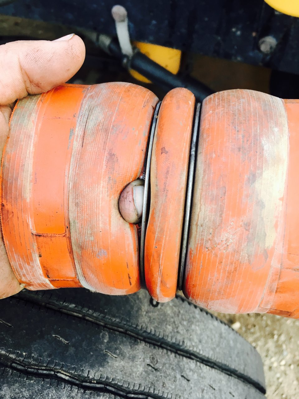

You ever blowed one???
Gets you attention real fast.PoleCrusher, 1951 ford, singlescrewshaker and 6 others Thank this. -
Never have but I heard it's loud when it happens. I guessing these would of popped in the near future.Swine hauler, PoleCrusher, 1951 ford and 6 others Thank this.

I've lost a clamp but the boot was intact.... I carry extra clamps now but need to get a extra boot.PoleCrusher, 1951 ford, singlescrewshaker and 5 others Thank this.
I thought the only T6 you had was a dump truck.....my memory ain't so good.PoleCrusher, 1951 ford, singlescrewshaker and 6 others Thank this.
I've never lost a clamp but carry an extra one in the truck. I think @Superhauler doubles his clamps up but he's pushing a lot of ponys.PoleCrusher, 1951 ford, singlescrewshaker and 6 others Thank this.
We have 2 T-600's and the dump truck is a T-800. All trucks have yellow engines.PoleCrusher, 1951 ford, singlescrewshaker and 8 others Thank this.
Yep, double clamps, extra clamps, extra boots. Haven't blown one in a long time.....now I've jinxed myself !
