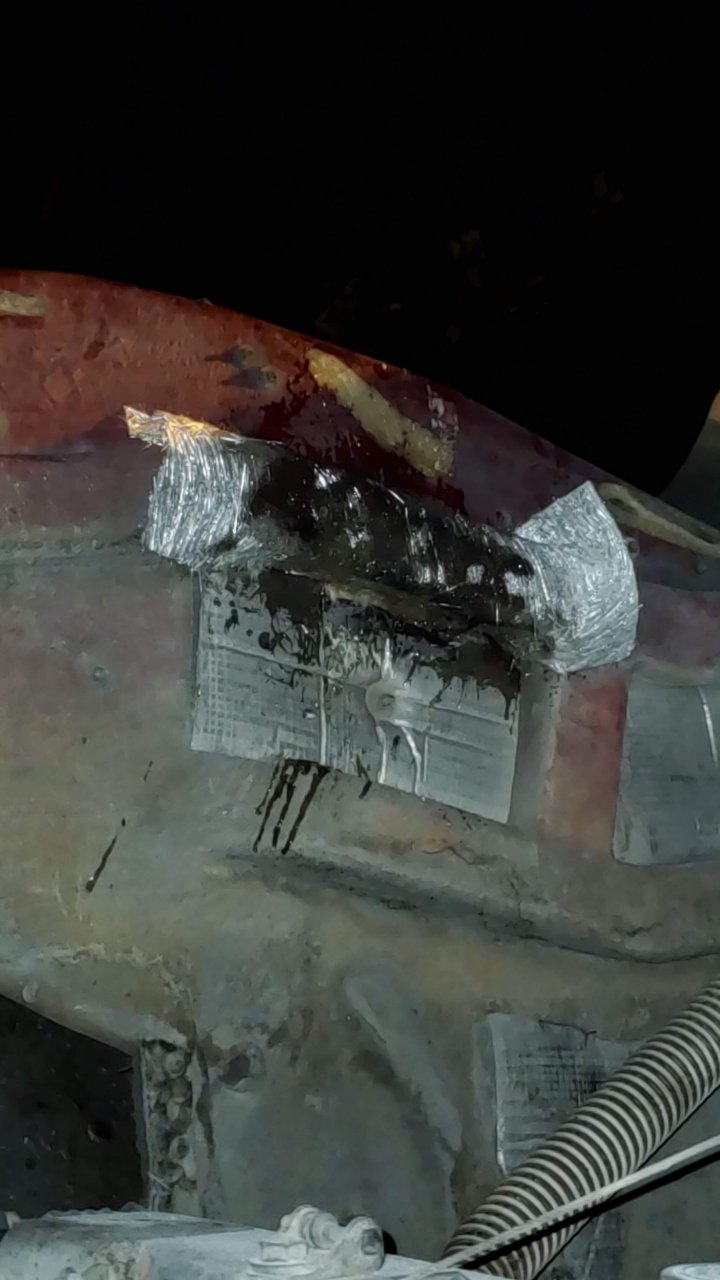

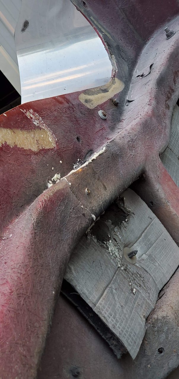

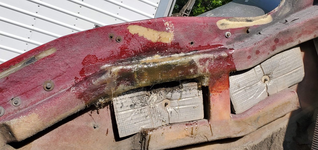

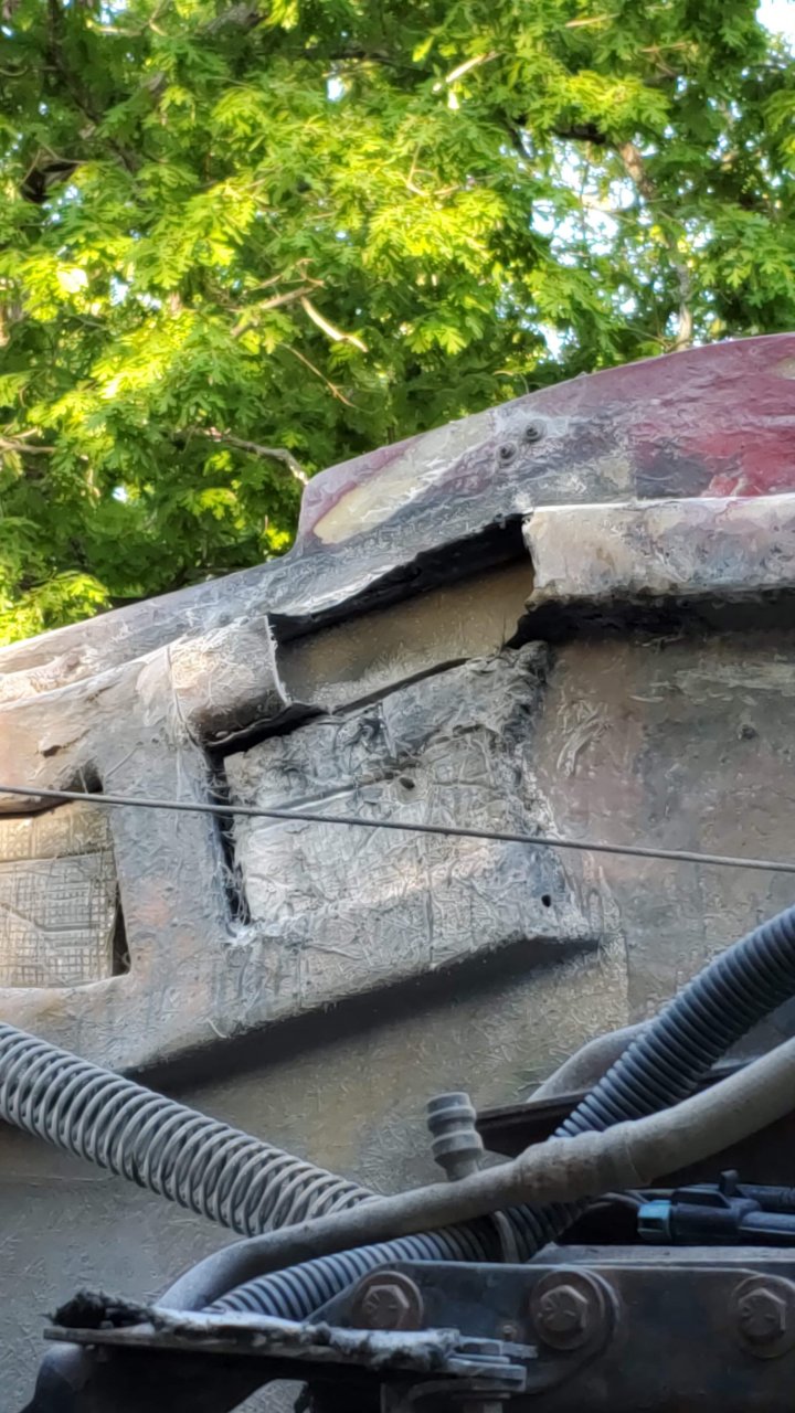

    The other project I had this weekend.

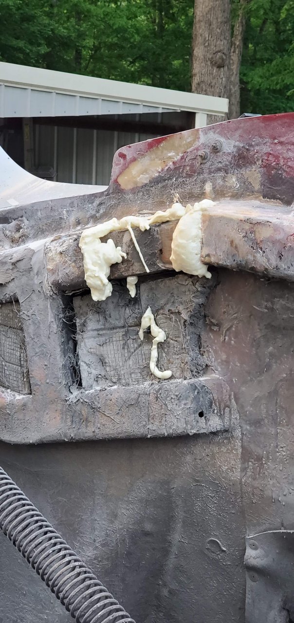

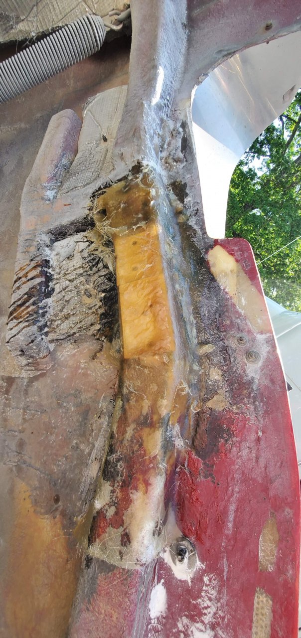

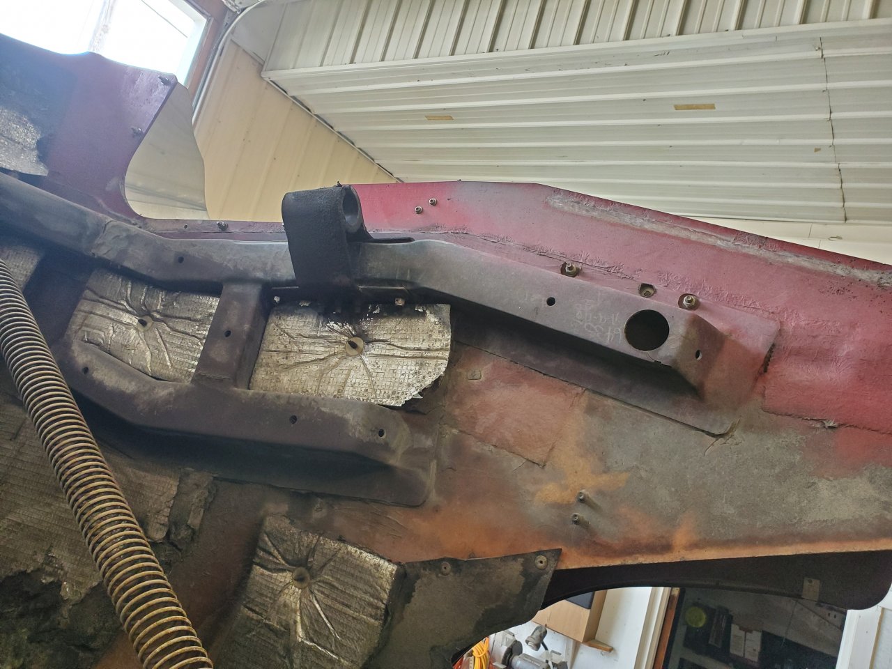

    Fixed the hood on my buddies w900. Is it the right way? Prolly not but its better that the nothing that it had before.
    #### thing had a 2x4 under the pin to raise it enough to touch the hood. Took that out and put it where it belongs and rebuilt the hood structure and put the brackets on lower so the adjustments are actually usable. received_2547109592270449.jpeg received_655866135235695.jpeg received_604417763495386.jpeg received_330672791241985.jpeg received_2645129659146174.jpeg received_657268638171634.jpeg

    This is how I did mine....it wasn't as bad as yours. Hope you put the wood back in ! 20200503_165803.jpg

    Oh yeah. The wood under the pin between the cab part and the rubber pin we left out. Left the wood in the hood part. We were going to just foam it on each end and fill it full of resin and mat but decided to use wood inside the hole to take up space and then fiberglass over that.

    That's what I meant, the wood inside the hood rib.

    The T800's in the bush have a nasty habit of the 1/4 fenders wearing thru the hood fenders. Seemed like every spring you'd have to fiberglass the hood fenders. I think we even fiberglassed a piece of wide 1/8" thick flatbar into one guy's hood fenders.
