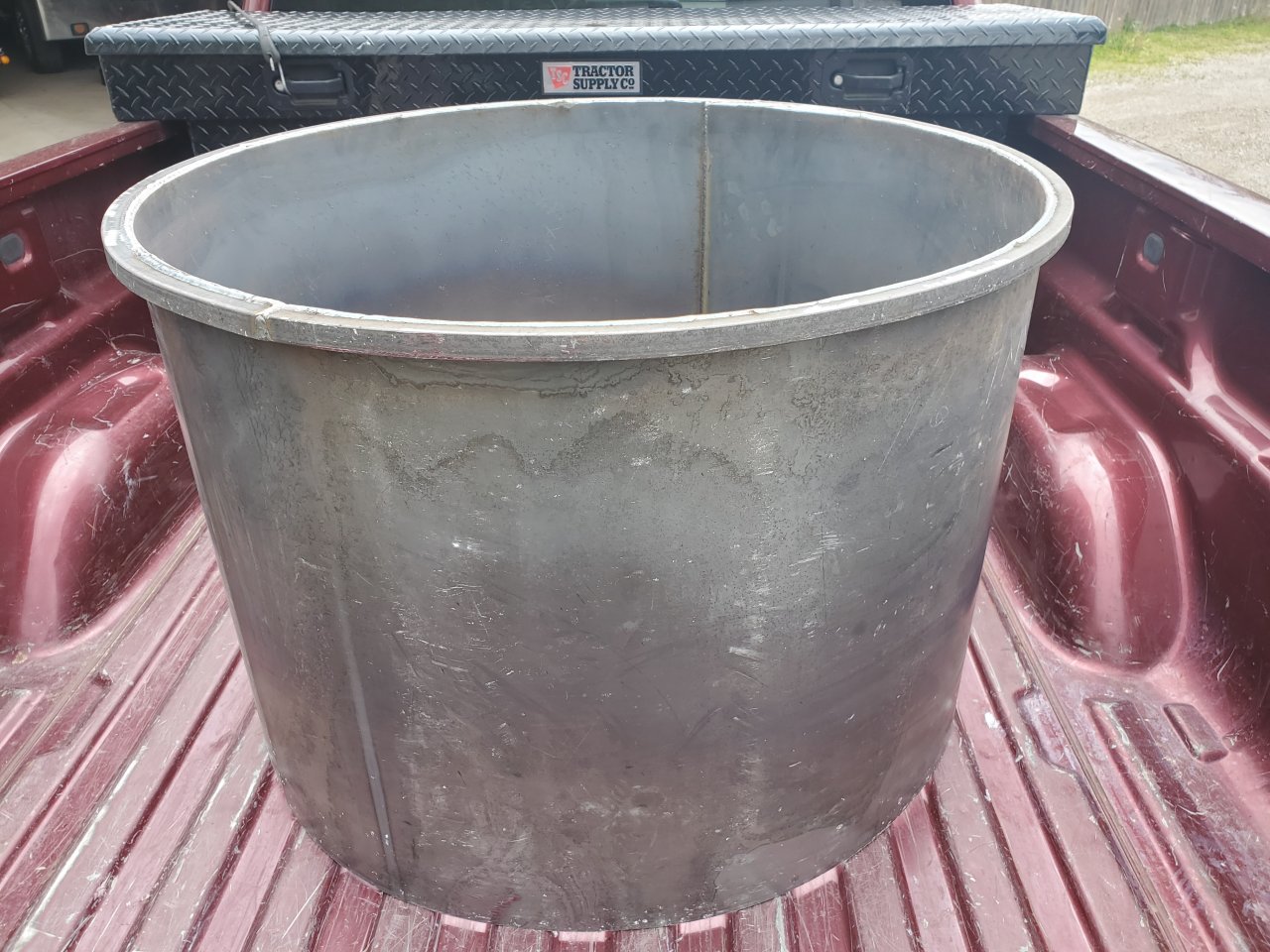

    Just got back from my buddies fab shop. 3/16 with a 3/4 bar stock welded to the lip 36 dia. ×24 deep. ...should make a fairly decent fire pit ?? 20200506_121141.jpg

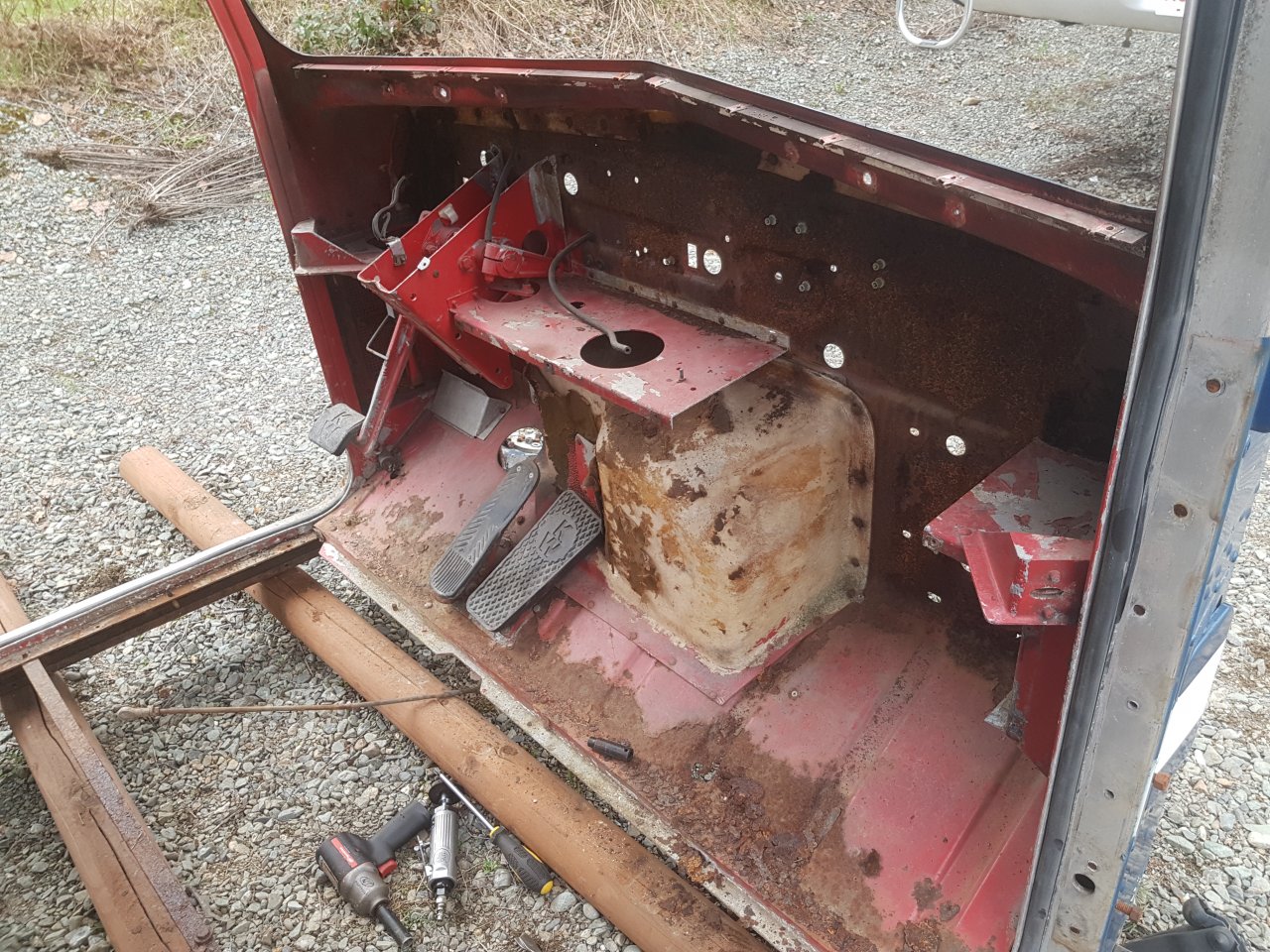

    Any of you fine folks know of a good way to remove these old huck rivets on the KW cabs? Looking at my cab, thinking I may just replace the entire firewall and floor plate. She purty rusted up and thin under the cowl area. Thinking I might just go with a single flat steel panel and bend it to match the original.

    I take my angle grinder with a cutting disc and die grinder with an arbor/cutting disc and cut halfway through the Huck side and then use my air hammer and chisel to knock it off. Then I use a punch in my air hammer to punch them out. It can definitely take some time to do.
    Can you take a picture of the rivets for me?

    They're the little baby hucks KW and Pete put their cabs together with. Probably about 3/16" or 1/4" steel shank on them. I'll get some pics when I go out there later today.
    Probably gonna have to grind them off. Seems like a ton of work but I guess it'd be cheaper than paying the bodyshop $180/hour to do it lol.

    I know exactly which ones you're talking about. If you can access the head of each one, cut an X-pattern in the hear and use a chisel on your air hammer and knock that head off and and then punch it out.

    Oh access is VERY easy:
