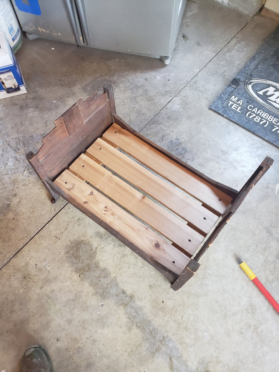

    Sun is out, back to polishing. Had a emergency job come into the shop. Customer stated the bottom fell out when jumping on antique doll bed. Didnt understand that it was only for dolls. But customer is always right. She kinda haggled me on price. But we stiffened it up.
  10. cke
    cke Road Train Member
    6,341
    78,098
    Aug 4, 2013
    Colfax Wi
    Another satisfied customer ??

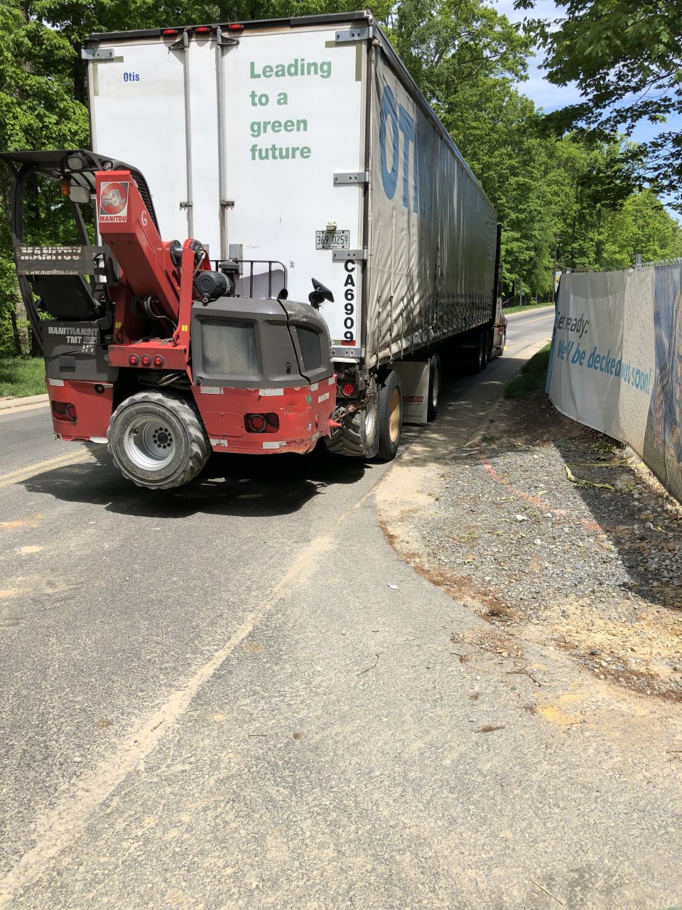

    So this happened yesterday after I unloaded the Reynolds Scraper. It was super windy in King City, CA with the winds steady at 30mph and gusting to 45mph. I had the windows down while I was finishing up my paperwork and I hear what sounds like metal dragging the ground. I looked down to complete my Bill of Lading and the sound gets closer and louder but I couldn't identify exactly what it was coming from. I'm looking around to find the sound and I see this friggin' trailer rolling towards the nose of my truck. The metal dragging the ground was the dolly/hitch scraping the pavement because the high winds were pushing this trailer. The ranch hands or truck drivers didn't chock the wheels and here it comes directly at me.
    I bailed out of the driver seat and started looking for something to stop this rolling trailer and I found a piece of square tubing. I ran to the trailer and dropped the tubing behind the rear tires and it stopped until the darn dolly turned and the dollys wheels kept rolling. The trailer finally stopped after turning sideways with the square tubing behind the tires.
    When I took this picture I was standing in front of the grille of my Pete. I had to check my fundies after it stopped rolling. IMG_20200512_185244.jpg
    This was the square tubing I found laying against the building.
