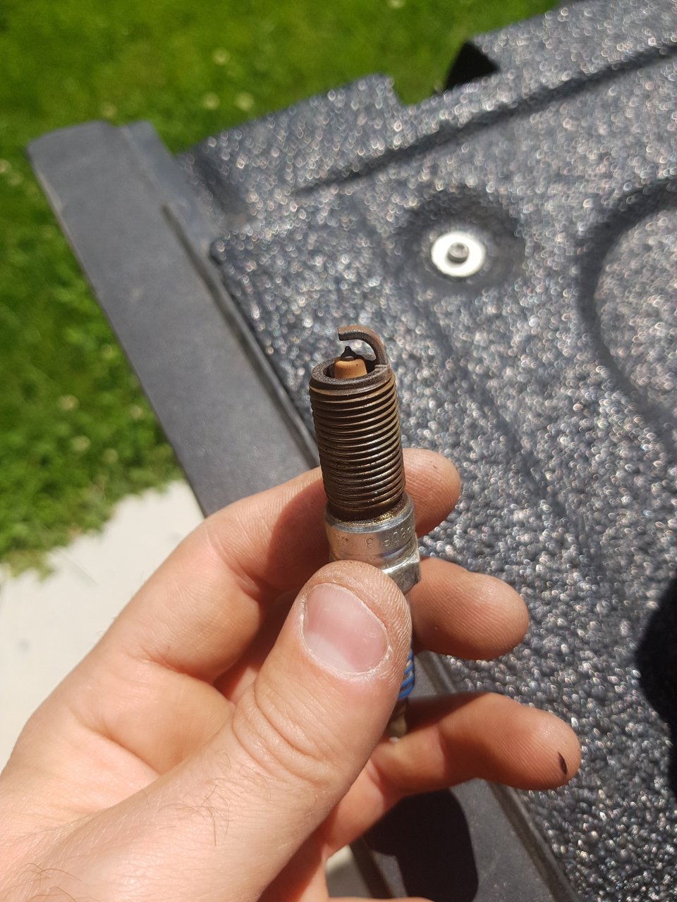

    All left bank injectors ohm out at 12 just like the right side. Pulled the suspected #6 plug. Don't have my feeler gauges but can just about slip a 1.5 mm allen key thru the gap so that'd put it at about 0.050" gap. Doesn't look fouled or anything. Gap does seem a bit on the excessive side though. Not sure what the factory specs are on these plugs. Seeing 0.035" on early 5.0L and after 2012 they seem to spec them at 0.045". This is according to Google search so I hesitate to take that as Gospel.
    #6 plug:

    All 4 plugs on the left side look the same. Gaps seem relatively close. No evidence of carbon tracking on the plugs either. Crawled under and checked the manifold studs, manifold and collector joint. I can see about 6 out of 8 studs and they look good. They look to be 10 mm studs too so maybe Ford updated their manifolds? The noise definitely seems to come from the front left corner, valve cover area. Don't wanna say it but this might mean exactly what I don't want it to mean - cam phaser #### the bed :(

    Probably not bad just getting noisy, its keeping it in time like the computer wants so its not gone yet.
