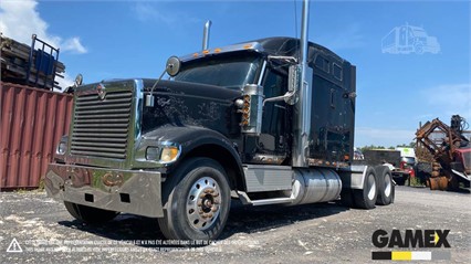

    If that truck came out of Canada, make sure the truck is IN the US, has a US title, and the FET was paid before you send them any money if you move forward on it. If these are the guys that Im thinking of, they buy trucks in Canada, post them for sale cheap on truckpaper and the truck is still located in canada. They forget to tell you that part.

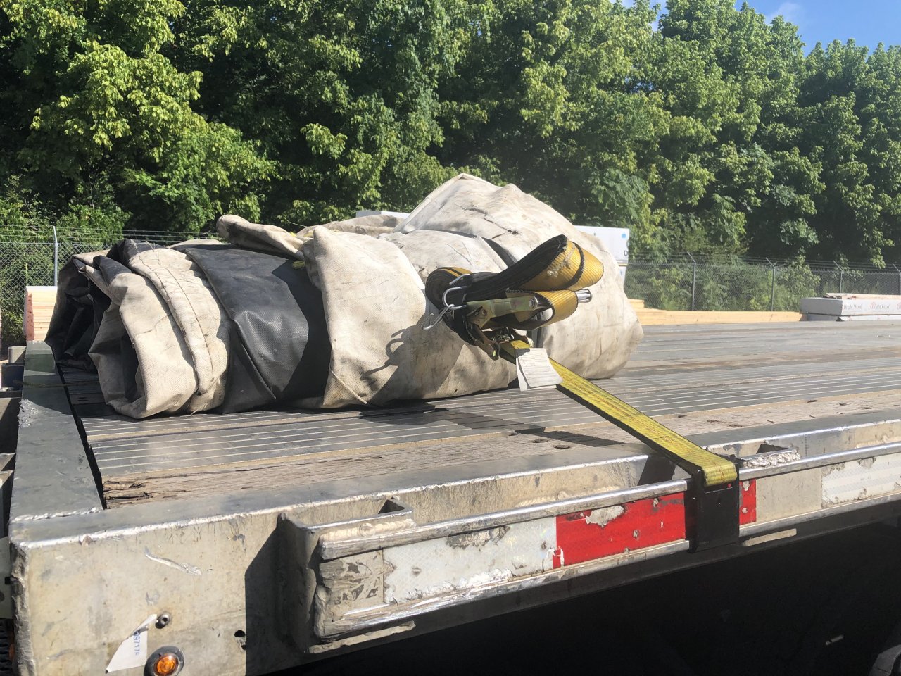

    When you fold your ends of the tarp to the center leave at 3 to 4 inch Gap in the center, then when you fold it in half on your last fold it will make the tarp fold flatter. Then fold back to front about 3/4 of the way up. When you roll it make sure you roll it nice and tight
