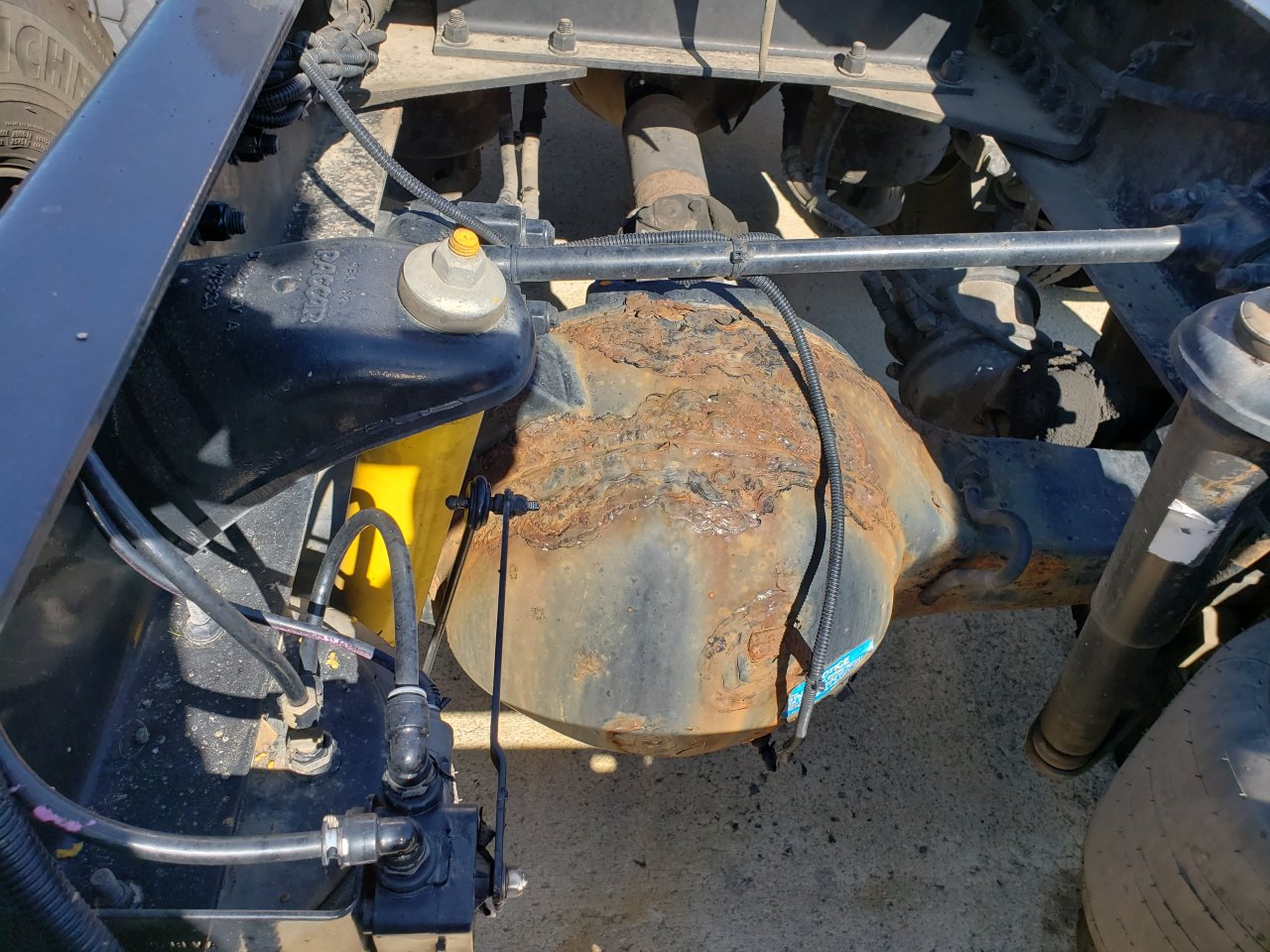

Okay, you don't think thats from the differential getting too hot then?
I've never seen paint do that so fast.cke, farmerjohn64, 650cat425 and 3 others Thank this. -

my front gets close to 270 in the summer. Rear will get close to 220.
Freight liner says it’s normal.

Funny thing is in every bit of service literature and training I've taken I've been told that once oil hits 250° F, damage is occuring. Apparently at that temperature the oil film has broken down and is inadequate in preventing metal on metal contact. Happens too long and you start to see metal transfer (smearing) as the metal at the small points of contact become hot enough to momentarily weld together.NightWind, Flint1, PoleCrusher and 10 others Thank this.

Freightliner won’t do any sort of replacement despite our #####ing
And I made a big event of it in Arlington one day. Nothing. I guess 270 degree diff temps and hot hot hot hot tires is the new normal. To hell with it.PoleCrusher, cke, shawnhhllc and 6 others Thank this.
