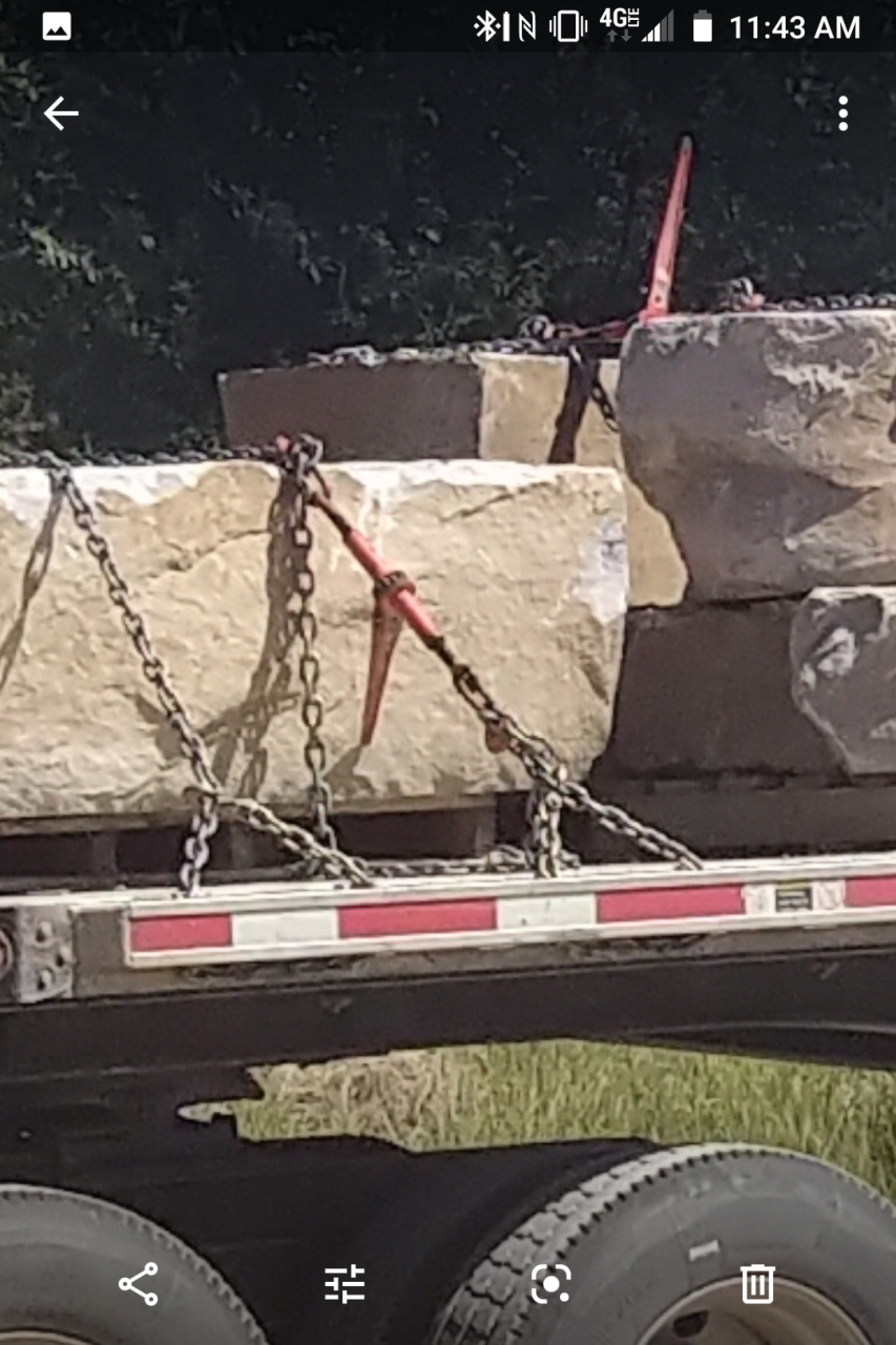

    I put the hook on the binder in front like you said, should’ve known that, but I’m still having trouble lol trying to figure out what to do with the slack like @D.Tibbitt said; hope western doesn’t mind if I take all day almost

    Where is ur slack at ? Once u get the chain tight. Take the slack and wrap it around the bottom of the hook/binder and bungee it up to keep it neat

    Get ur hook tight to the rub rail. Grab 3 chains lengths or so past ur chain hook and attach ur binder hook there. Then pull the chain as tight as u can and attach ur top binder hook as far up as u can get it.. U should have the extra slack on ur deck by that point

    Once the chain is tight, I just find some place to tuck the excess, or hang it where it won't come off. If you can't do that, wrap it around the bottom and bungee it.

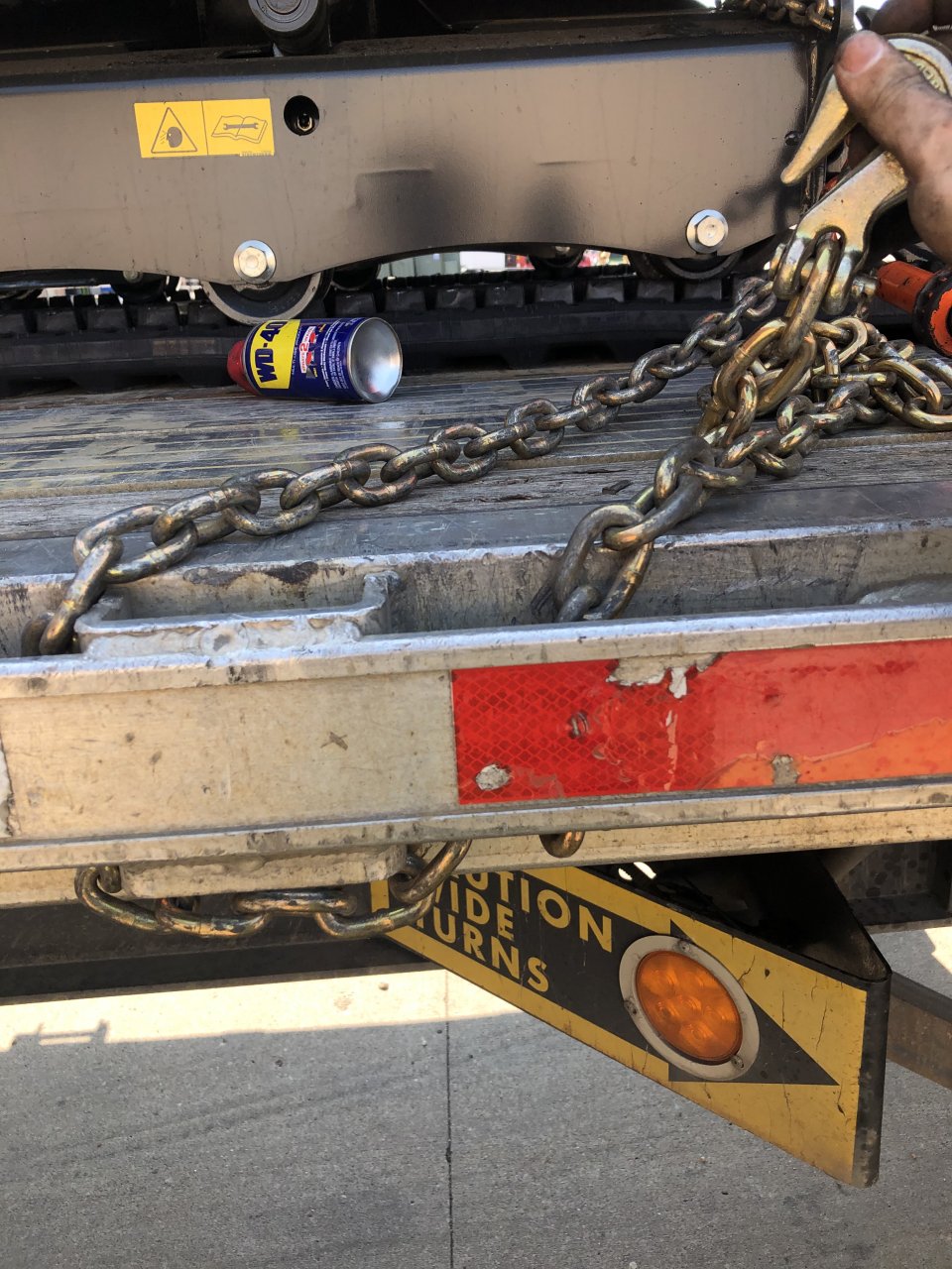

    Yes attach the hook like where the red mark is .
    Pull it tight . Once its hooked grab like 3 chains length above the hook and attach binder there... pull all excess from other side and attach the other end of binder as far up as u can go then tighten
