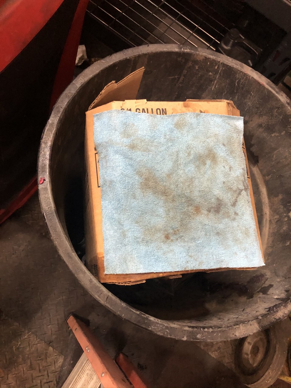

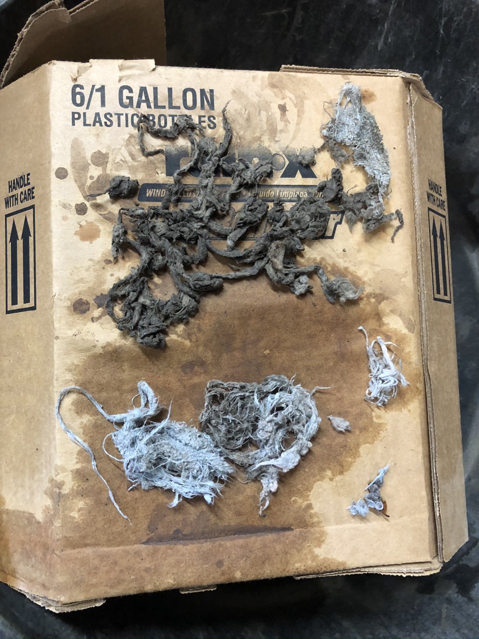

    Lots of DIY guys in here. Just figured I'd put this out - when you pull your radiator, don't put a rag over the lower coolant tube or say, perhaps stuff a blue microfiber towel in it to keep stuff from falling in. Put a hard plastic plug in it.
    I'm still disassembling, back flushing, and fishing.

  8. MACK E-6
    50,214
    240,297
    Left it in there and the water pump tore it up?

  10. Nostalgic
    Nostalgic Road Train Member
    1,815
    20,015
    Mar 6, 2017
    PA
    Did better than any garbage disposer I've ever owned. The coolant filter did an outstanding job - I recovered the dark stuff all from the filter pleats. While it's possible it's been in there for 50k miles, I'm leaning towards the ~12k miles since I last had the radiator out...

  11. Superhauler
    Superhauler TEACHER OF MEN
    12,209
    100,735
    Jan 30, 2010
    keep stroking.
    Buddy of mine did that with those red shop rags in the exhaust ports. He missed one. Turbo did a great job of eating it up right before it bent every blade on the wheel !! I usually slip a rag over a tube and slip a hose clamp on it to hold it. Or zip tie it.
