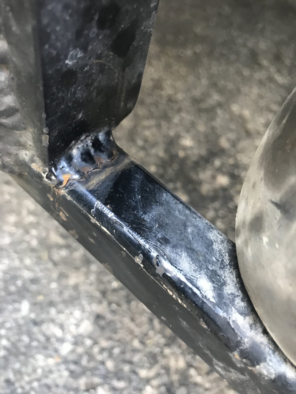

    Looking at the radius on the edge of the square tube, it appears to be thin wall tubing, 1/8" perhaps? If it is thin wall tubing, a gusset will help where it's broken now, but you will lose support where it ends. In other words, you moved the cracking point further out.
    Just a suggestion, I would weld a vertical 1/4" x 1" (or up to 1 1/2") piece of flat bar to the underside of the tube as a stiffener. Depending on the length, an 1 1/2" weld on both sides on a 4" center should be adequate, or the size and spacing can be adjusted accordingly. Too much weld will cause it to bend.
    45* cut the ends for cosmetic reasons and to eliminate a sharp corner.
