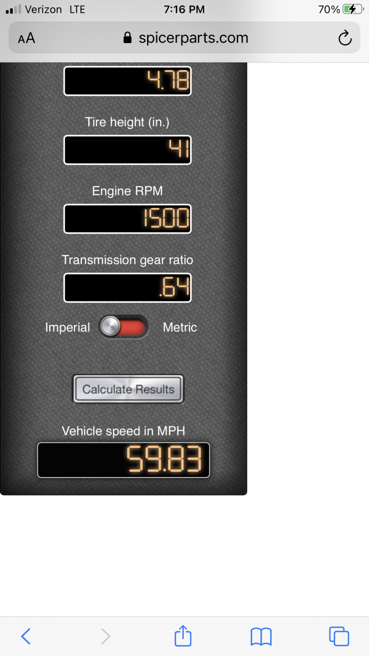

the Allison in 7th gear is 0.63 - so that allowed me to go very deep in the gears but the auxiliary will allow me big roads speed empty in the overdrive gear.
I drive slow as everyone knows - so pulling is most important for me
it will be a learning curve but I think it the best solution to what I am looking to do

the super low first and the super low reverse gears must be locked in from a stop but they seemed very usable today
plus I can go to either of 2 underdrives in the auxiliary trans
should be able to get going on the very steep grades even heavy (for me)
that is why I went to the Allison - plus now I won’t miss any shifts - mostlysinglescrewshaker, 650cat425, PoleCrusher and 7 others Thank this. -

so I was unclear on the process when I ordered it but was told it worked.
so here is how I did it today - set the range in the auxiliary then put the main in D (yes that sounds retarded even to me) then take off
to change ranges - pre-select the range (up or down) - then let off the accelerator and the aux will change ranges just as it with my 18spd in front of the auxiliary.
don’t let the main box change gears when doing the range change (it won’t find a range and you will have to stop)
I will likely lock the gear before changing ranges when loaded but bobtail the above workedsinglescrewshaker, 650cat425, PoleCrusher and 9 others Thank this. -
looking goodsinglescrewshaker, 650cat425, PoleCrusher and 6 others Thank this.
run that again after multiplying the 0.64 by 0.74 (the overdrive in aux) and check the road speed....if you are so inclinedsinglescrewshaker, 650cat425, PoleCrusher and 6 others Thank this.

I’ll have to dig deeper to calculate the double OD?singlescrewshaker, 650cat425, PoleCrusher and 5 others Thank this. -
