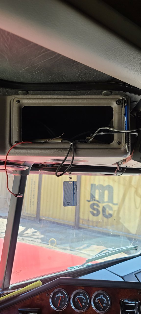

I recon a nice piece of textured black plastic would look good covering that hole up, put a scan gauge on there and maybe a spare switch or two. Have the cb mounted below it hanging there like it is in a pete
