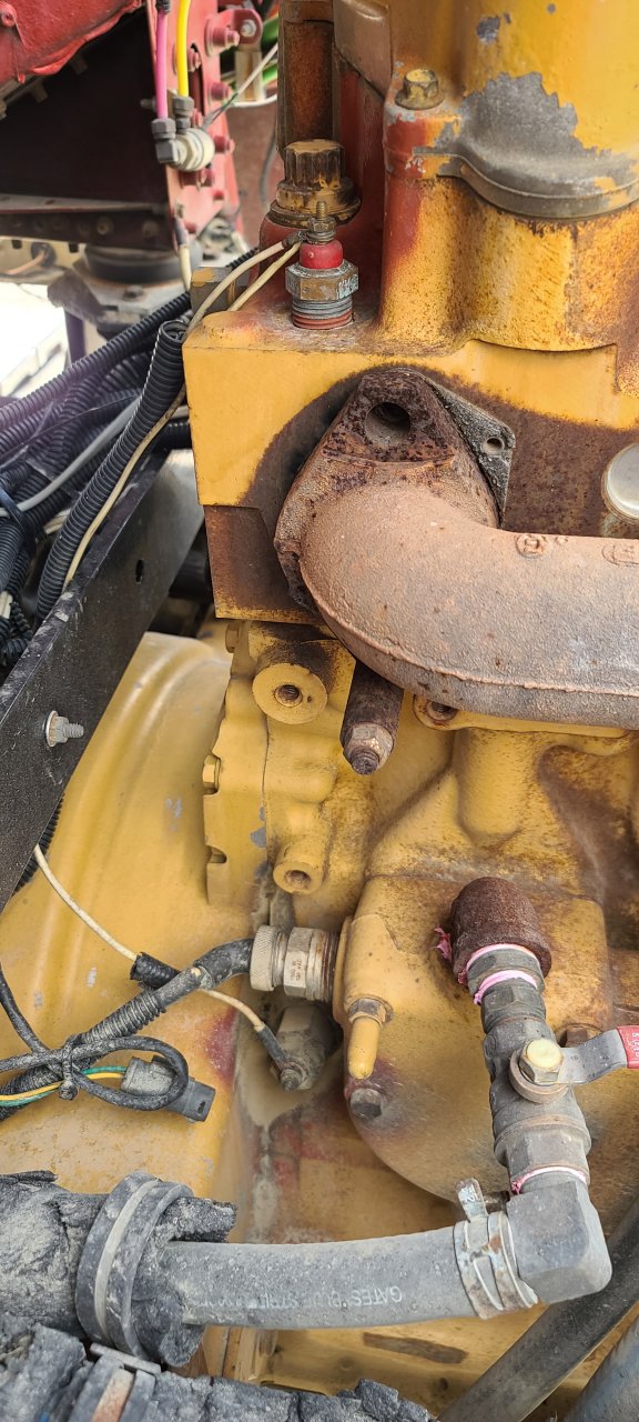

    You're gettin there. What I like about Peterbilt wiring is they're color & numbered coded, makes it easier to see what goes to where.
    Sometimes, when you get the manifold off, if you're lucky, there may be enough of a stub sticking out from the broken stud to grip with a pair of vice-grips. If there is, good, but don't clamp onto it yet. Heat it cherry red with your torch, let it cool, heat it again, let it cool somewhat and spray it with penetrating oil. Don't heat the head, only the stud. It'll come right out. Patience is the key...
