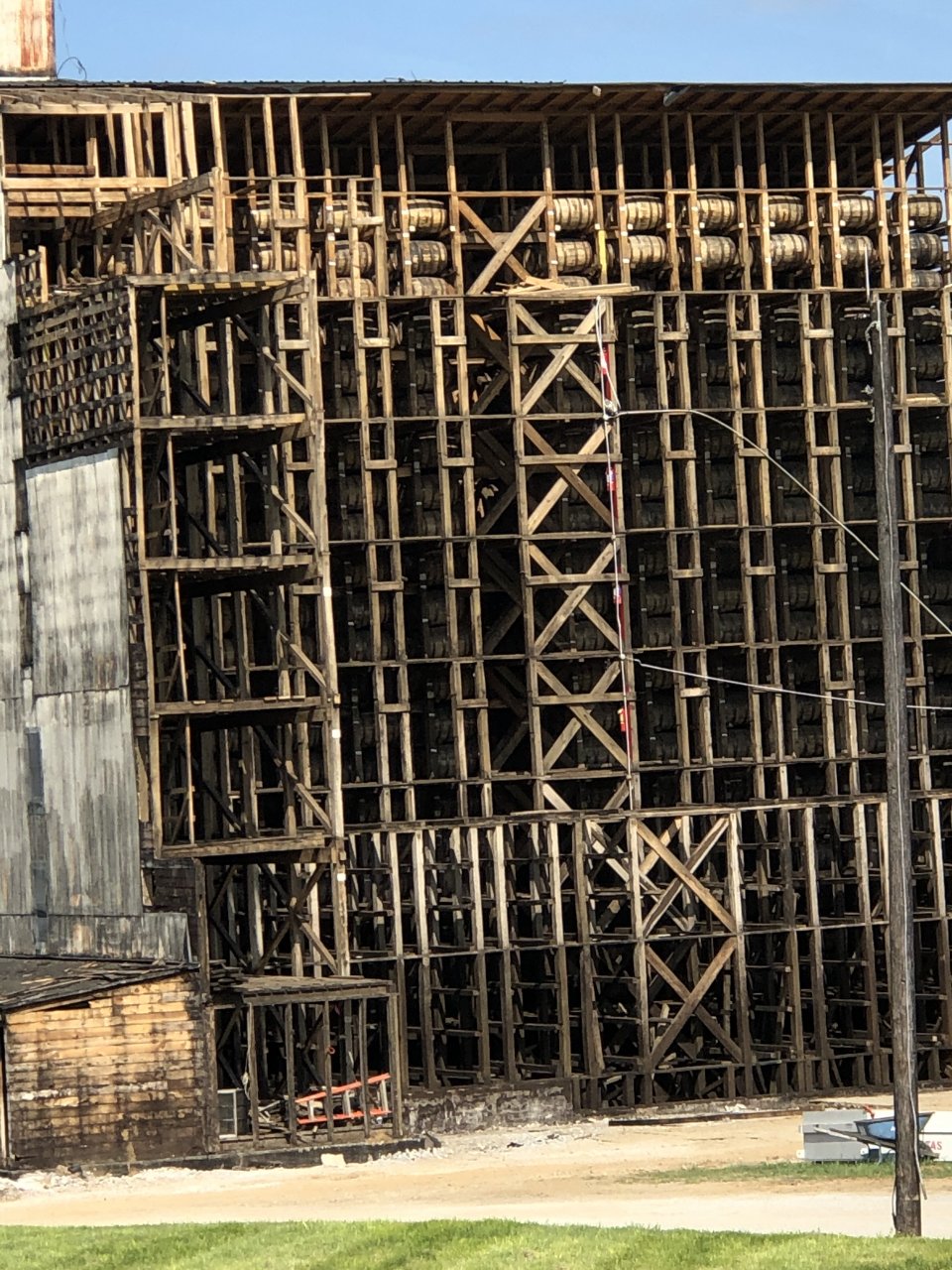

    Unloaded the steel this morning. Reloaded reclaimed lumber from a whisky storage (18,000 barrels in there). Got it dumped off and empty. Eating at the Dixie family restaurant on 55 in Illinois. 095FA73C-21CD-41A8-9152-8A86EE68E17A.jpeg
