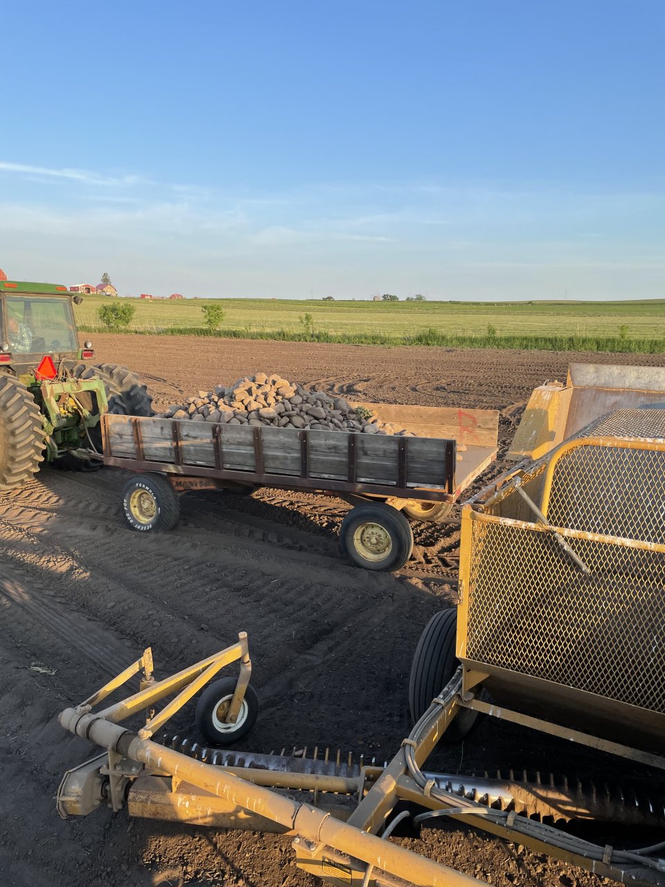

    Every time you post a pic, I just shake my head. You are a better man than I am sir.
    My luck though, I will be posting similar pics when I get my new place.....lol
