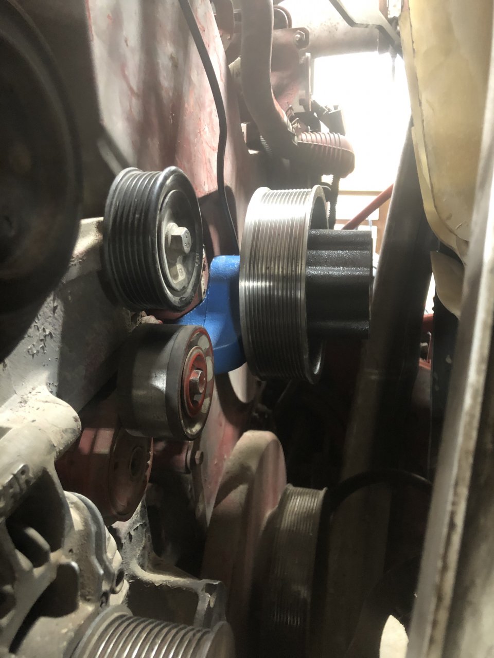

    Out with the old, in with the new.

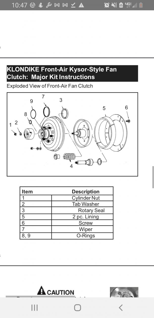

    This....I had it on the 94 aeromax I was driving before. A little tap with the key turned on.

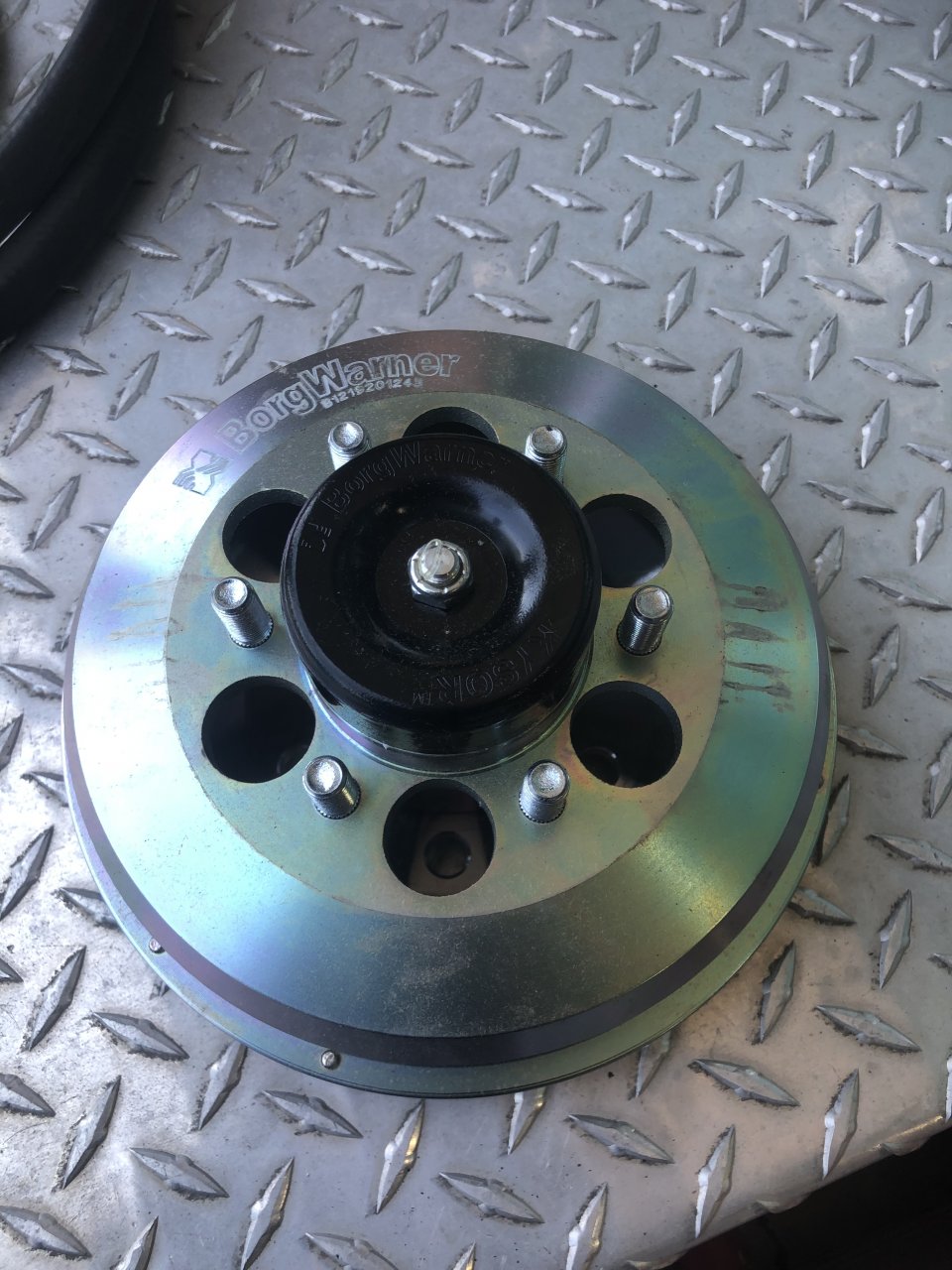

    Oh okay, my apologies. That’s basically what mine looks like, but also a BorgWarner. About to bolt that on as well.
  7. jamespmack
    Wait, it is. I'm getting confused here. Your only replacing hub? Not clutch?
    Regardless of name. That is a kysor style hub. Take the flat plates of the back and see if friction lining come out.
    When you showed new hub. I assumed it was a newer style clutch.
    This is difficult in text.

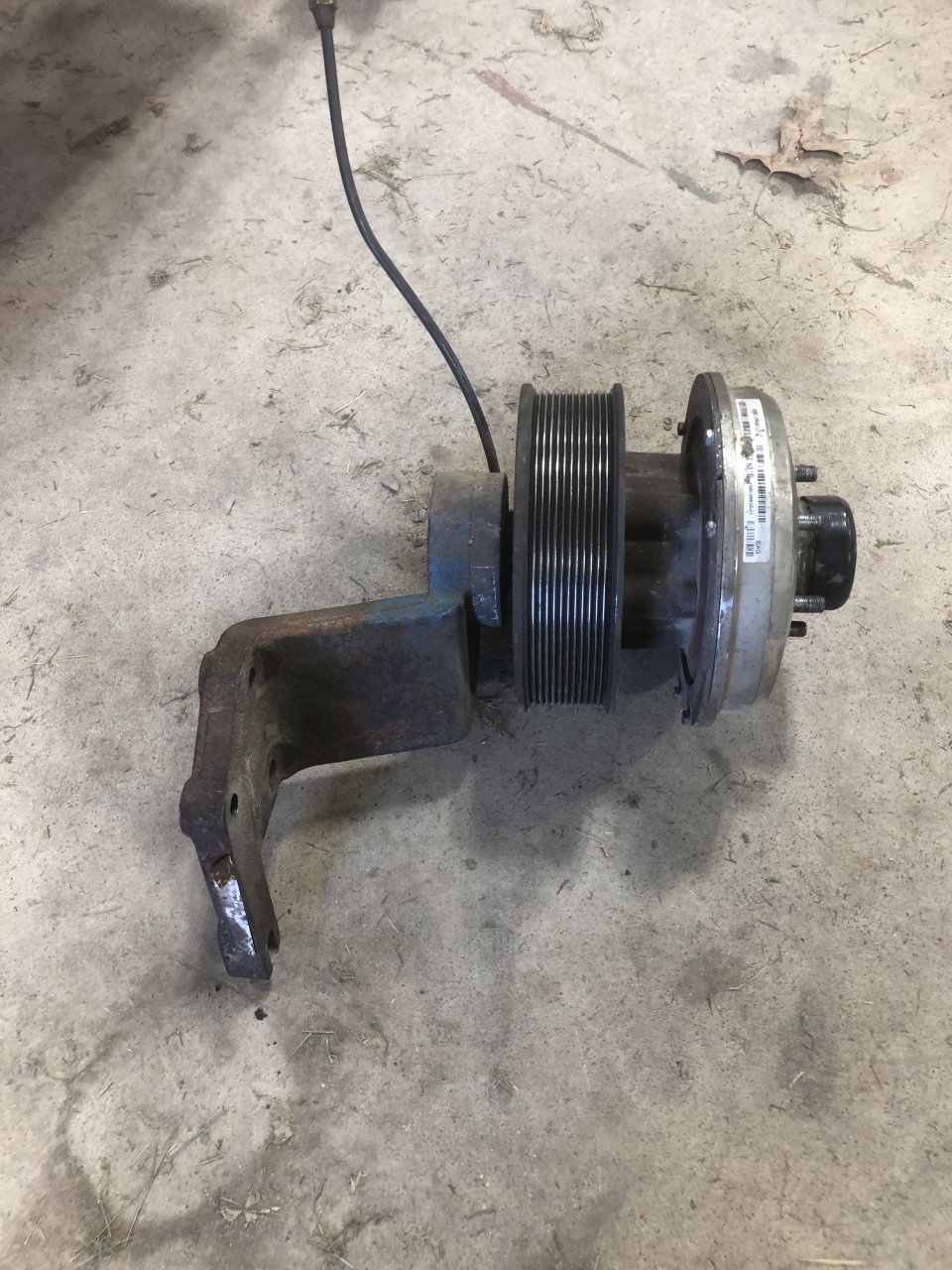

    Forgive me, I’m probably not using the right names for the parts. The new blue part is what I call the hub. Bolts right to the front of the motor. Then what I call the clutch, bolts basically to the front of the pulley the belt runs on.
    I’m sorry for the confusion, I have a hard time explaining myself most days.
    The first picture is it all put together, but that’s the only way I could take it out. I’m putting it back together in the two separate parts.

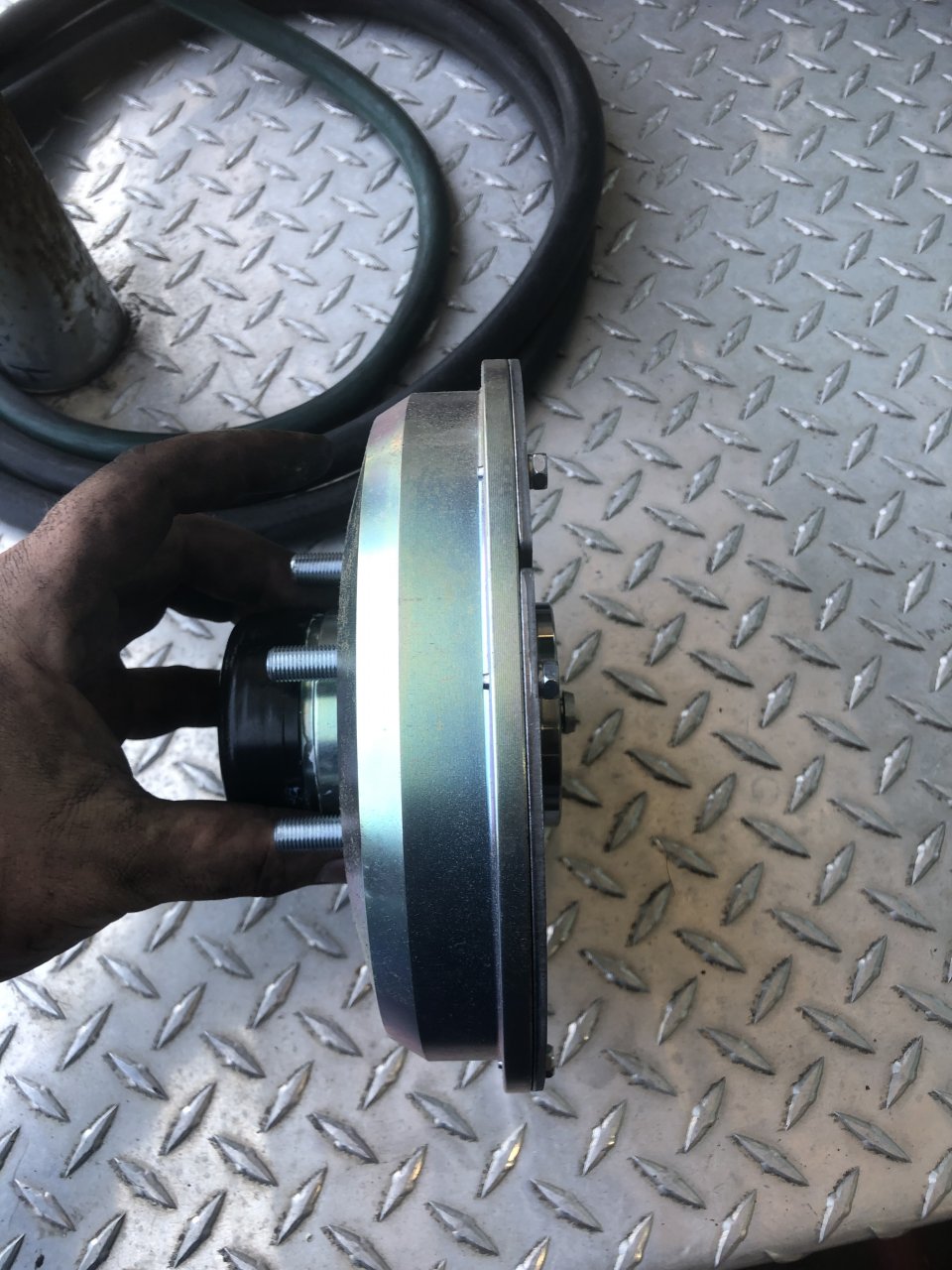

  9. jamespmack
    Your correct. But are you installing a new clutch or the old one?
  10. DeereRunner97
    DeereRunner97 Medium Load Member
    675
    18,467
    Apr 18, 2019
    Ostrander, Ohio
    New one, sir.
    143AA7B1-A5FE-4F75-822C-6BB97BE8164B.jpeg 587B9A70-A0B1-4174-B4C9-C27E18A18E1B.jpeg
  11. jamespmack
    See the little plates on the back with tiny bolts. Them come off so you can change friction material with out removing from truck.
