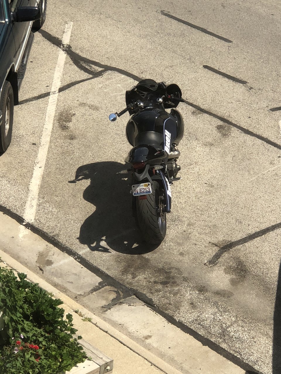

    Hummmm???
    Our commercial tenant has this parked out front when I got home from Colorado. Very tempting. 2E54B2F0-59DB-4313-8179-6B5FFEF670B7.png image.jpg

    Always told myself if I got a sport bike I’d be dead by the weeks end.

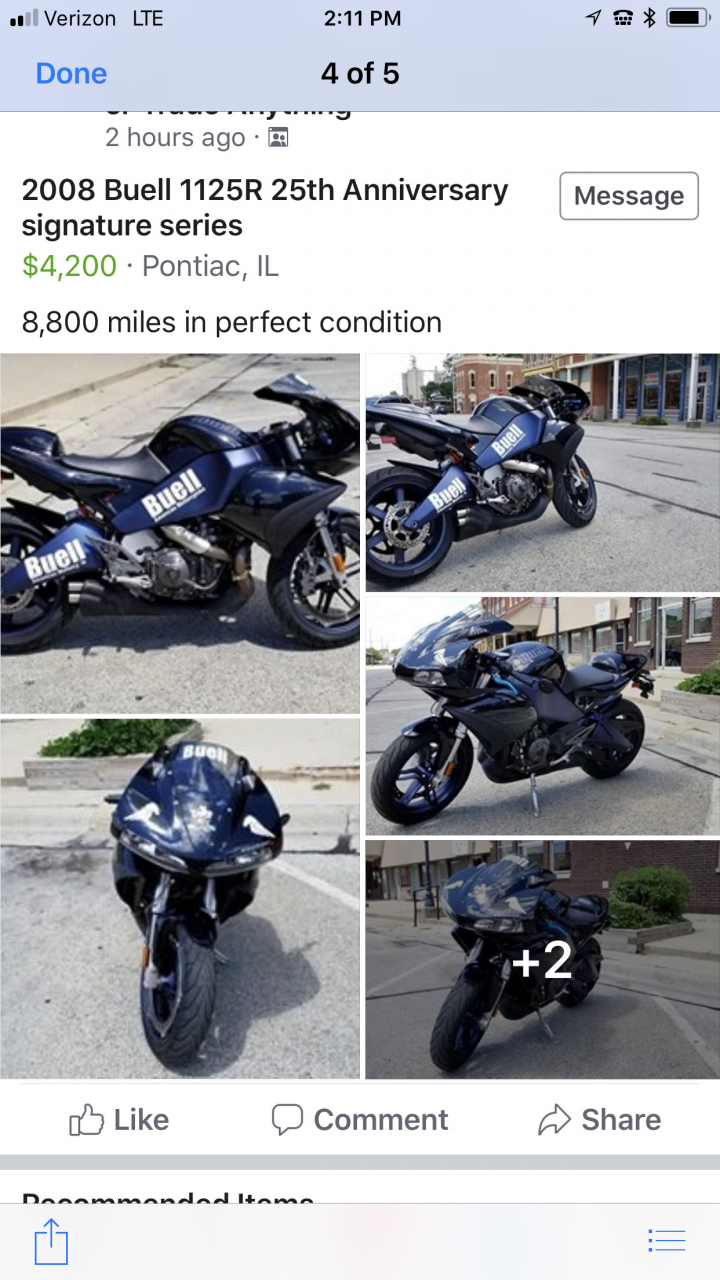

    Mmmmmmmmmmmmmm...
    I need to stay off TruckPaper during downtime. Might get myself an expensive birthday present that I can’t ride in for a few more years if I keep this up...
