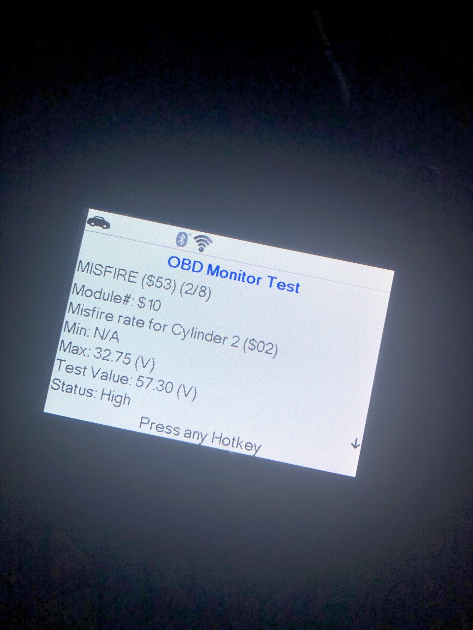

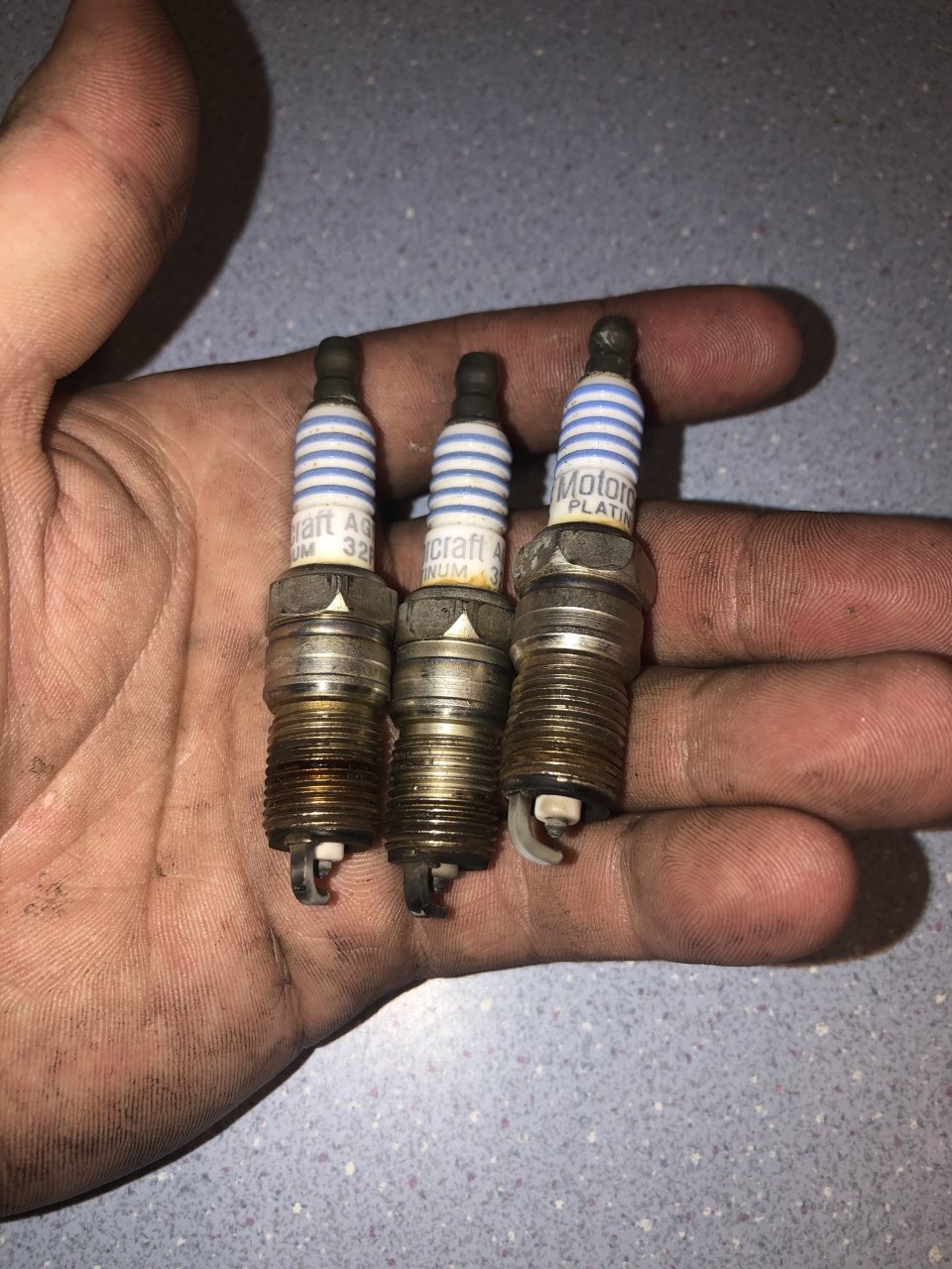

    Thanks; my #2 cylinder is the one that’s apparently bad, but they all look a little worn so far
    Tomorrow is new coil packs because uh, well, they somehow melted a little on top :oops:

    Plugs aren't terrible. I've seen worse. I'd be willing to bet those melted coils are probably the reason for the misfire.

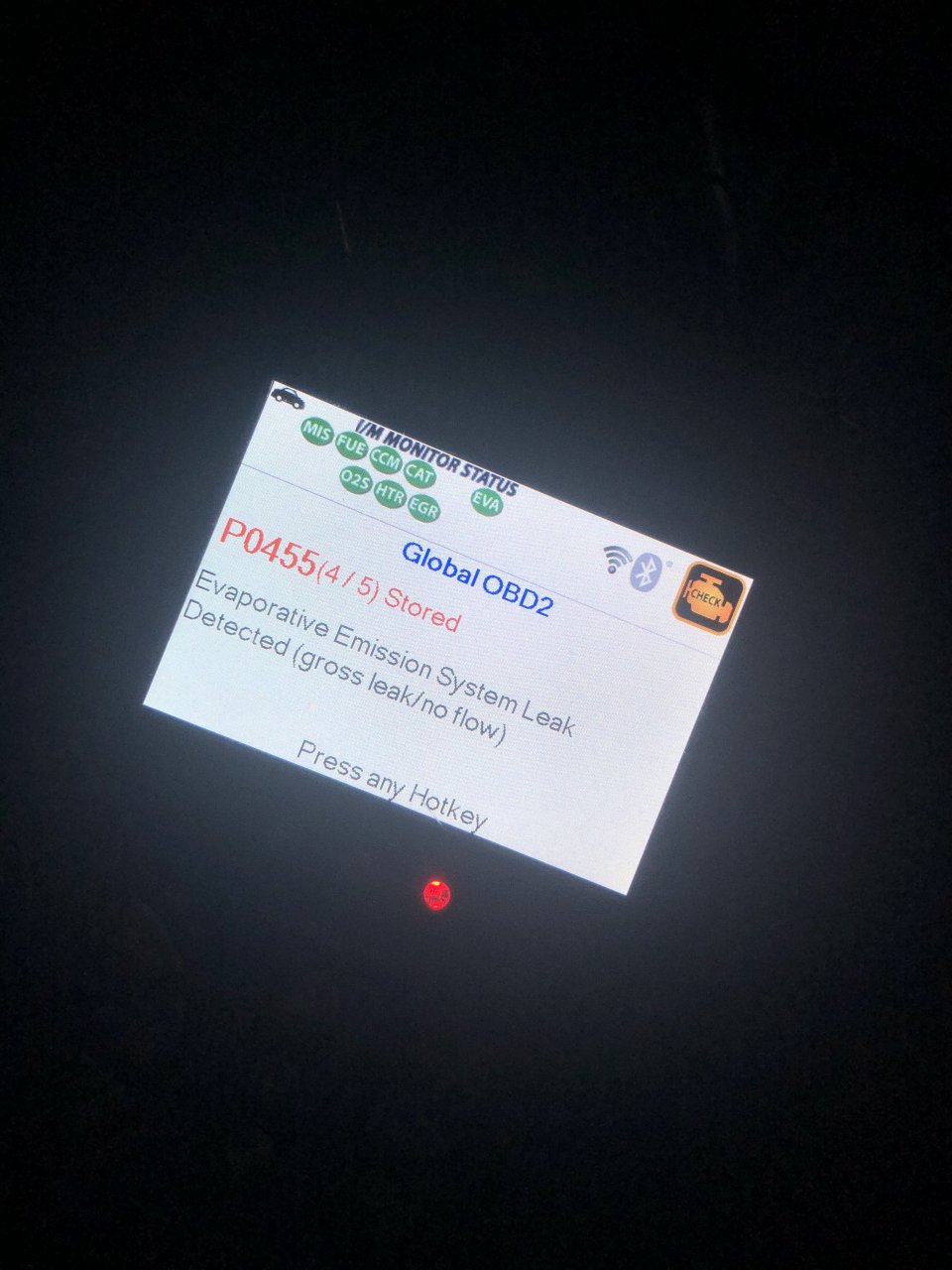

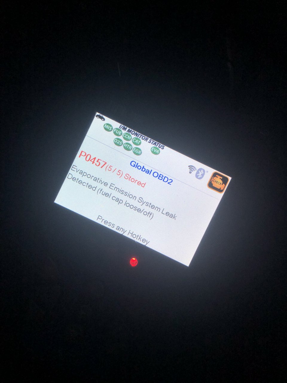

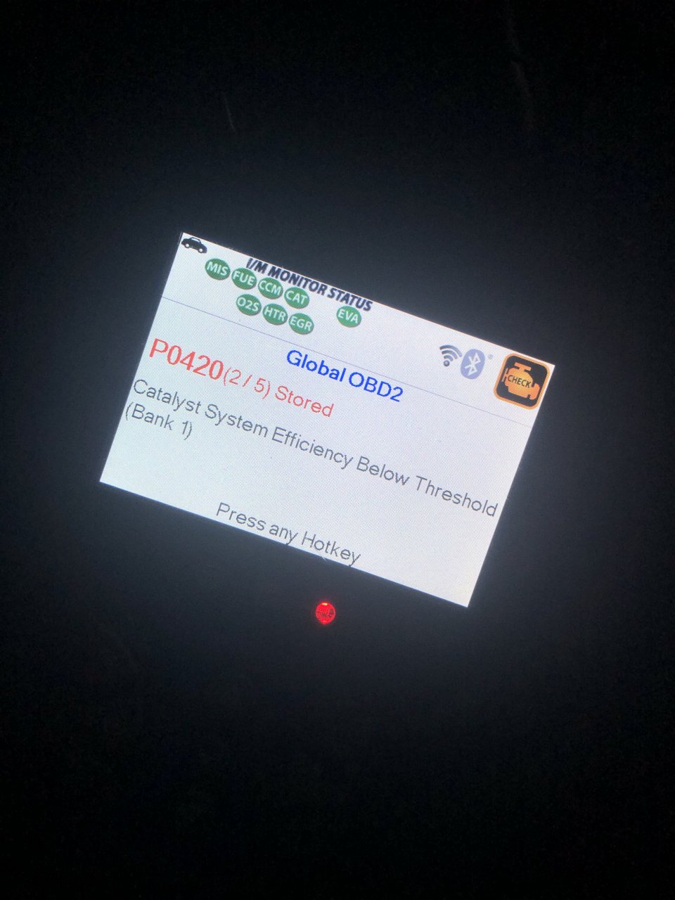

    Well hell one more post; here’s all the codes I ran into and I’m praying to the car Jesus that the “system too rich” code has something to do with the bad spark plug :D

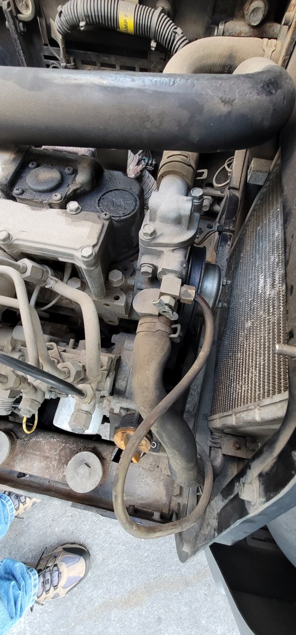

    If thats the inside belt up near the right side of the engine. What a PITA that is to change...tripac sucks. Ive given up on mine . Ive thought about unbolting from the frame and just leave it behind in the truckstop
