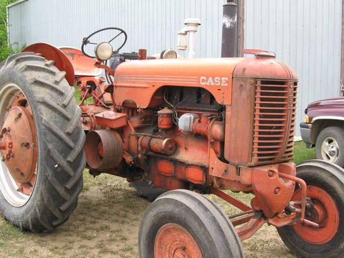

    That's a DC4... I have one as well, just a different axle. Looks to be a foot clutch version?? Mine is hand clutch, 1949 model. Does it run? Have 3 point? All big factors on these DC's.
  5. AModelCat
    29,736
    165,154
    That was just a pic I pulled off the web. Might be a late 40's the one I'm looking at. May as well call it rough shape. Runs and drives but tires are shot. Hood and tin work are dinged up. No 3 point hitch but it has a rear PTO. Hand and foot throttle, foot operated clutch only. Auxillary hydraulics driven off the front of the engine as well (probably not OEM though). Inline 4 gas engine.
    Edit: Belongs to a relative. Just curious what its worth and if its something rare/worthwhile restoring.

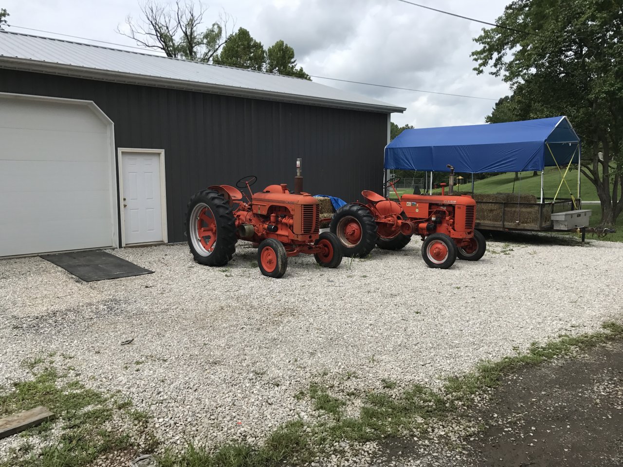

    IMG_5604.JPG Jumping trough hoops today trying to get ready for the show. Got my Gristmill cleaned up now to get it back together.... According to Meadows archives, it was built in February 1916, still going..... y'all be safe out there!

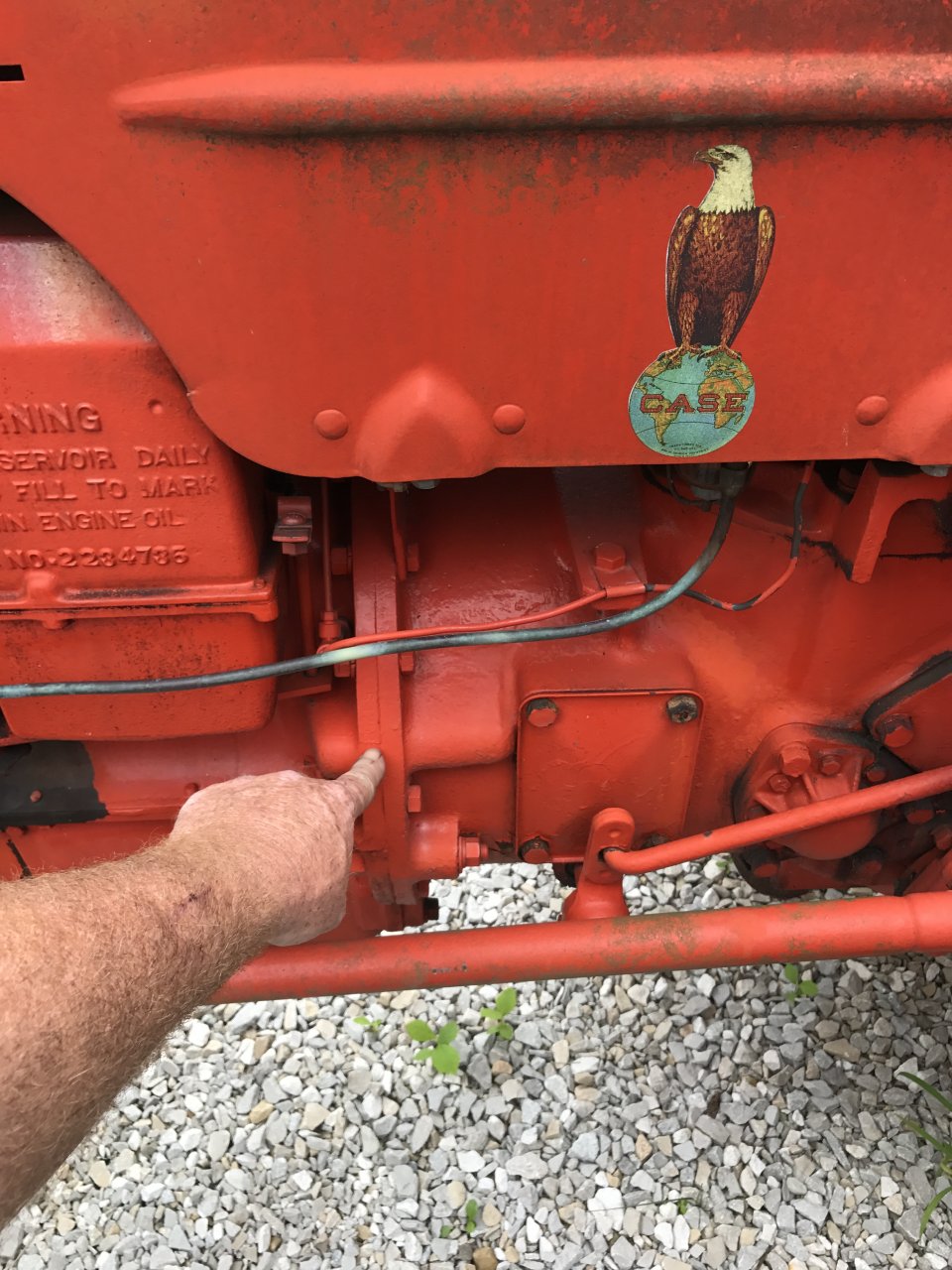

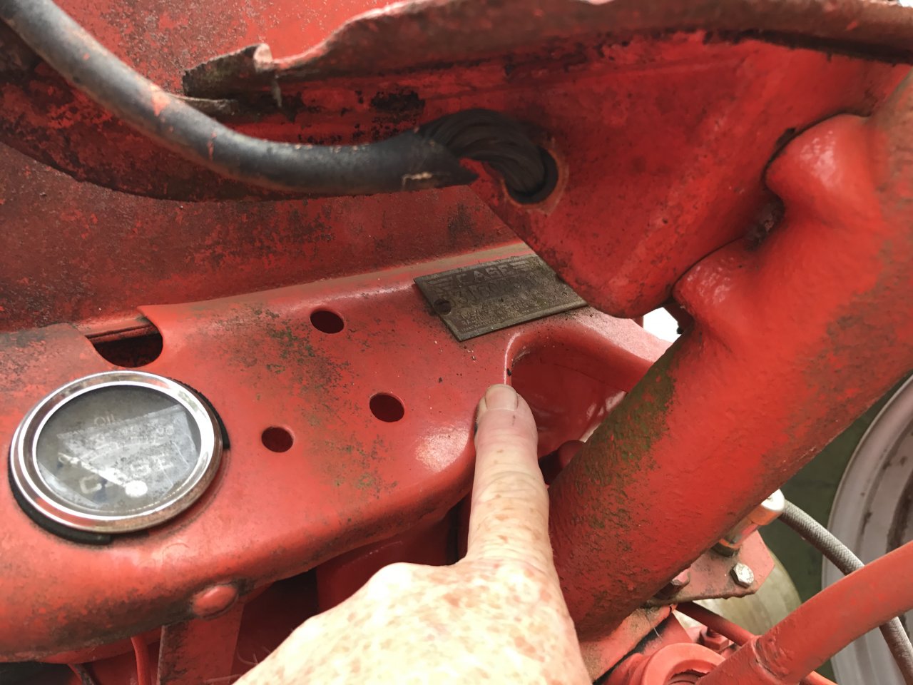

    No 3 point but has a Foot clutch? That should be early 50's. Hyd pump is internal and control valve is right below the PTO. A 2 point lift was common for cultivators only... front and rear.
    These tractors are internal chain drive... notice the slotted bolt holes on the axle housings? Made for adjustment of the chains. Is the tag still on the dash under the battery box?? If so take 1st 2 numbers and deduct for year. Also look on left side of bellhousing if no tag, you will find the serial number stenciled there.
    Example... 508421
    50-4=1946. Hope this gives some insight.
    Oh... and the shafts in the transmission all run parallel with the rear axle not the crankshaft, that's why it shifts side to side not front to back ;). Also it has a wet clutch... oil pumps through the rear of crank and lubricates the clutch, then drains back into the pan. Very strong tractors.

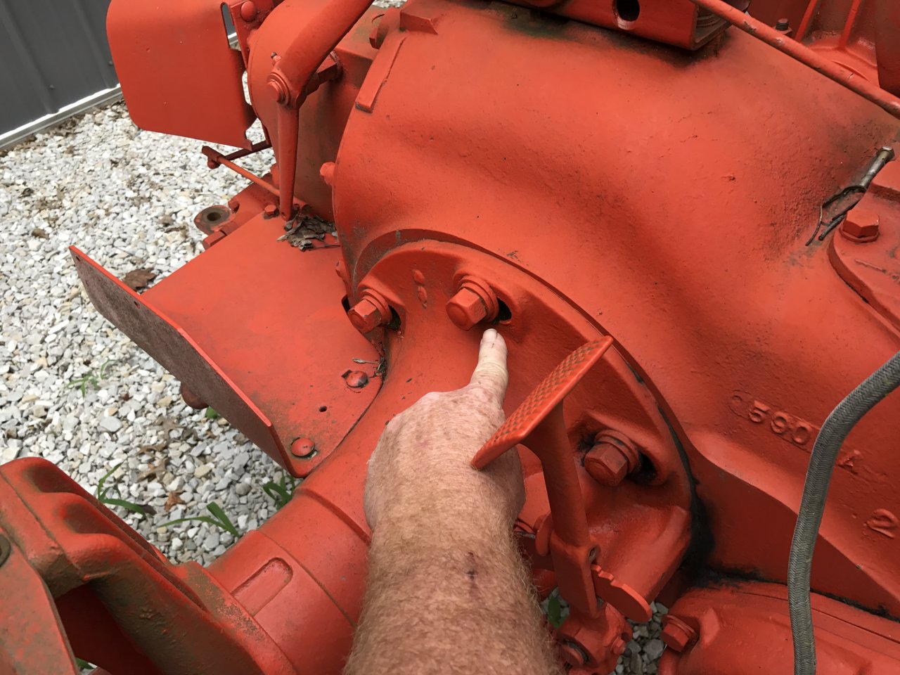

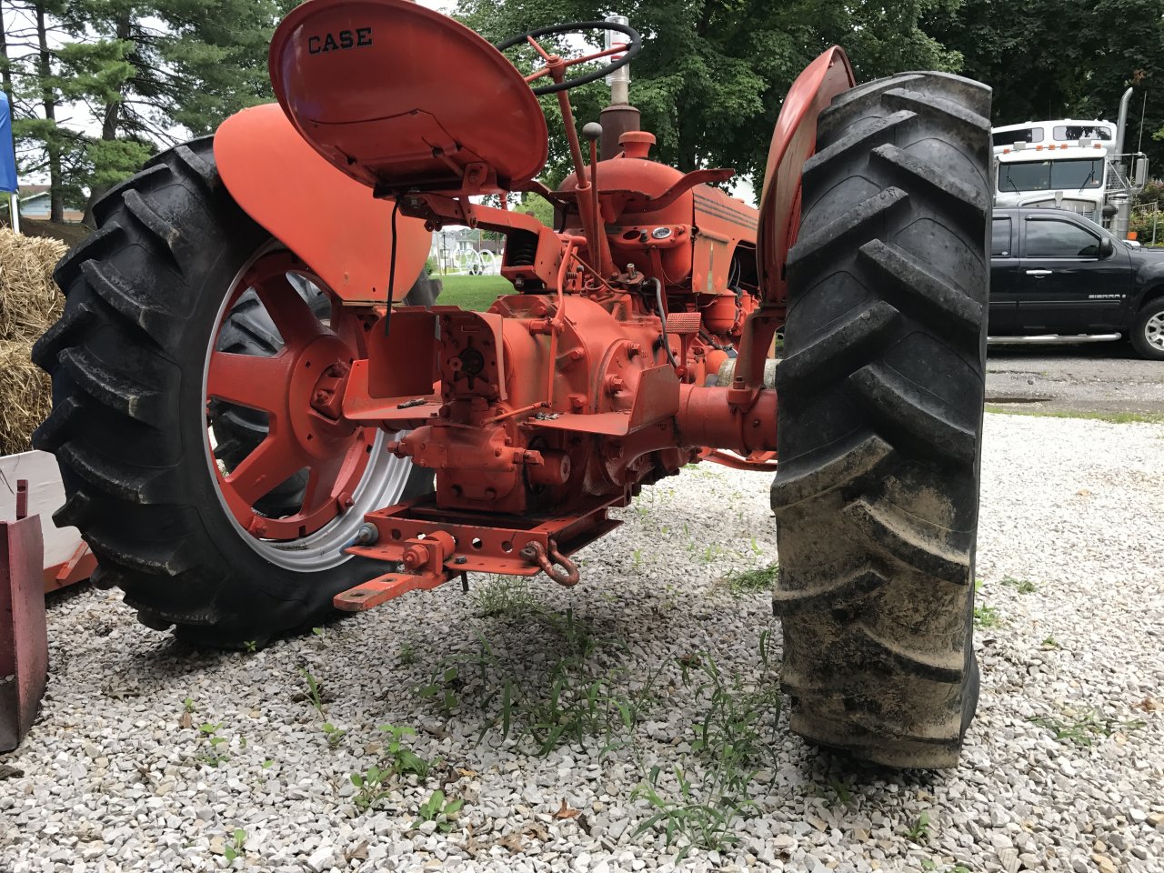

    That would make more sense with a foot throttle....
    This is a 1951 VAI, same goes for the serial number tag on these. Except they don't have the serial number stenciled in the bell housing. Live hydraulic pump will be on on right front of engine, older hydraulic pump will be behind the flat belt pulley on right side. Think live hydraulic started 1948 if memory is correct. Great little tractors with a great view and easy pedals on the legs.... N series Ford and Massey will wear your knees out if you work them a lot.
