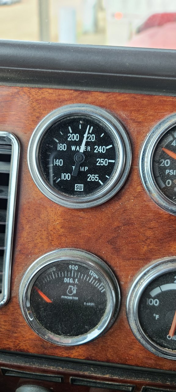

    Have you checked to see if the gauge is actually right? I know you posted a bunch of stuff can't remember if you verified the gauge?
  9. Lysdexis
    Lysdexis Road Train Member
    4,484
    47,957
    Oct 25, 2018
    Yep. Gauge is correct. It's a mechanical gauge and has been verified as correct. Only thing left is pump/backing plate
  10. Oscar the KW
    Oscar the KW Going Tarpless
    12,247
    28,120
    May 19, 2011
    Have you inspected the thermostat housing?
    Friend of mine chased this same issue, overheating going down the road in the summer and wouldn’t keep water temp sitting still in the winter.
    Housing had pitting inside and looked like the thermostats were able to move some. It is the same kind of pitting you get with the old green antifreeze when the nitrate levels are not taken care of.
  11. Lysdexis
    4,484
    47,957
    Oct 25, 2018
    Housings looked good inside when I changed the thermostats. They fit relatively snugly in the housings. I'm not really sure how those thermostats work being hollow but what do I know.
