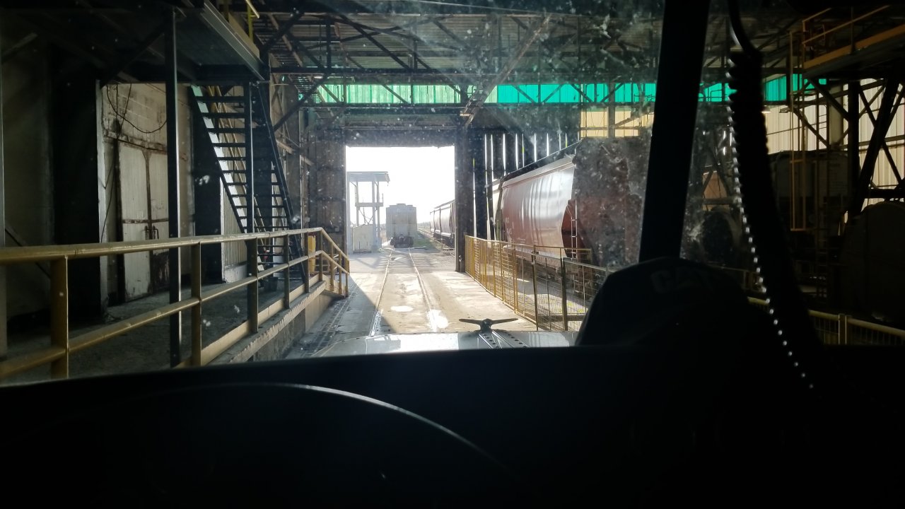

  4. Zeviander
    Zeviander Road Train Member
    4,886
    36,995
    Jan 23, 2015
    Winnipeg, MB, CA
    Doin' that potash deal.
    Quick question for my hopper bottom friends, and it's something that I keep getting asked but don't have an answer for, and can't find anyone with an answer, what is the difference between on gates or on slopes?
    Every place I load always asks, and I always answer, whichever is easier. What, if any, difference does it make? Something about pressure on the gate?
