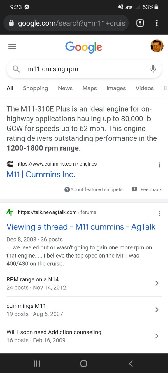

What rpm we talking? Cummins claims optimal performance at 1200 to 1800 rpm for the m11Brettj3876, Eldiablo, D.Tibbitt and 6 others Thank this.

Detroit claimed the same rpm basically for the Series 60, & they are both dogs under 1400 imo. (Talking 11.1L 677ci & M11 661ci) They will both cruise at 12-1300 on the flat, but fall on their face on a grade at that rpm..

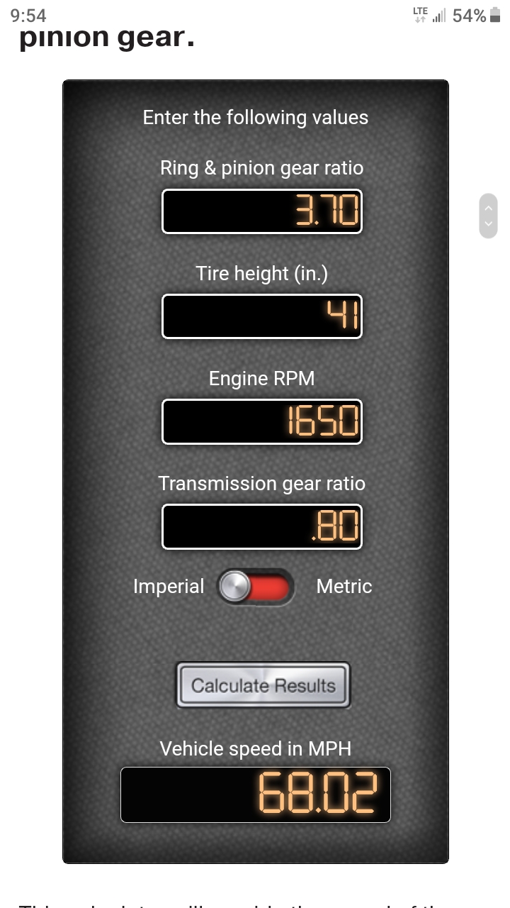

62mph is~1500
66mph is~1600
70mph is ~1700
She seems to do fine anywhere in that range at this weight. Although there aren't really any hills I've run into today being in the midwest other than over passes..
When I hit 76mph, was just for a few seconds to get around a truck so is wasn't a snail race, but about 1850. She kept pulling, but that was plenty fast for me..
