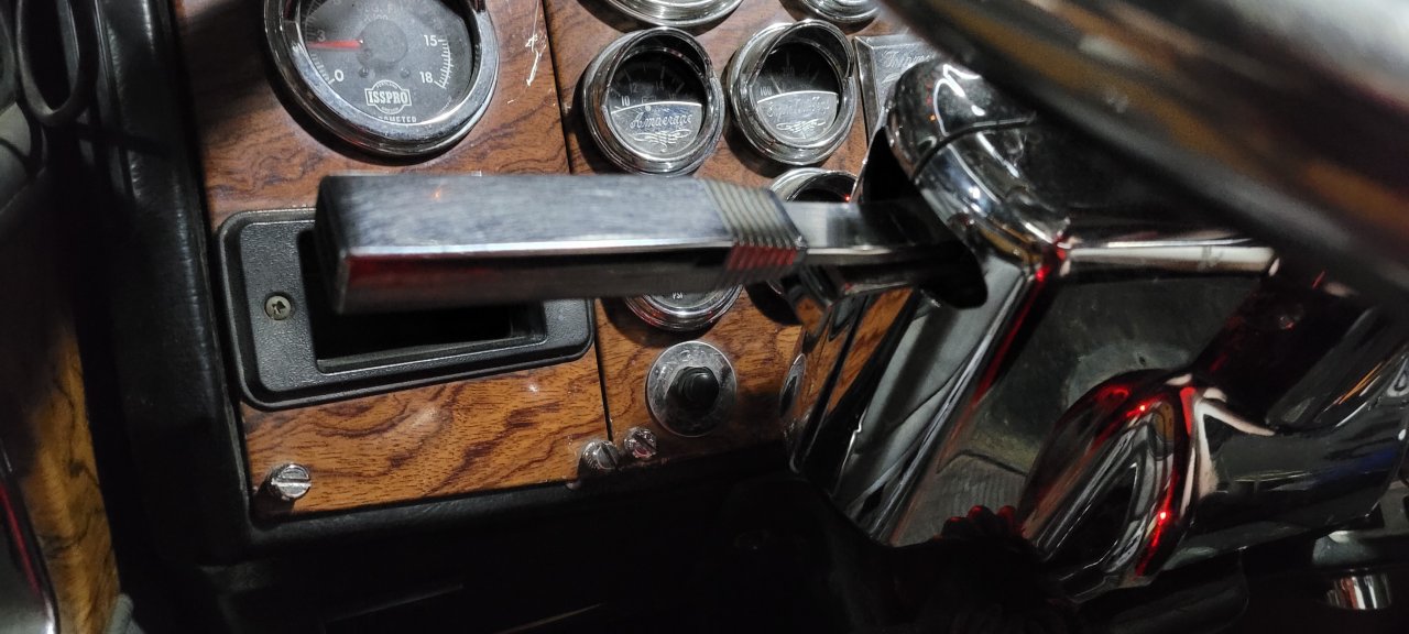

    So, this morning I turned on my lights and they were still the same. So I started going through the fuse box making sure I didn't overlook something. Started taking out fuses and then realys 1 by 1 then putting them back in. I get to the left headlight relay, pull it out and the brights go off and all is normal. Huh.....both headlights are on though....odd. pop it back in and everything was back to normal. Got all the lights I'm supposed to have. So, I count my blessings and got outta there.
    So, what I'm thinking is I got water inside somehow and there must have been water holding the circuit closed. Last night it was still screwed. So it must have dried out enough when I pulled out that same relay this morning it reset.
    When I get home I'm going to put a flashlight under my hood at night and look inside for light. Gotta have a leak on the firewall somewhere. If I recall, this is a common 379 issue. I plugged up some firewall holes this summer.....obviously didn't get them all.
    Also, my turnsignal switch has some dead spots in it. So I'm going to order one and replace it when I get home. Question; I have the old style switch. Will the new style plug and play?
    Mine:
    New style:
    Peterbilt All-Makes Switch-Turn Signal ID: TL10750
