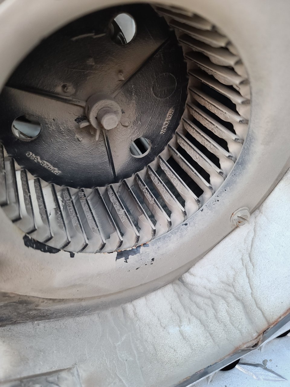

    The replacement squirrel cage used to be about $35. If that one is hard to clean check Napa with the size, direction of rotation and part numbers off it.

    I attempted to take the cage off the motor and it didn't want to budge and I didn't want to gorilla it and break something. The aftermarket makes a high dollar higher flowing replacement but we might have to wait on that if this one ends up getting clean enough.
    Black to black and orange to blue might not be the way its supposed to be hooked up. When I put it together I'll test the output before I finish it up and see if maybe it's something else not giving me full power to the fan. On the bench with the battery charger it blew nice and hard, hooked it up backwards and I had the same hum sound that I could hear in the truck with low air flow.
