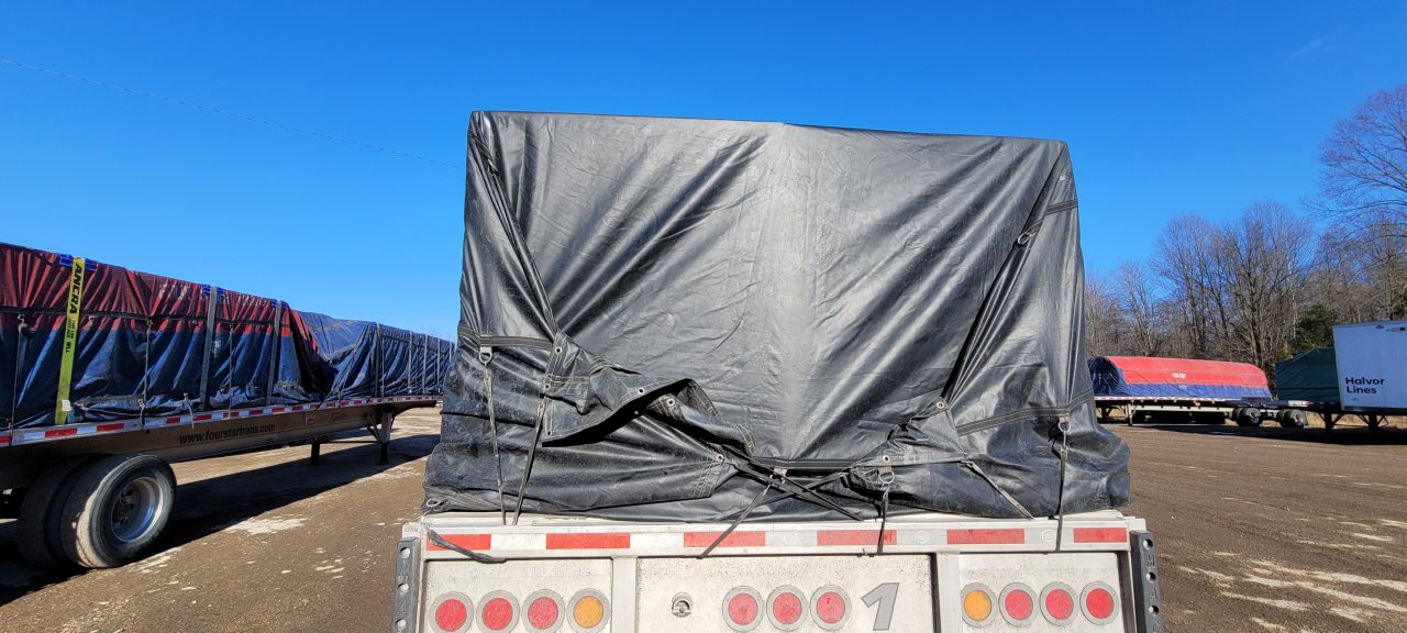

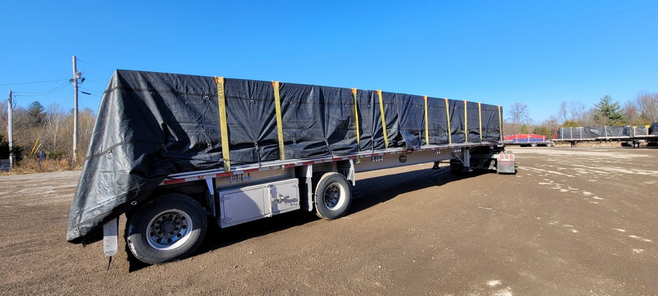

    Well, I'm actually ashamed to take this down the road. They do it all there for you. Then you pull out and away you go......but not really. As soon as I got out I about ####. I hate straps over tarps for one. The way they strapped it sucks. They tossed about 20 bungies on. So redo theirs and toss more on. I get to the overlap and I was like....where the hell is all my tarp at? Keep going with the bungies and get to the back....ohhhhh.....crap......there it is. My flap is even with the deck. You gotta be kidding me. .....why was that a good idea. So, I made the most of it. This load is going 350 miles, I'm not going to retarp and restrap for that. Just sucks. And again.....loaded right next to a Conestoga. FML!
    20211208_140544.jpg 20211208_140613.jpg 20211208_140616.jpg 20211208_140631.jpg 20211208_142752.jpg
    I'm actually ashamed of this. Glad I didn't do it, but I still have to take it. :mad:
