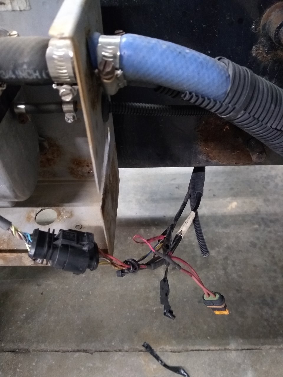

    Is it a fuel fired heater? It may need to be overhauled. The last time I did an espar, the full kit was like $180.00. From out to back in was a couple of hours.

    Yes, it's an espar hydronic H5. It's new. The original lasted about 8 yrs. I rebuilt that one then the fan went out so I replaced the unit.
    The controller lost power so I went to where I had repaired the harness a few years back assuming that was where the problem was. Turned out it was a bad fuse. The fuse broke at the solder joint but it appeared good. I finally checked it with the meter.
