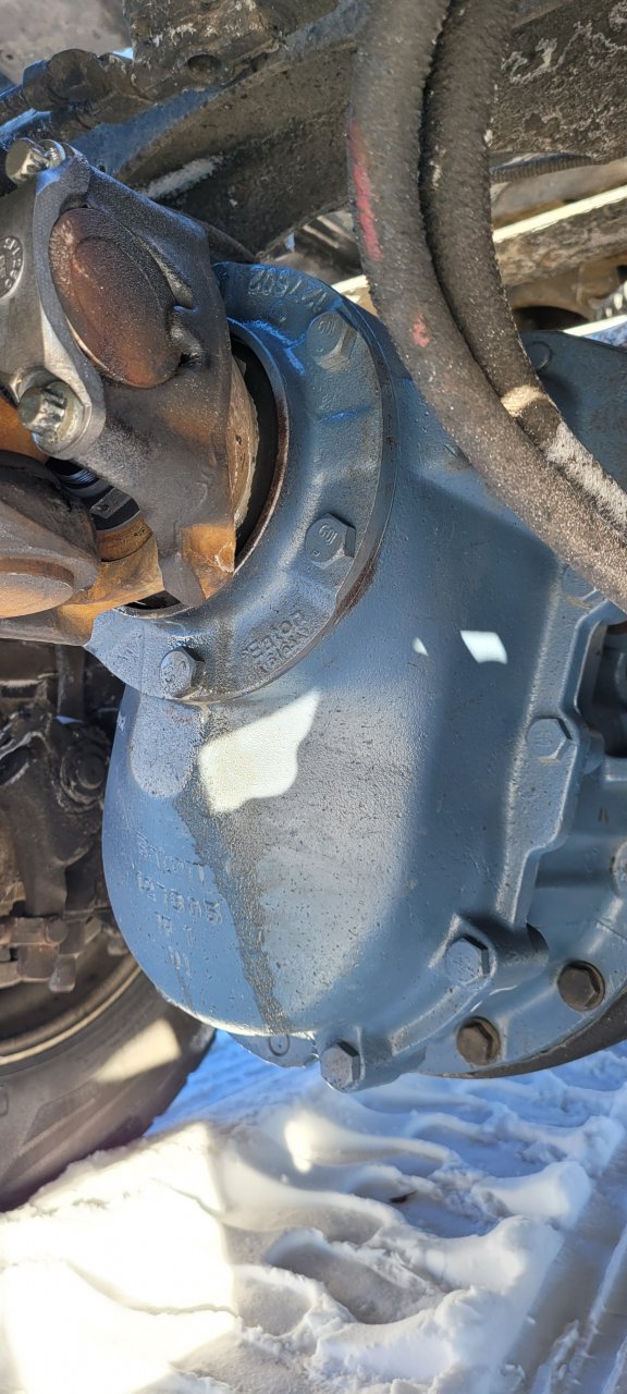

    I called that guy and I'm sure hes thinking I was loosing it. I sent him pics and he forwarded them to the mfg. I don't know if you recall, but this is how it started the first time. Wtf, didn't even make it 1 whole day! I'm gonna keep an eye on it. I have to go back there when my rear Fenders come in, so they can put them on. Hopefully it makes it that long.....gees. I'm really starting to question my sanity now.
  4. AModelCat
    29,761
    165,362
    How's the yoke look? Diff vent not plugged?

  6. jamespmack
    Technical yes. How much? No way to know. But that means your ......dicking with it 2 days not one. So do you save anything? Idk. I wouldnt be worried about going over in times of need. I wouldnt make a habit of it. I also get worried. In fleets I've seen it happen all the time. I still sheet bricks at 1000 miles over. Can't help it.

  9. jamespmack
    Id wipe it off with a rag and go. Looks like it is from assembly and collecting dirt. A diff leak is wet. Thats damp. Maybe grease or oil from seal or nut. They pack the seal with grease. Hell that tiny mess could be slung loctite.
    Nothing to be concerned yet. Check level and watch it.
