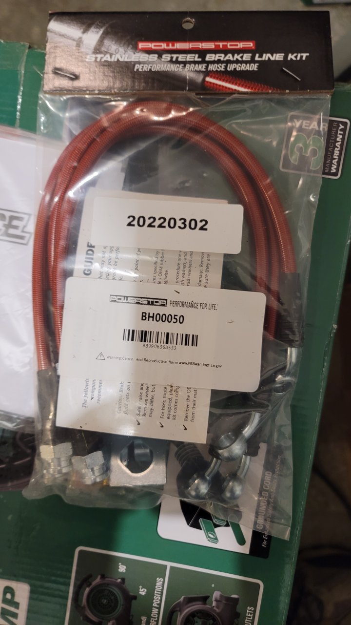

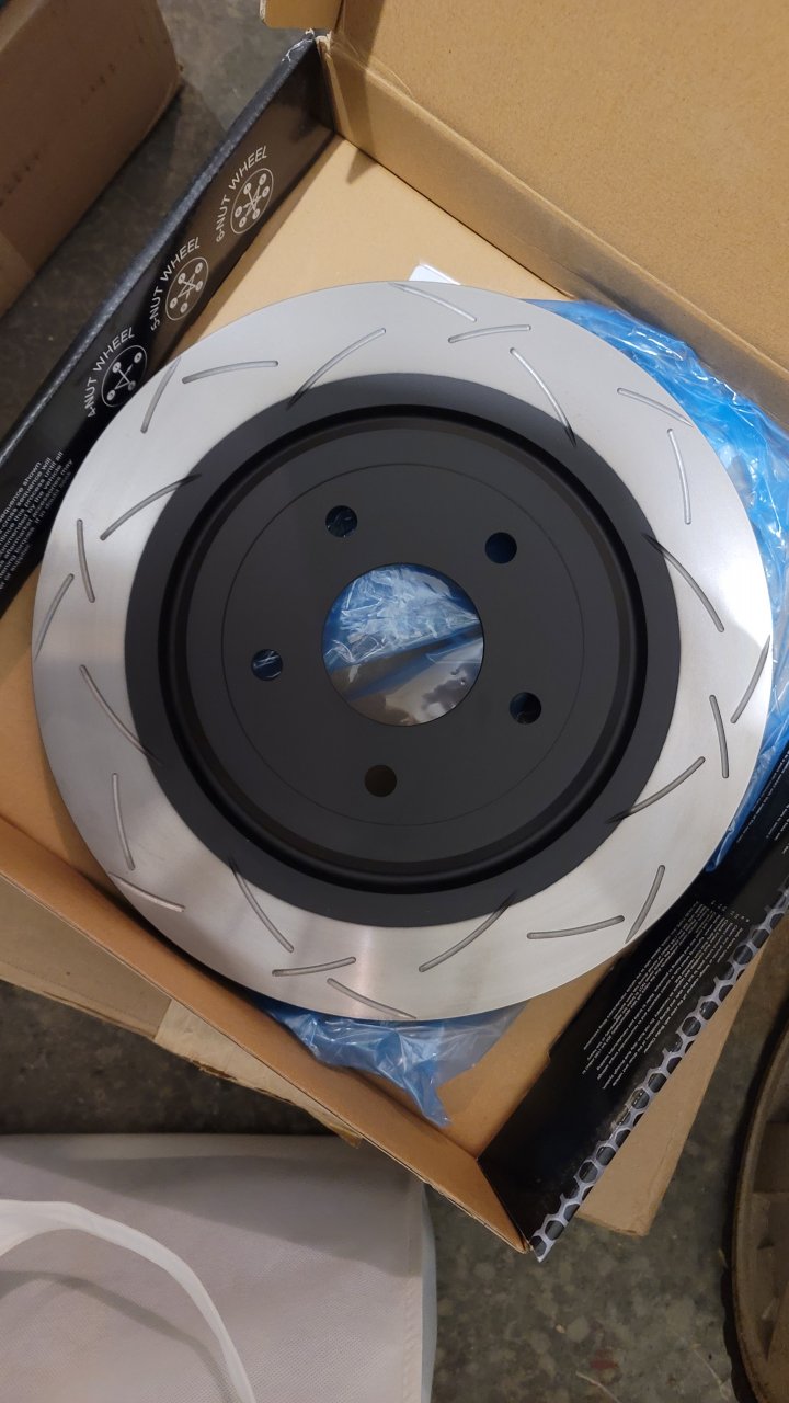

    I'm waiting on brake hardware to arrive, got these sitting here waiting...
    DBA T4000 rotors from KNS and Powerstop brake lines, with a set of Hawk HPS 5.0 pads.
