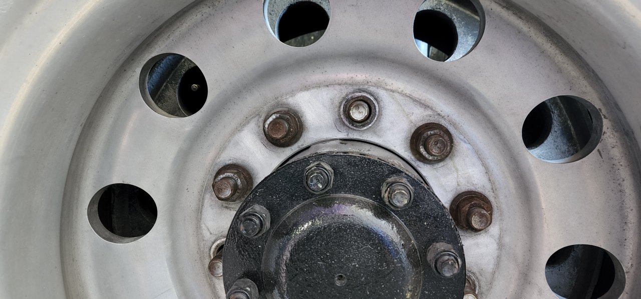

  1. jamespmack
    Sleeved nuts are useless on duals. And that rim ain't mounted square. Plan as day.

  4. Lysdexis
    Lysdexis Road Train Member
    4,483
    47,940
    Oct 25, 2018

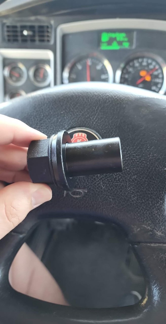

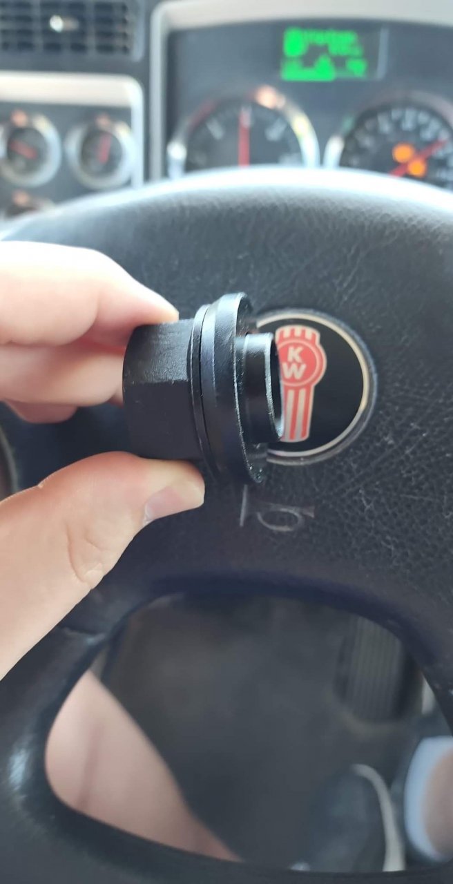

    Well yeah that's how it was when the first nut was buzzed off. The sleeved nuts I got go through into both wheels on the back.

  5. jamespmack
    Do not use sleeved nuts that go thru booth wheels. The inside will not stay tight. I've been down this road, tested tried. 2-3 years ago I told you how to solve this problem. And which brand. Im not telling you this for my health. YOU DO NOT sleeve duals.
    Problems that did not exist with budd wheels.
    cke, CAXPT, singlescrewshaker and 4 others Thank this.

  8. Lysdexis
    4,483
    47,940
    Oct 25, 2018
    Those are what he's talking about. I was under the impression the lugs did the same thing and stayed there so they'd technically be better than the pins you took off after putting some lug nuts on. Either way doesn't seem that centering them made a difference.

  9. PoleCrusher
    PoleCrusher Road Train Member
    7,503
    82,194
    Aug 26, 2014
    LLMF
    I'd give it a try if I were you. If you don't want to buy the pins, there are some plastic things that you can put on the lugs before you mount the rim that are supposed to do the same thing, and they stay on after mounting. I forget who makes them though.

  11. Lysdexis
    4,483
    47,940
    Oct 25, 2018
    From what I thought I understood these lug nuts were supposed to work the same way as those pins do. Southern tire mart did tell me if they didn't work I could pull them off and they'd give me my money back for them.
