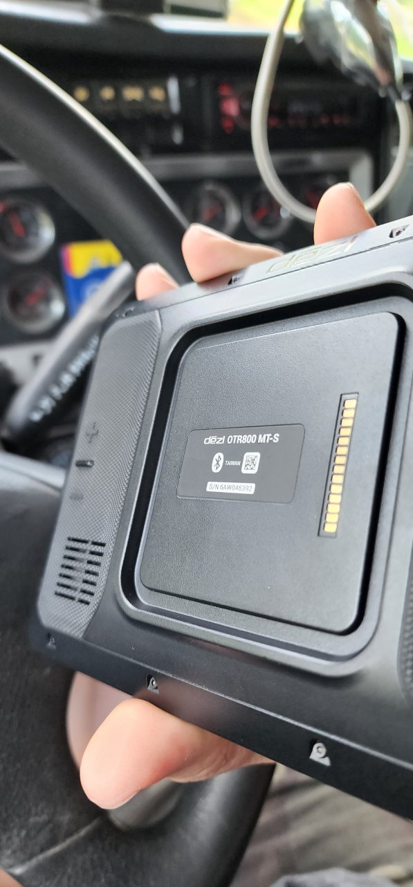

    Maybe that will work better when compared to this:
    This just begs for a bad bump to send you grabbing to keep it frome hitting something on the way down and breaking the screeen. Had one get damaged that way, and that's when I bought a refurbished TND 720. Unfortunately, now that outer coating is sticky as hell maybe from the sun or time..not sure which.
