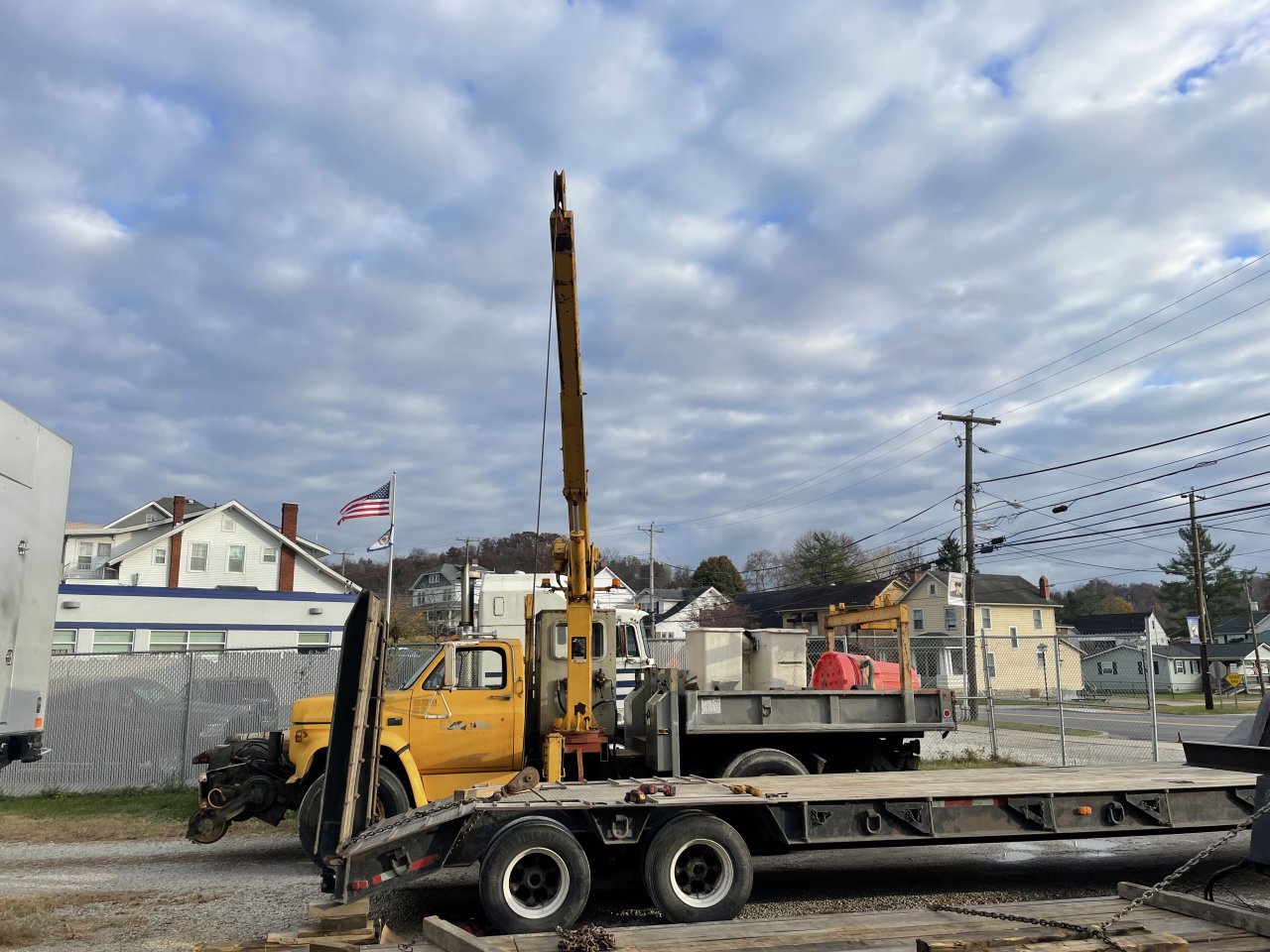

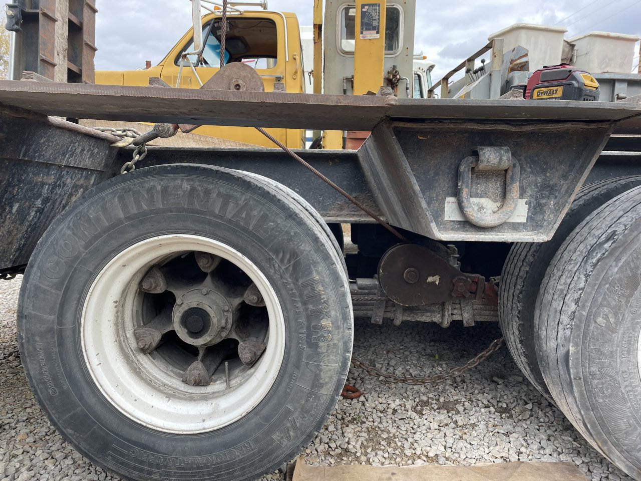

    Any idea what’s going on here….?

  9. OLDSKOOLERnWV
    19,323
    292,094
    This setup doesn’t actually have a center bolt. Instead it’s a big pin about 1 1/4” in diameter (circled in yellow) that the leaf springs set down over. The rubber pad (circled in red) sets on top the leaves and keeps the springs from coming up off the pin.
    Rubber pad is worn and allowed the leaf springs to come up enough to slide out of place. Thankfully I was empty, came in with it running dog legged as can be.
    Needed a way to pull the axle back forward so I used the winch on my boom truck. It will pull about 7000 lbs or so single line.
    Still had to use a hydraulic porta power to add a little more pressure before it slid back in to place. Now to secure it from happening again, that will be in the morning….
