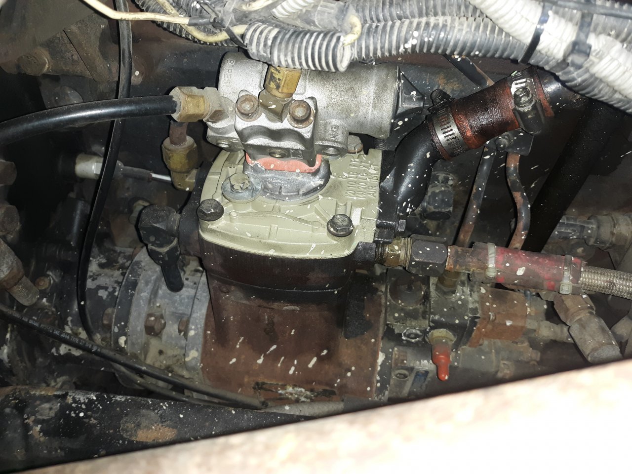

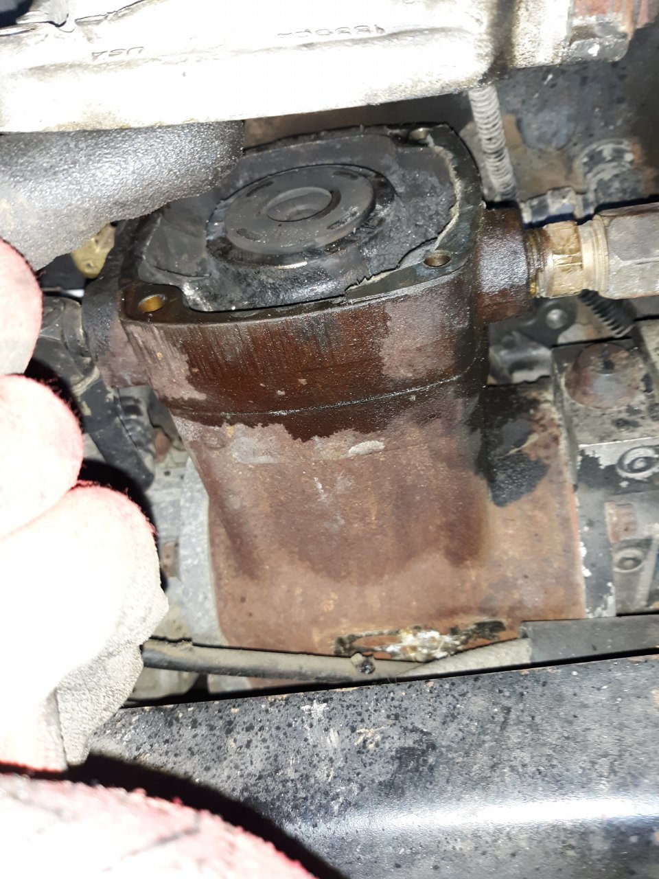

    Seems the drier froze up, & discharge line had an ice blockage in a bend 8" or so from the drier. Well this popped the head gasket the compressor. Just so happens I'm toting around a reman Holset SS296E under the bunk..
    Couldn't manage a full swap on the roadside with lack of tools, or confidence for that matter..:oops: lol
    Swapped the head & gasket from the reman unit (didn't want to tear the gasket at below freezing temp, & was stuck to bottom of new head)
    Cleared out the blockage in the discharge line, but unable to clear drier so just bypassed it directly into the wet tank..
    Far from perfect, but kept on schedule.. The cold finds flaws fast..
    Most of the gasket I scraped off before the pic. That my gloved finger holding up the head, but you can see where she let go from the weep

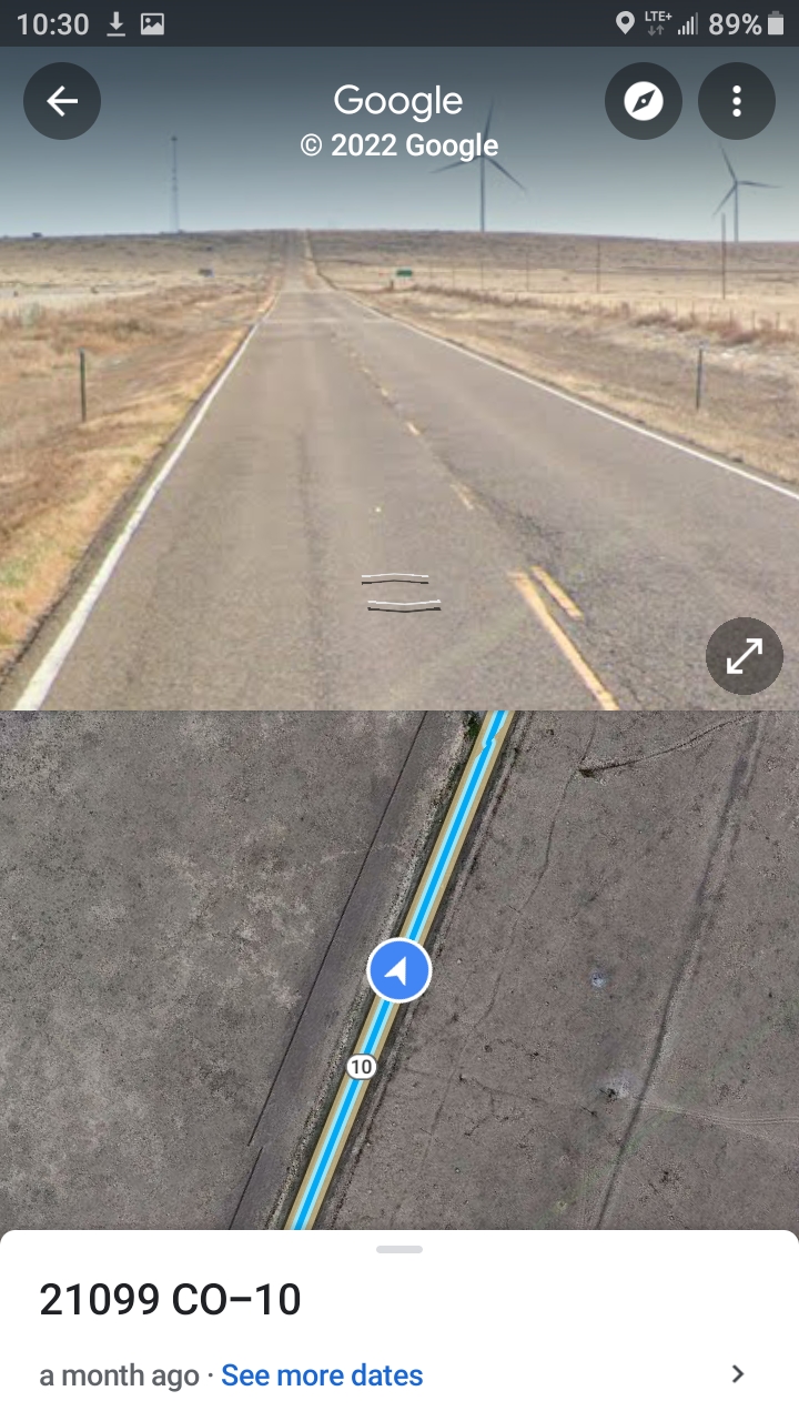

    Dang dude ! I was just on co-10 last month . they routed me down there 11-6 wide ,:eek: that aint the road u wanna break down on at all. Thank god for spare parts eh? great work man
