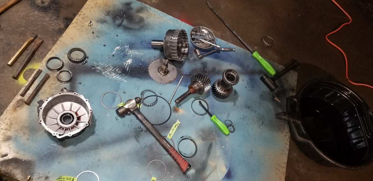

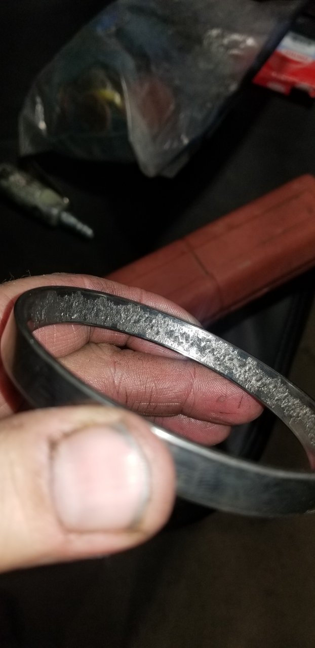

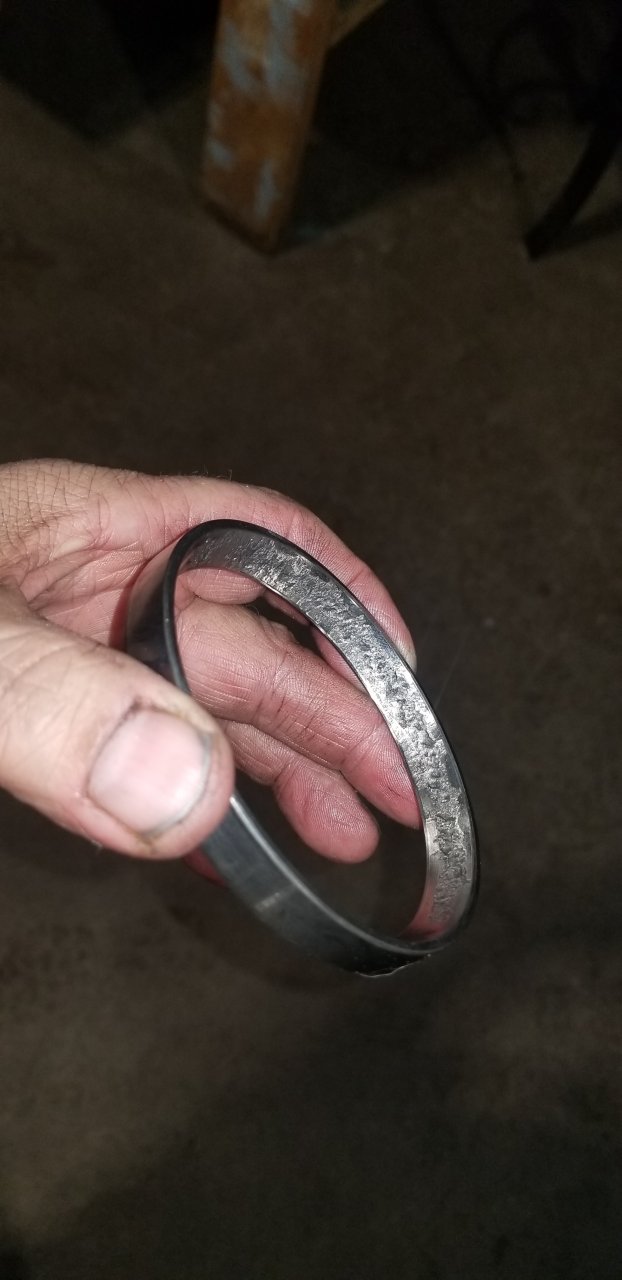

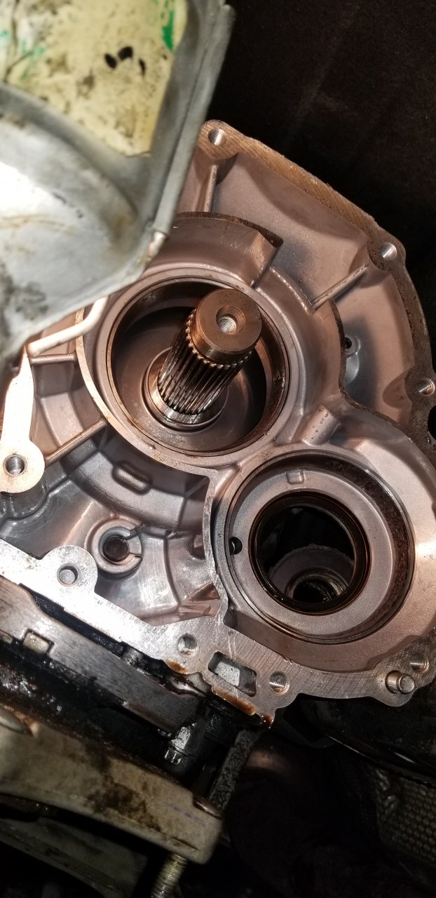

    Parts came for the wifes GLK350 so spent sunday under it and rebuilt the transfer case. Great vehicle, but ZF dropped the ball designing the transfer case. Front driveshaft slip yolk is actually on the out put shaft, so the seal is internal, shaft doesnt come out unless you dismantle the transfer case or remove the whole affair. It had 2 bad bearings, one on the trans output shaft, and the output shaft for the front diff..when you put it back together the front shaft has to be slid thru the seal from the pressure side of the seal. You can't see what your doing, and if you roll the lip it's done. If it leaks, you have to take the transfer case apart again to do the seal.... used a small endoscope camera to get it as lined up as I could and pulled the camera and slid it home. So far, no leaks... this new crap is why i like my old square body. Shops wanted $4500 to do this job, $400 in parts and that included trans fluid and filter. $100 hoist rental, $90 for a pump and adaptors to fill it.
    And beer.
    I told the wife after we retire, my square and An old Chevette is all were gonna have. Simple, no computers, easy to fix...lol
    20230115_160357.jpg 20230115_160349.jpg 20230115_150043.jpg 20230115_141109.jpg
