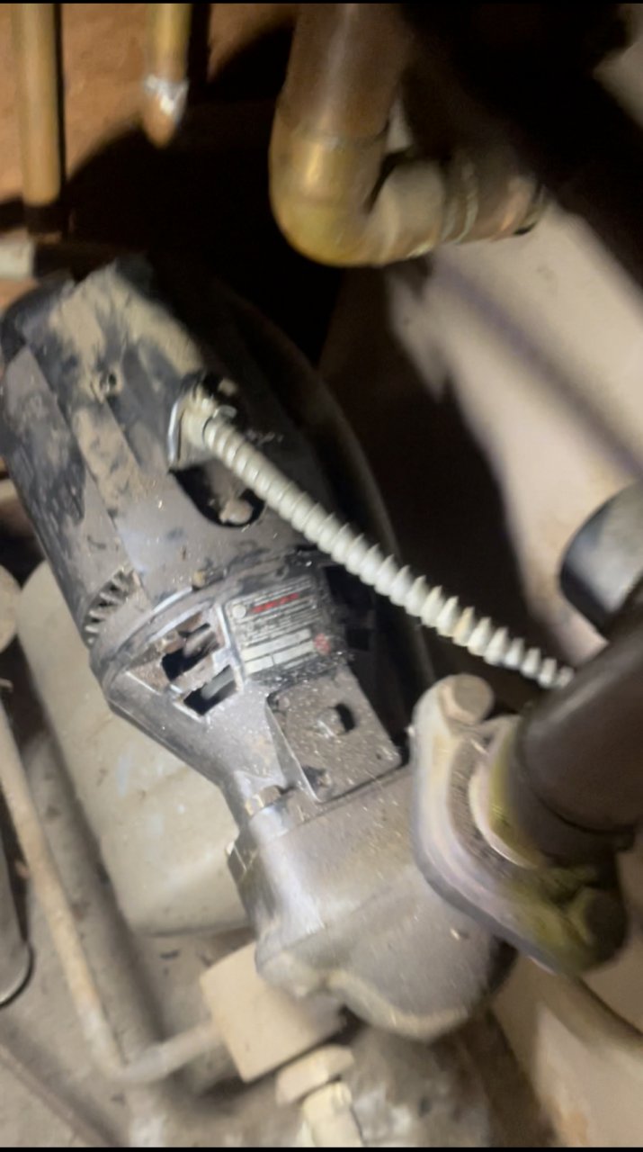

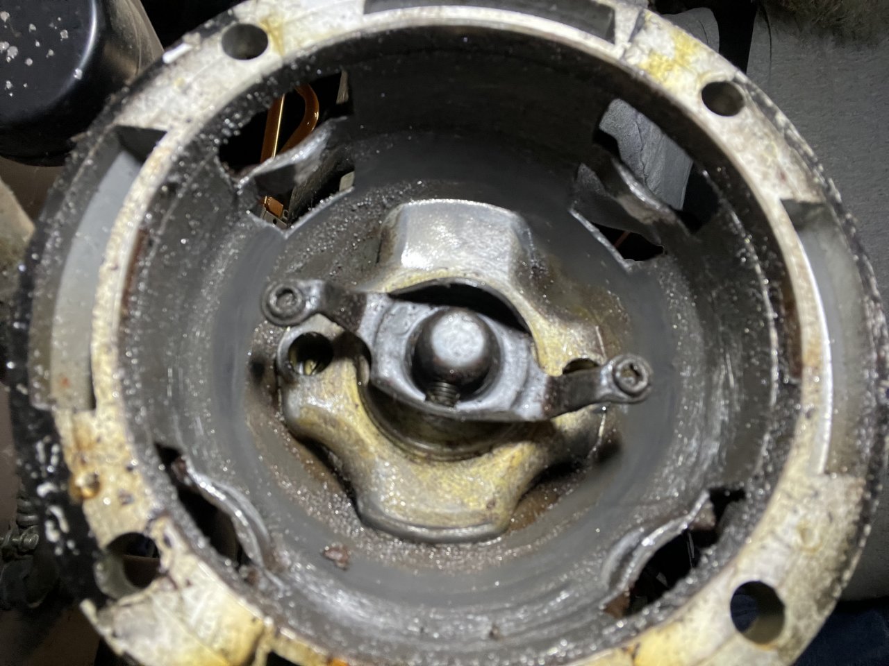

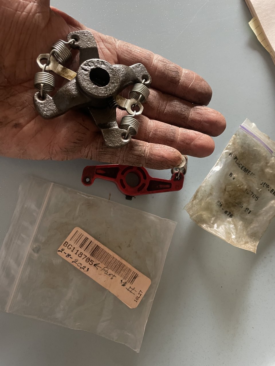

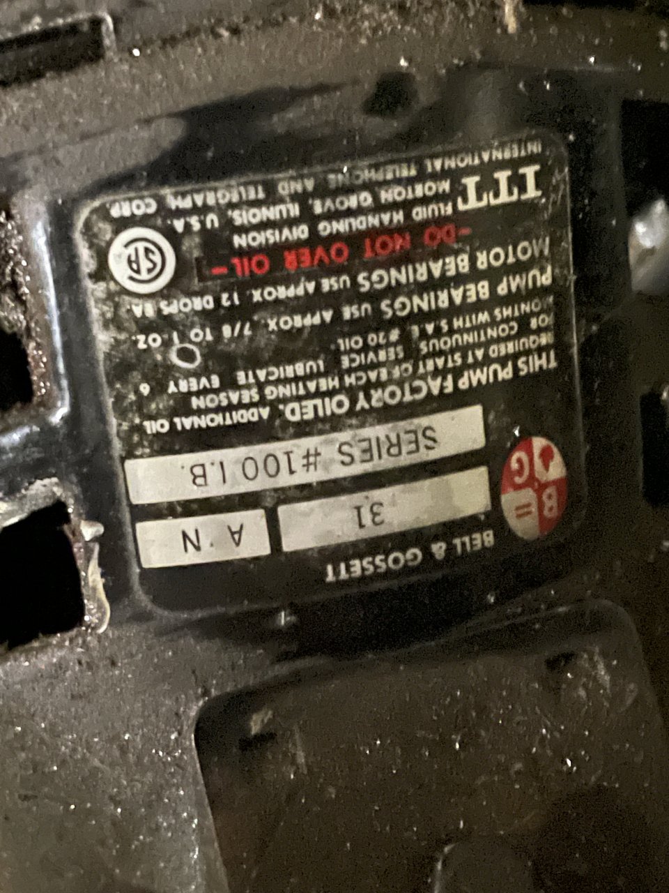

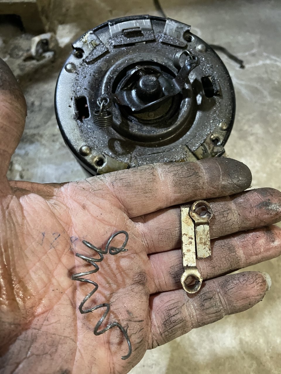

    Well my wife and I went through the ceiling like Sylvester the cat when a strange noise came about in our home last night. Found the noise was coming from the circulation pump on our radiant heating system.
    Being old as Mathusla didn’t figure I would parts for this coupling, but low and behold I found a local shop with one on the shelf…..
    5B44EFB5-1097-4D21-8332-F03A82EF2562.jpeg B4E5963E-3369-4771-B085-A4336ED919B2.jpeg 82D6A1E6-298E-4E21-9D3D-F17622E47963.jpeg 2A9E8FFF-81B0-4490-9873-F3802EF4508D.jpeg F430E927-B8BA-4A86-8086-6FA6C6E34215.jpeg

    you did buy 2 or more and hang the spares near the pump?
    The apartment block I managed in the '80s used small lovejoy couplers and I always had 2 rubbers hanging on a peg 30 inches from the pump as well as one set of drives.
