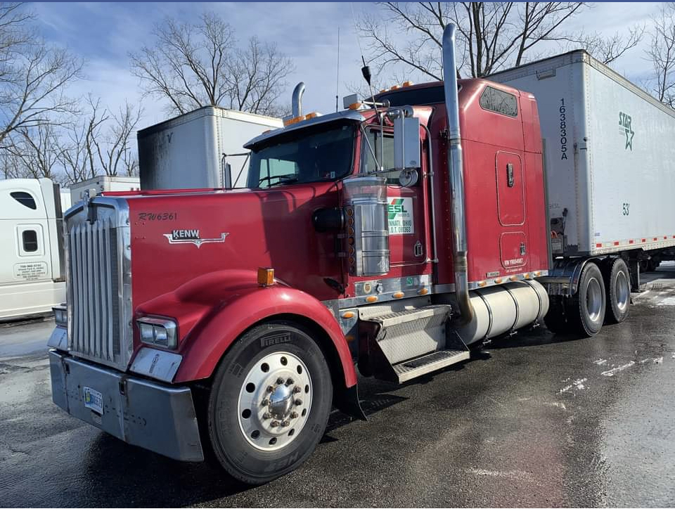

    Not what he probably thinks. Truck market is pretty soft, and getting worse. KW with a cat is pretty available currently. I understand his situation with the name on the door. Once a great outfit.
    So let's break the truck down.
    KW, great. Those cabs leak and rattle over a million. Hope it doesn’t have a sunroof.
    6nz, great engine and very simple. You can learn them. Heavy, but simple. 400k rebuild is good, but that's used and not fresh, but not worn out. No real added value.
    10 speed, doubtful that will work for you.
    Wheelbase isn't long enough for you.
    Fuel tanks most likely have rot under the straps.
    What rear suspension, 200/400. Has it been updated?
    I have found that exact model has a sway after 100k gross.
    Without more pics, and list of actual history, 23,500 would be my limit. The little parts, interior, doors, are expensive repairs after a million miles.
    Again, anyone else may see more. Or less. But business logic says 23.5k. And I think I'm pushing strong for that number.
    Yes, I know I'm cheap.
