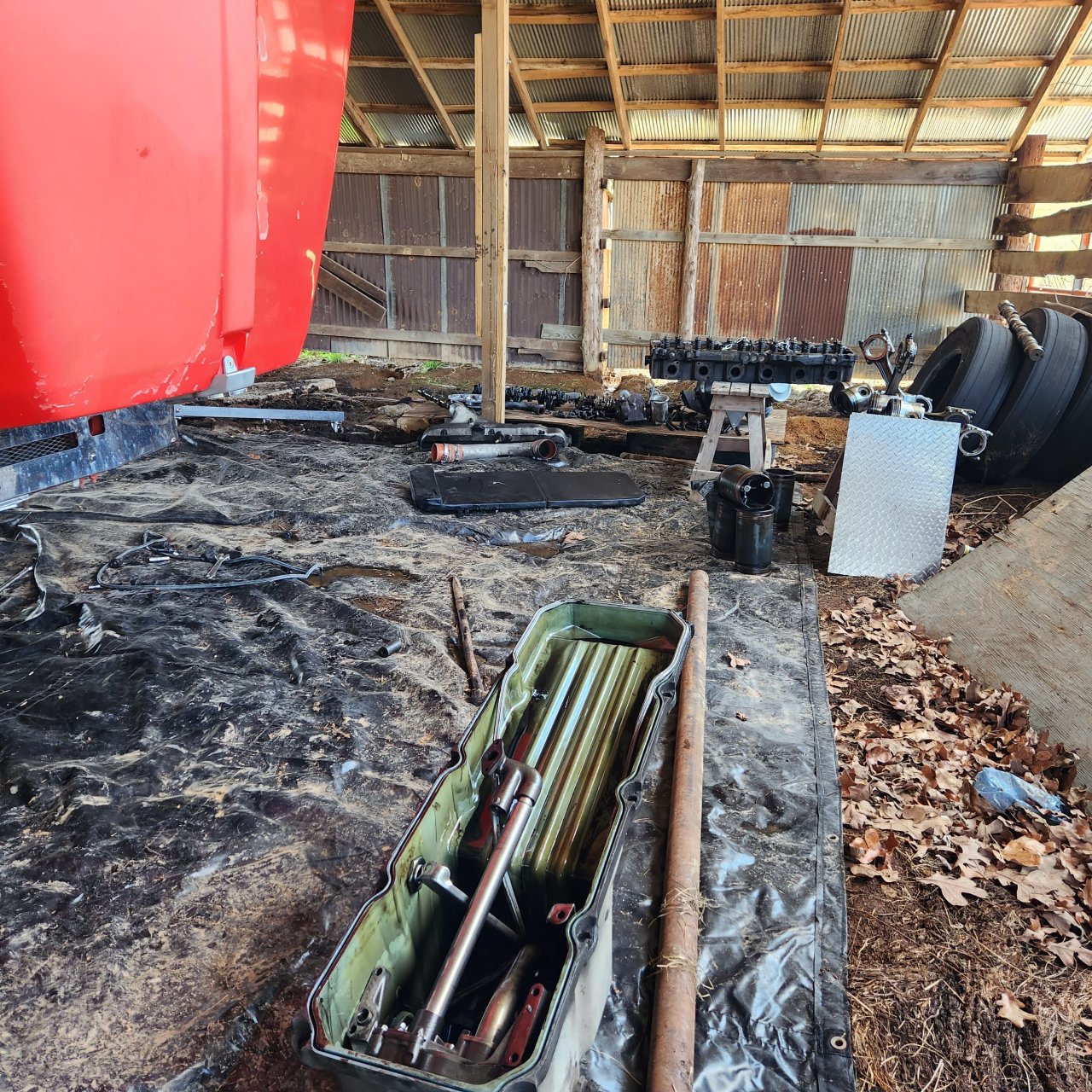

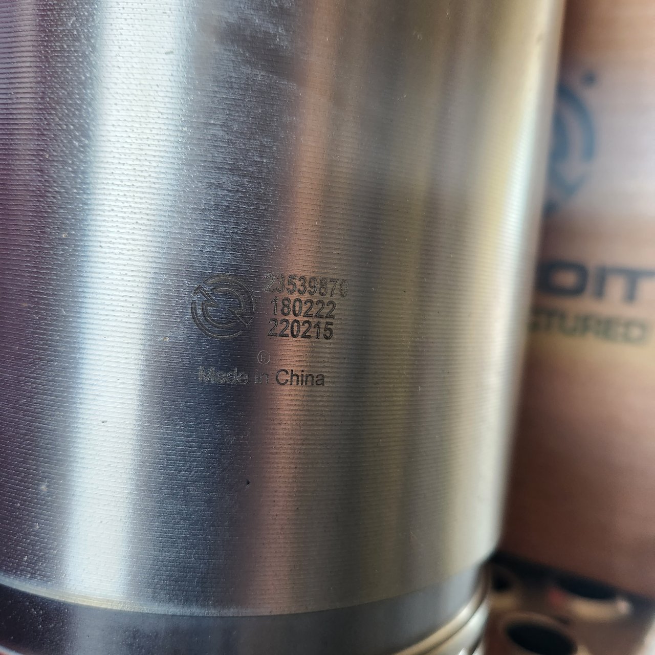

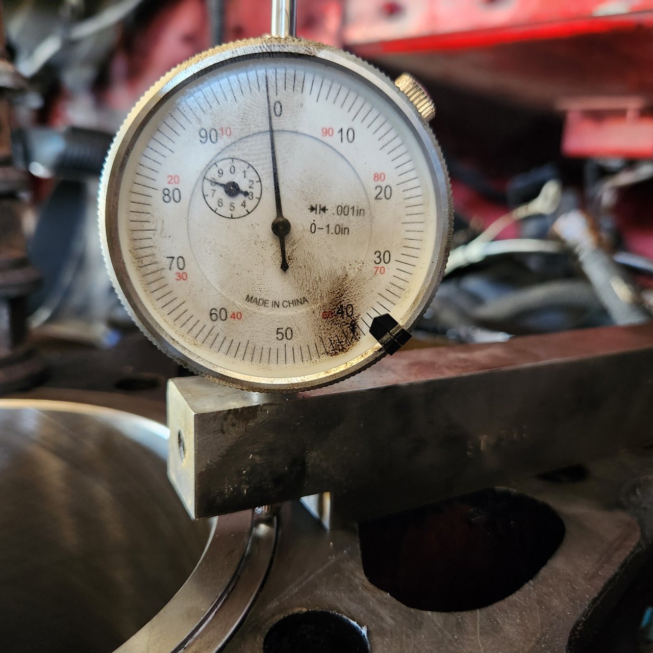

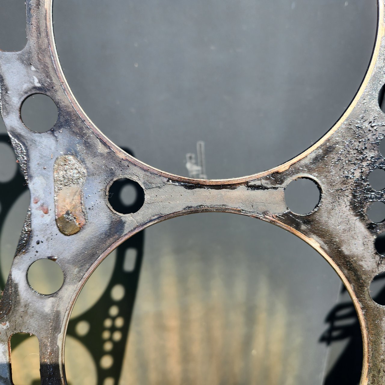

    Tore down except for bearings. If i'm having to get the block cut, I make bearings the last thing to do. I measured liner protrusion with a new liner in #5 hole where the gasket was blown. -.001, so it needs cut. You can see in the pic where the gasket blew out between 5 and 6. And d@mn't gotta love OE Made in China
