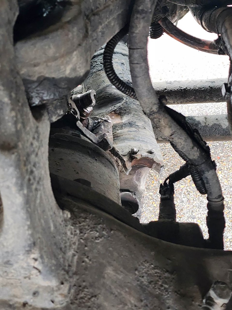

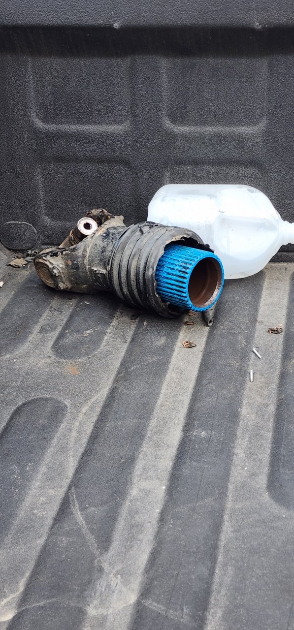

Been a helluva day fighting with the air lines going to the bags on the KW. Thin wall nuts get seized up and deform making it hell to get them off and back on. Seems a bulk head fitting like the steer axle brake lines going to the tops of the bags would have been a better design.
2 bags changed and a new intermediate shaft done to day and 90% of the time spent was on one bag.
Cap looks dry but the rest of the caps all had grease in them and it's been greased. Idk if it was clogged internally but the ears on the yoke snapped off.
KW wanted a cool 1500 for that bad boy and the local drive line shops wanted about the same but were at least a week out. Junk yard search didn't turn anything up as all of those had tiny splined areas as opposed to the 4 inch section on this one.
One shop told me they couldn't reuse it as it was too damaged and wouldn't slide into the new part, and he'd have to order that piece but had the other end on hand. Quick feel of the splines and I didn't feel any burs but he wasn't budging so I said thanks anyway I'll just take the one I've got ordered from the dealer.Last edited: Mar 26, 2023
