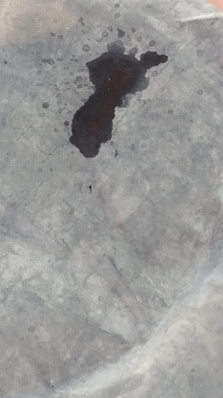

    Heres a better picture. Showing the backside of main hose closest to the valve cover for reference.

    Can say ive never been so happy to see coolant dripping underneath the truck .jesus man lol what a relief . 0614231610.jpg

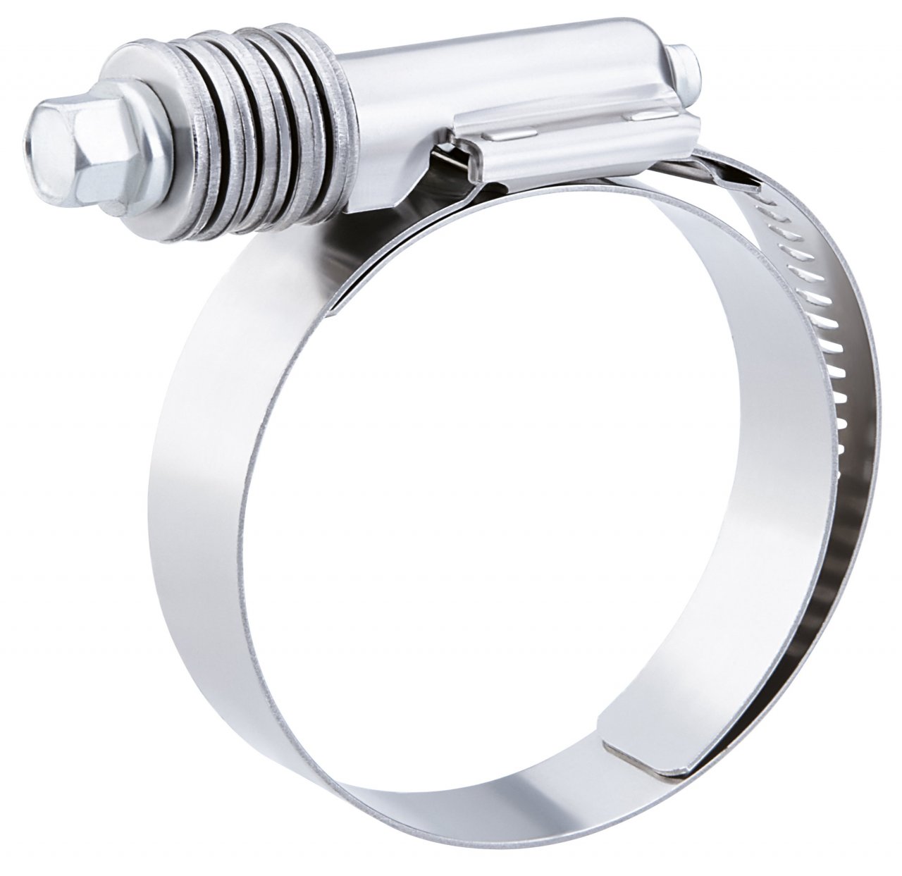

  6. jamespmack
    Well they make 100 different types. They have worm type with a liner, shield, sorry for not the best description. I would get constant torque clamps. Let me go find a picture.

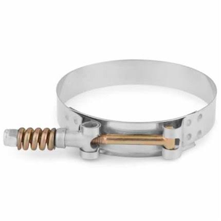

  7. jamespmack
    Sorry, I don't have more technical explanation. Top is still worm gear. But you see how hose would be protected from clamp? Pretty much anything similar will work. Doesn't matter on rubber as much.
