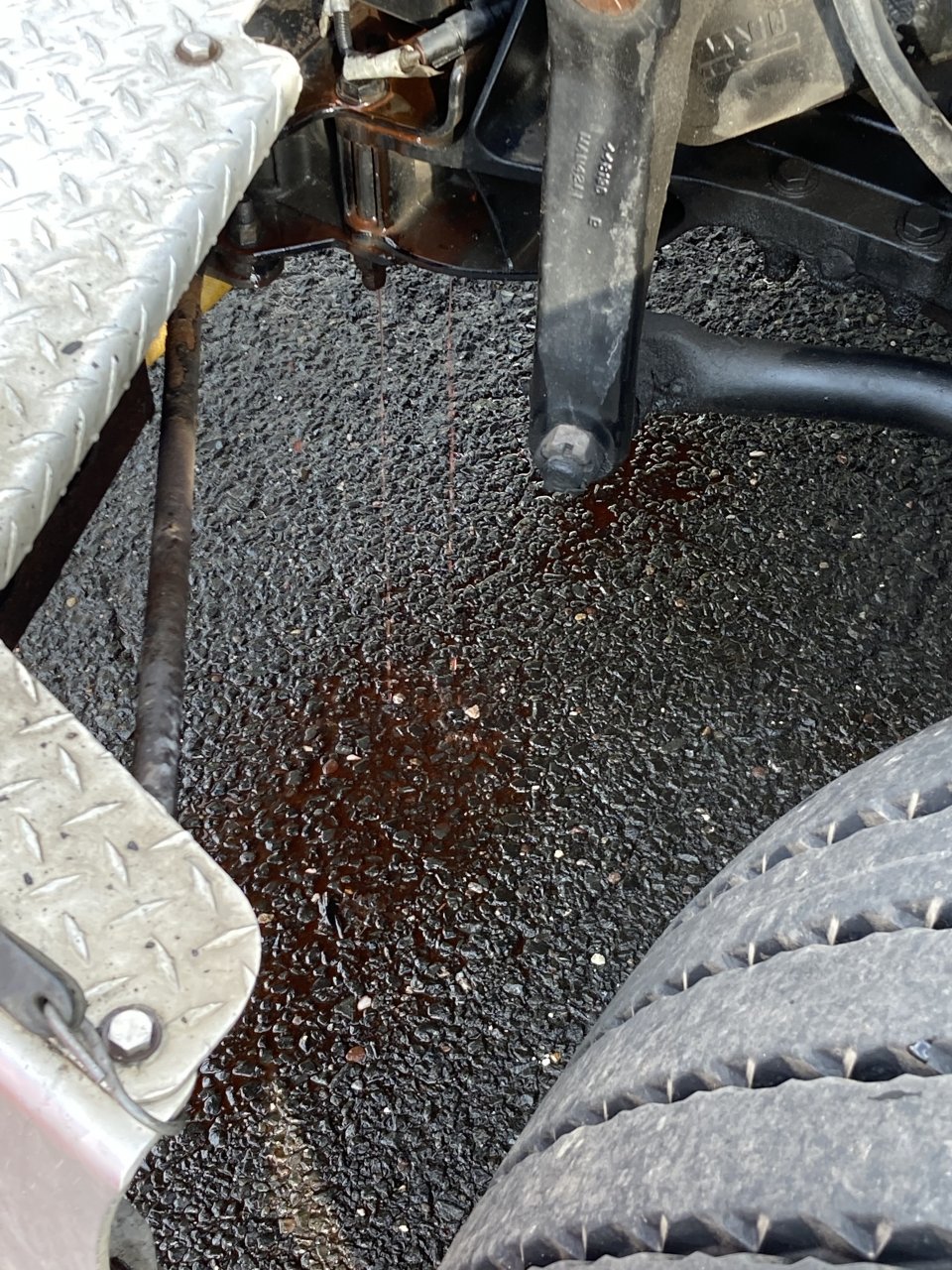

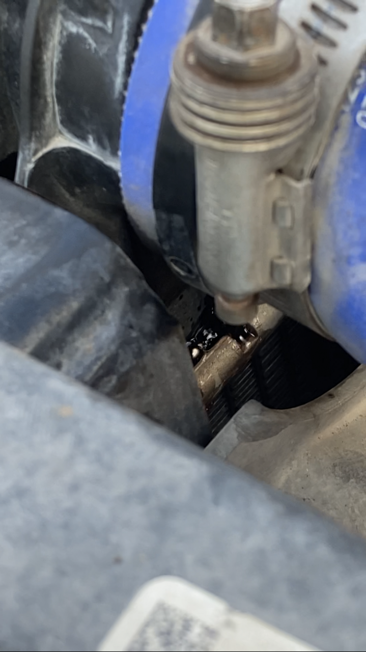

    chasing more coolant leaks... had to put the pressure tester back on it. luckily i brought it with me.. turns out it leaking from the hose on radiator neck.. evaporating off im guessing because no leak when engine running, but pours right out when pressure tested. tightened the clamp and stopped the leak but think it still leaking when under load.. because still using alot of coolant... like playing whack a mole.. except theres no high score only more problems... i guess i will go find a peterbilt tomorrow after i deliver and get parts and fix the #### in their parking lot. i surely hope it is not the plastic neck that is cracked. i remember the cascadias being notorious for breaking on the neck and have to replace the entire frickin radiator... also a/c went out today.. seems like it has freon in it. but was fluctuating all day.. cold then hot. little cold. then just stopped working all together...bought a can and tried to add some but i think the can i bought is not working correctly.. its one of those with the quick connect already on it but it will not fill any into the system.. god dam truck is going to be the death of me

    Mine broke at the little nipple for the short line to the expansion tank. The big inlet/outlet connections should have a metal sleeve inside to keep the plastic from crushing/cracking.

    i have saw that one too. i had that nipple break a couple years ago after i hit a monster pothole.. well atleast if there is any positive news , it doesnt seem to be leaking there... i hope a new rad hose and clamps fixes it. i think it should. the other leak on the thermostat sealed up and then this one popped up using about half the amount of coolant it was before i replaced the thermostat leak.. shoulda just replaced both of them when i was at the house and had the coolant drained... but i am not that smart apparently
