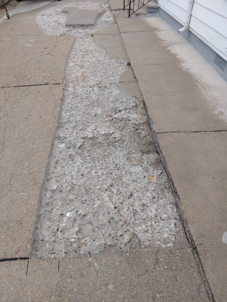

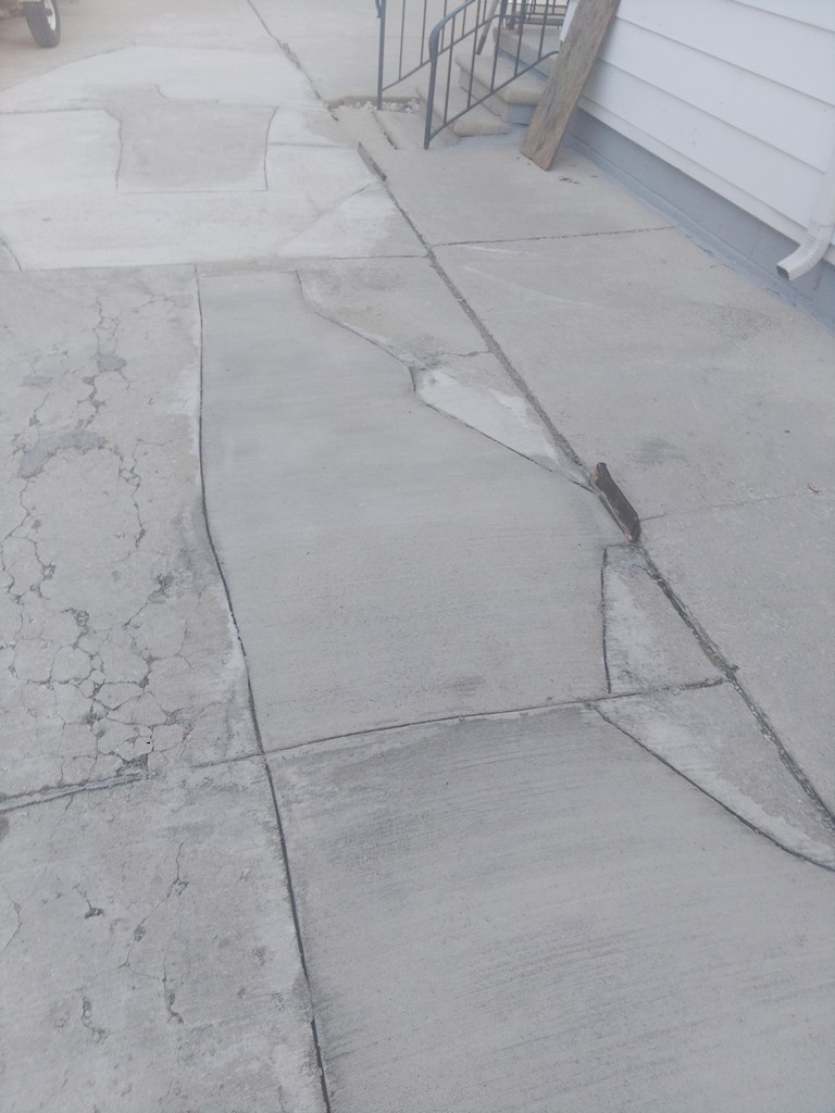

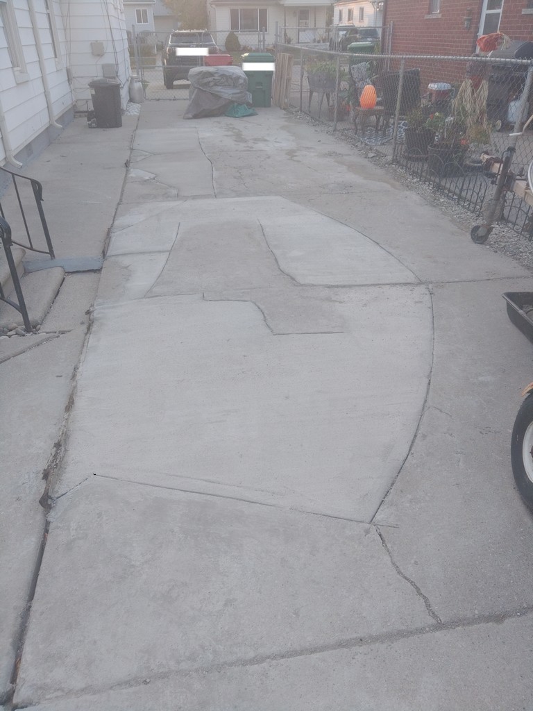

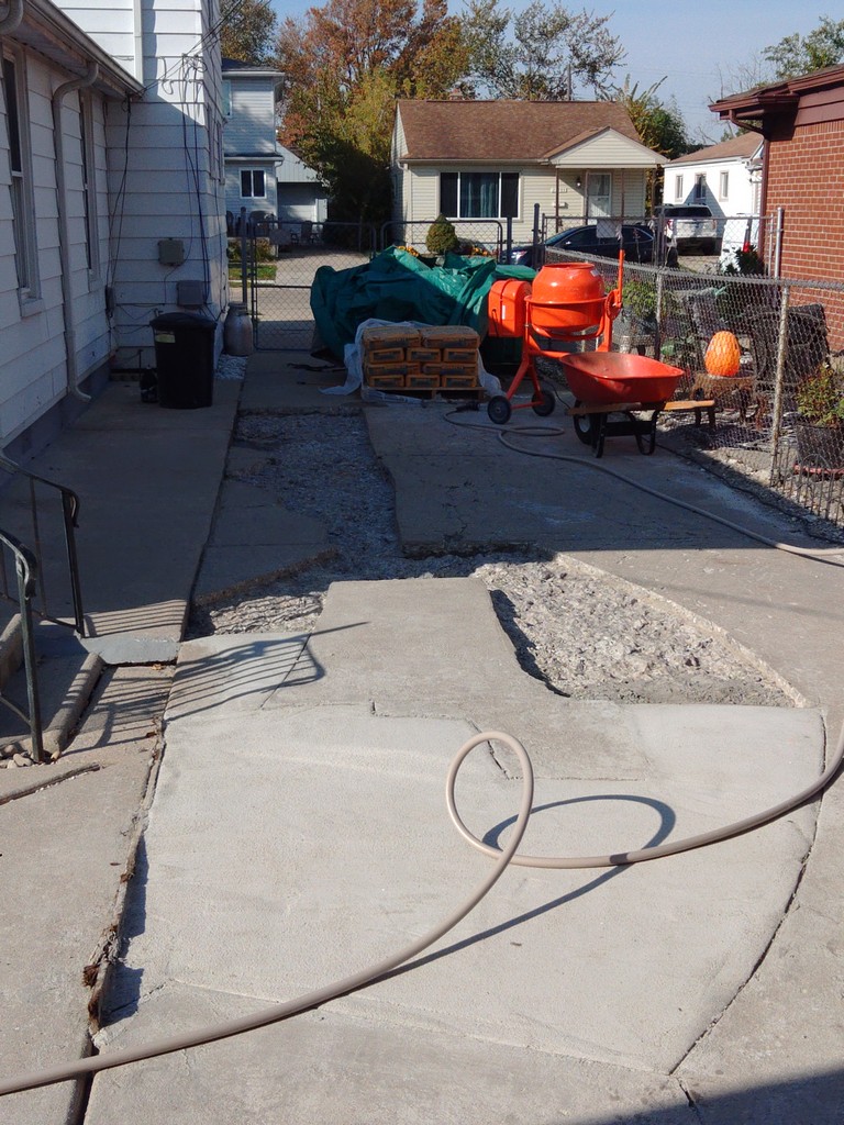

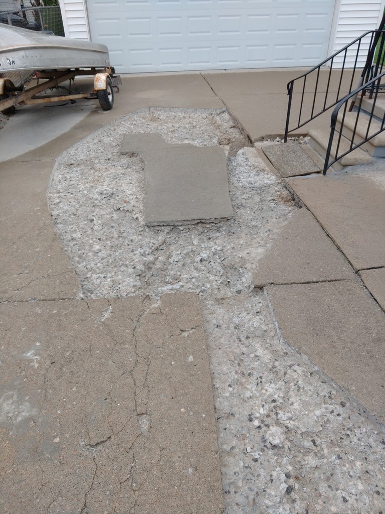

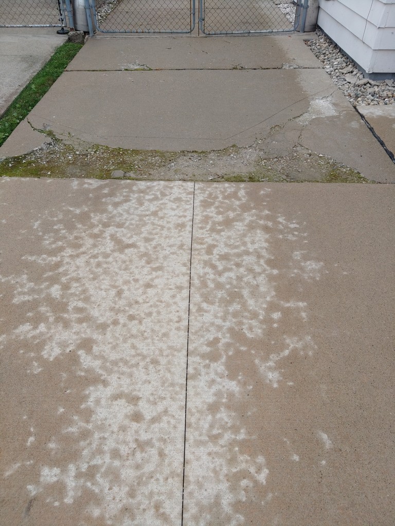

    Quick update, I just finished with the back yard cement Thursday and have been recovering since. :)
    Started with this after taking out the loose and unstable concrete from the cut areas, these were taken 10/5:
    The first one needs to be taken out yet, that's the next to be done, but the 2nd and 3rd pics was painstaking, since I had to slowly take out only the bad stuff, and more would go bad..etc. Ordered 2 pallets of 80 lb bags of concrete the day before my birthday, had it delivered on the 12th and tarped it all up because we were getting rain. On the17th, bought a Harbor Freight 3.5 cu.ft. Cement Mixer, but had to take it back because it was damaged, and then got a replacement one from another store and had to assemble it.
    Edit: Almost forgot, after the first pour the cement mixer stopped working and had to find a replacement keyway key after disassembling the drum and gear, and replacing the key and then Loctite-ing the screw in the gears.

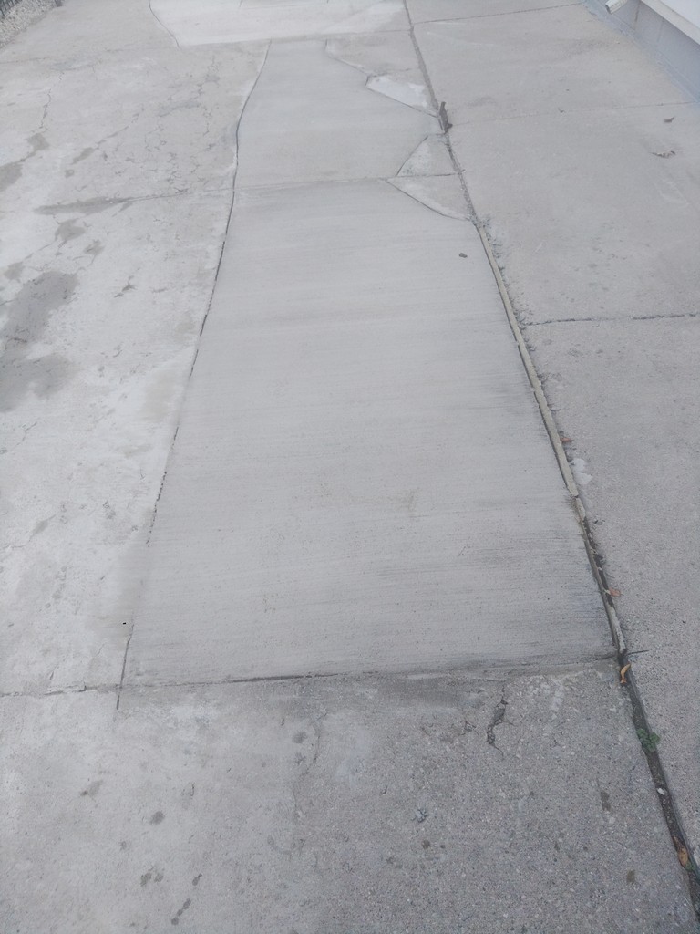

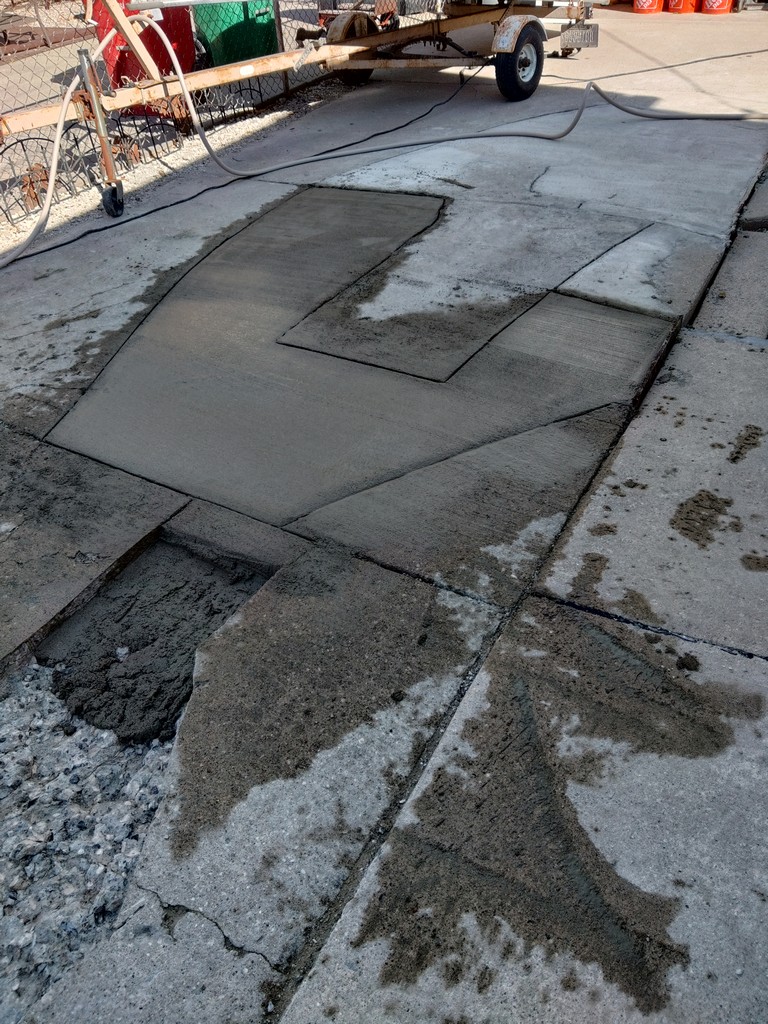

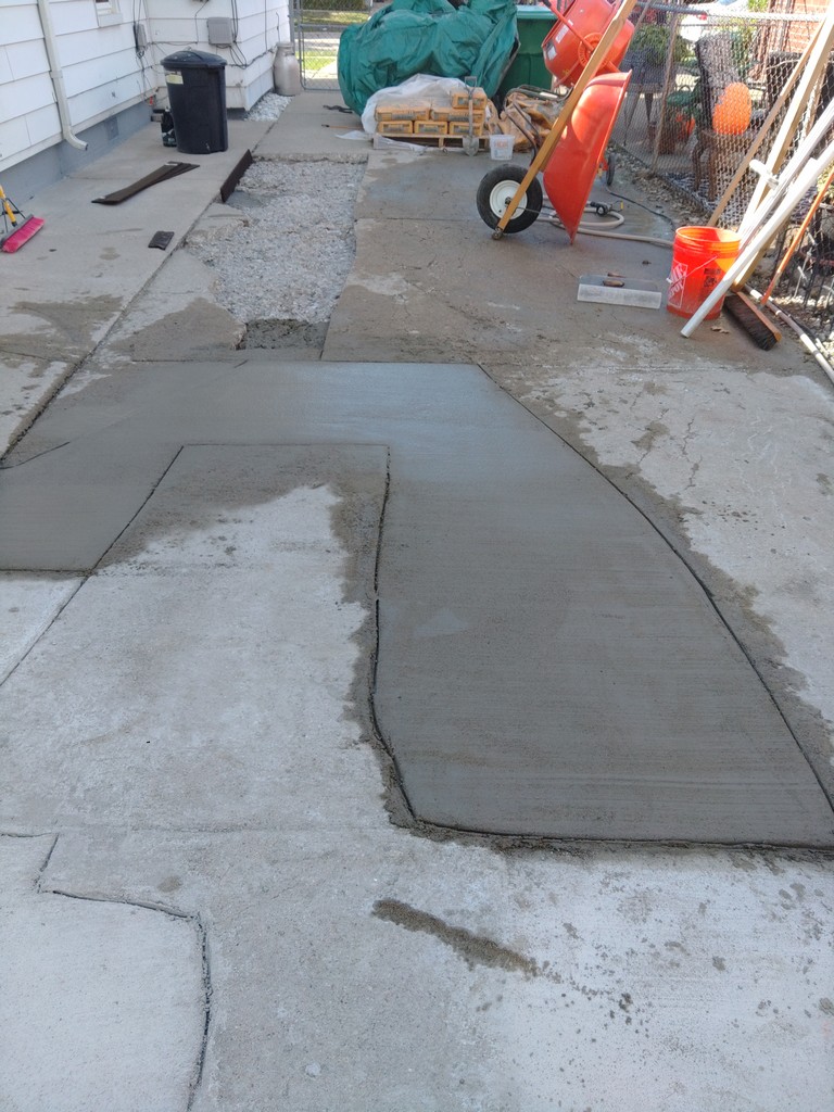

    Did first section pour on 10/21 and it took 18 bags and took about 6 hours:
    then was down for 3 more days of rain, and then did this next section on 10/24 and it took 13 bags:

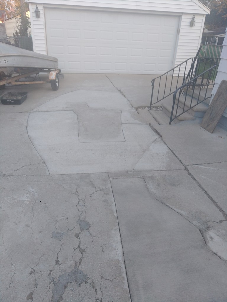

    This one kicked my butt as it was really hot and muggy, but I wanted to get more done so ended up working straight through for 4 hours and ended up dehydrating and sending the BP and pulse up and took several hours to get everything back down...so took it easy the next few days as we had more rain again. Then had to reapply more bonding adhesive since it washed off again, and then did this next section which took 20 bags and about 8 hours (but in cooler weather) with a break every couple hours to get done. :)
    CementWork00007.jpg CementWork00008.jpg CementWork00009.jpg CementWork00010.jpg
    These sections were important to get done because they were in varying depths, with a minimum of 2" as required for the cement to bond well, up to 6" depth where the section was really bad and the total for the back area was 51 bags of concrete.
