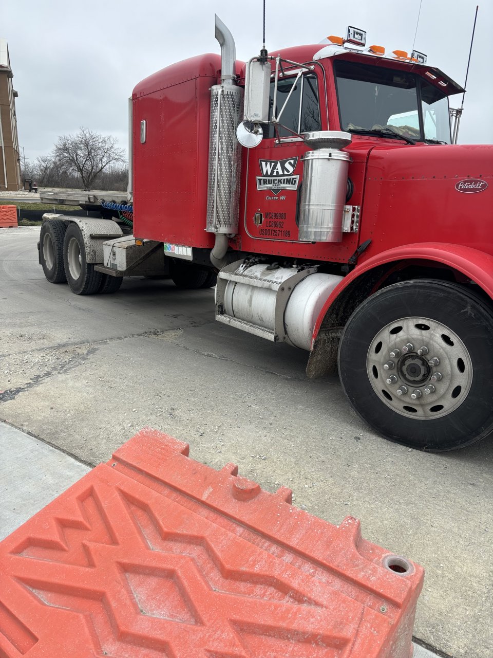

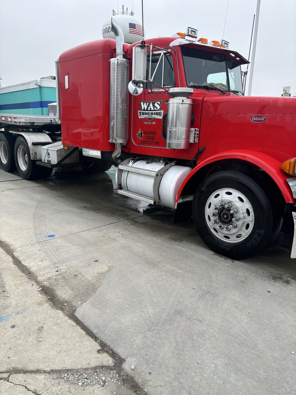

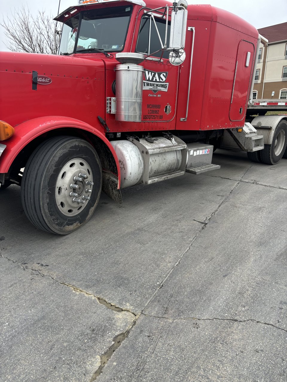

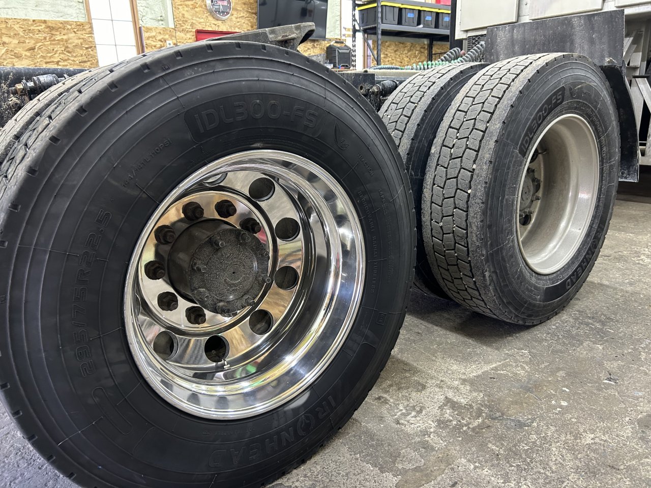

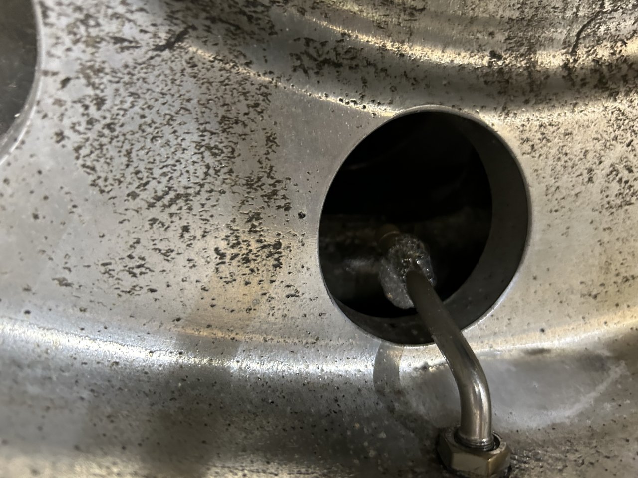

  11. cke
    cke Road Train Member
    6,243
    76,847
    Aug 4, 2013
    Colfax Wi
    IMG_8438.jpeg IMG_8439.jpeg IMG_8442.jpeg IMG_8443.jpeg Before and after. Not perfect but 300% better. Hopefully brine and salt season is over.
