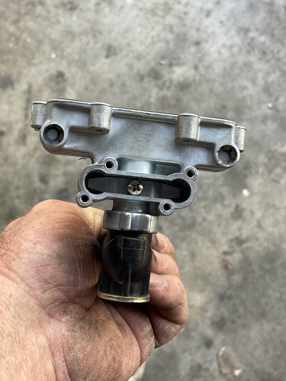

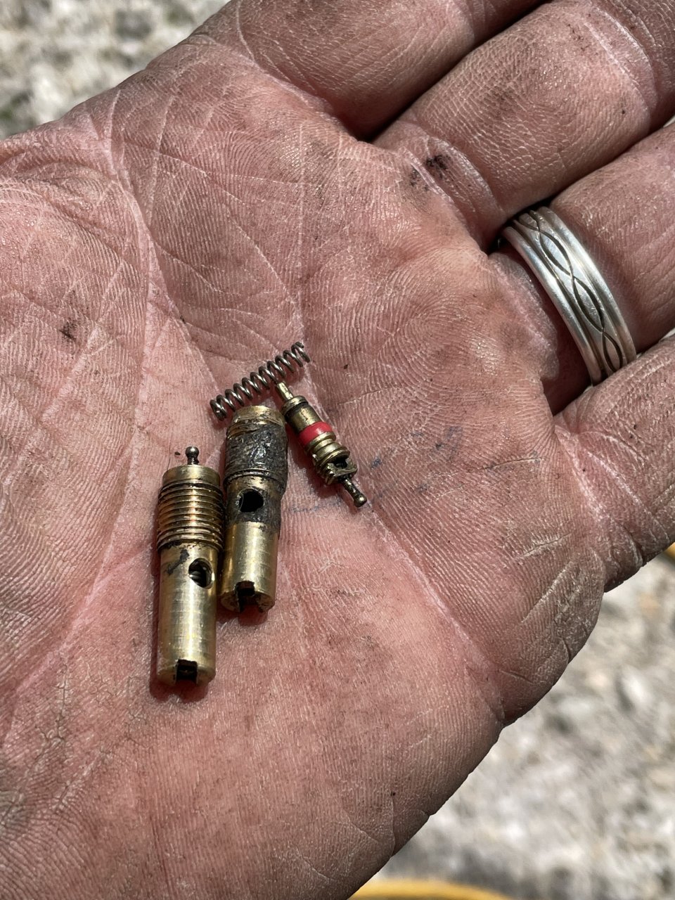

    Bought a new leveling valve for the tractor yesterday, put it on and it failed to inflate the bags. Removed the line feeding the bags and not one ounce of air no matter where the arm was.
    Got another valve this morning and installed it, same exact problem!!!
    After double checking and doing a process of elimination I found the Schrader valves in the new leveling valve need more force to open than the old valve.
    I swapped the return springs from the old valve into the new valve and it works fine now, no issues at all. Bags are inflated just as they should be….
